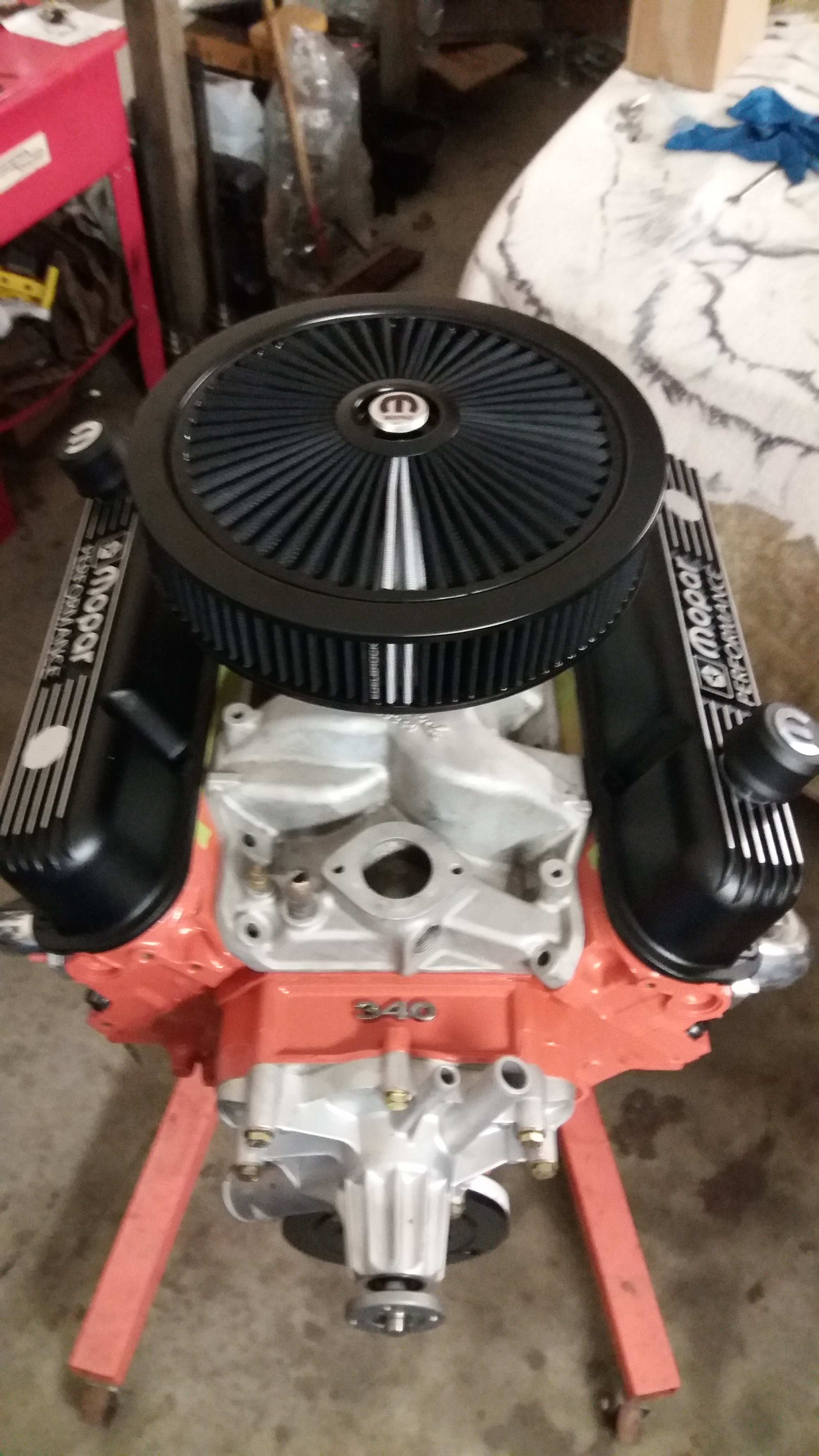

Get a filter with a top plate. Edelbrock has them and it should be enough for the big block. It's amazing how much air they can gulp. I had a foam triangle type once, and that motor sucked the whole thing right thru it. Gone!

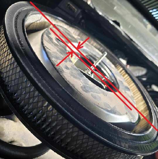

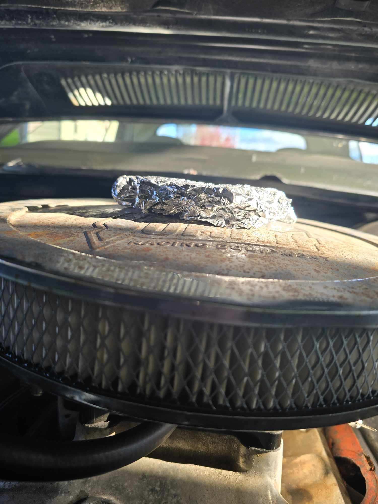

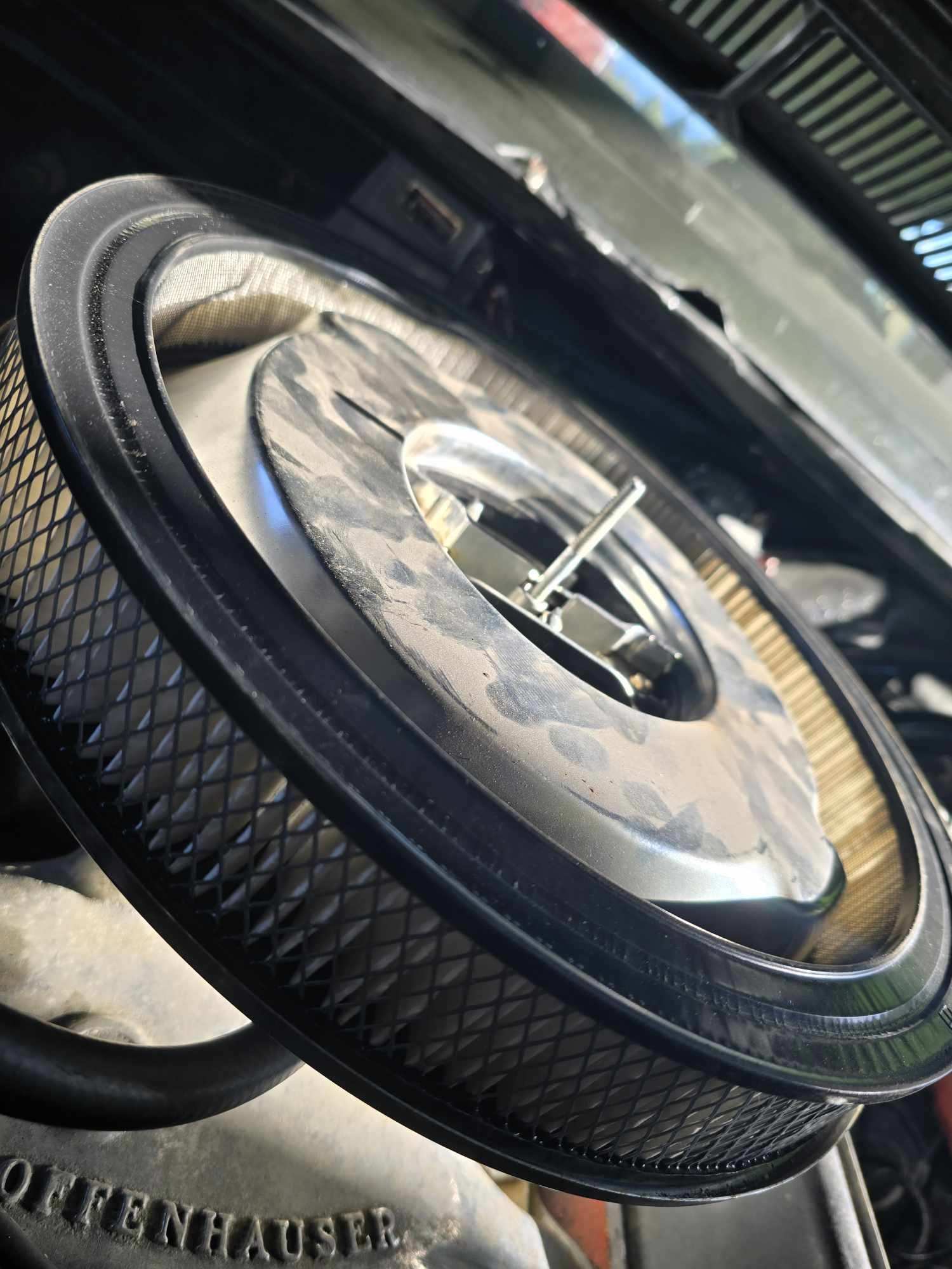

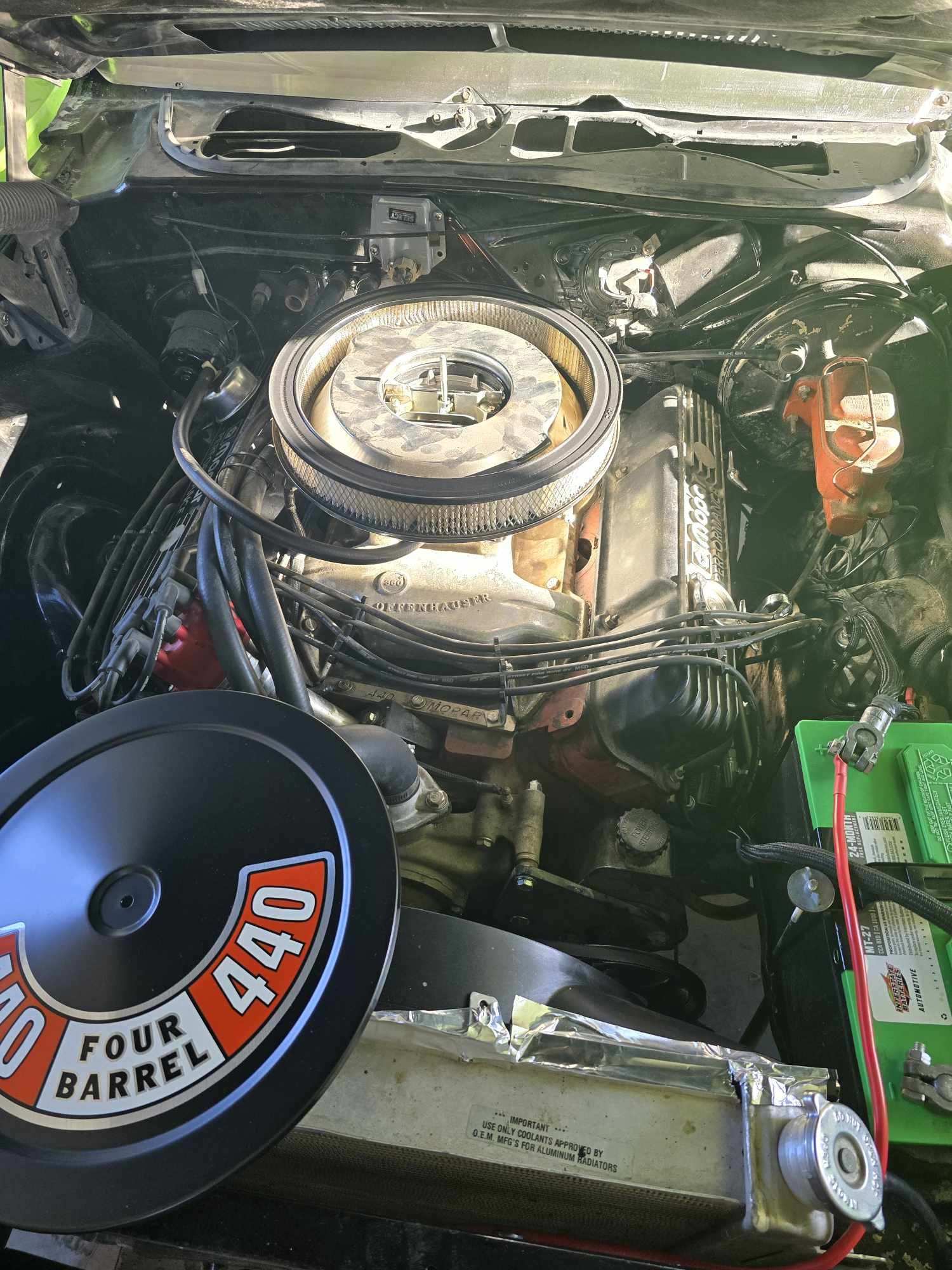

I think I'll wind up having to go with the filter top. Went and filled it up with premium and put fuel stabilizer in it for winterization and pulled the air cleaner off for the drive home. Noticeably more power, though still flat through 2nd gear (which reinforces my other thread about wanting to do heads and a cam as a winter project).
That drop filter base and the lid are REALLY close together when it's on! Dummy me, should have noticed it months ago when I put the 2" in. :rolleyes: 😂 The foil ball shows how much space there is when the hood is closed. Not sure a filter top will work out with that little space but it's worth a try.
That old Offenhauser intake is coming off soon, already picked up a Holley Street Dominator to replace it with. If my measurements are right, it won't hurt my hood clearance. It looks good all polished up but I don't know that it flows all that great.
