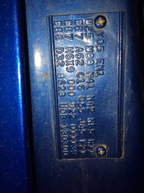

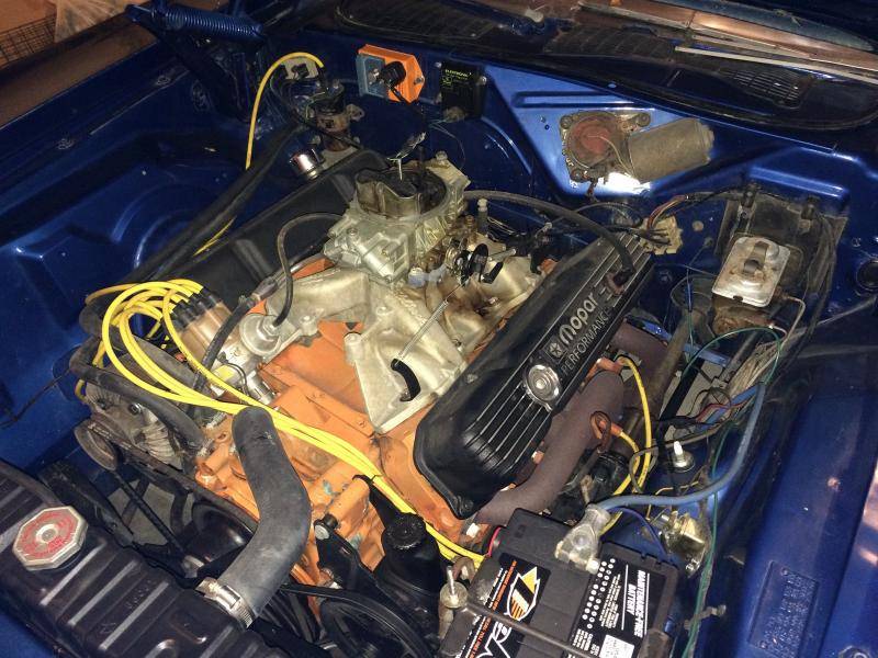

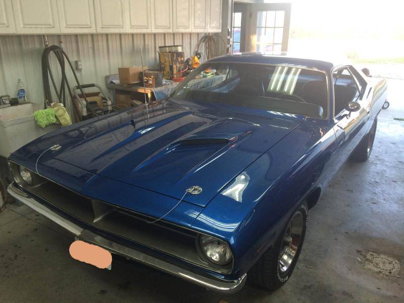

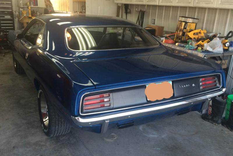

This is all I have. To give you reference they are looking to get $32K. Is there much value in a 440 car but not original engine? How much do fender codes add in value outside of Hemi's, 6 pack, or like high impact colors?

Yeah I would say, based on what I CAN see, 22-30k, obviously a real inspection would dictate where
It keeps getting better but a lot still depends on the interior and what lurks under the paint but I'm not seeing 32K.
never 32k
wrong color
headers gotta go
how hi is that intake.
is that a chevy alternator bracket.
what else is wrong.
Color still rocks in my opinion. I see a lot fewer of these than purple and lime green...

What fender options really matter outside of "BS" and "Hemi"? I'd love to spend only $20K, but I'm having a hard time finding anything good. I'm only looking for a '70. Personally I really wouldn't care if it is numbers matching or not because I would like to make it more of a pro-touring cuda. Probably put a 340, 440, or 426 in it.

Okay, I'll go. Their isn't a lot of pictures,but here's my input for what it's worth. IFit has a solid body than the asking price isn't far off. You obviously are not buying to re-sell. I think 28-30. Look at positives from what I can see "U" code car B-7 Nice color. That car in #1 condition would be what 55k-60K car. Most importantly do you like it? Get more pictures and info from seller.
