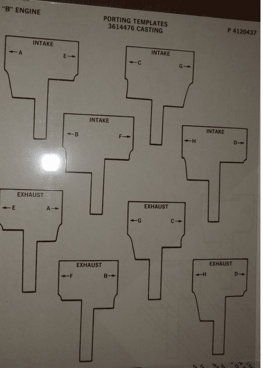

Back in the day (mid 80s to early '90s) Direct - connection sold a clear plastic porting template for about $15 that you could cut out and stick into the valve-stem hole at every 15 or 22.5 degrees and grind straight down from the bottom margin of the valve seat to blend the bowl. you just grind with stones and porting cones on a drill or Dremel tool.
I spent a god 40 hours, if not more, getting mine ported and polished to match the template. Most porters also recommend grinding down the underside of the valve itself to take off any excess margin under the last angle of the valve job to the beginning of the transition from seat to stem.
The template was developed and flow-tested by Ma Mopar engineers or partners to get the max flow out of the 906 and DC Stage 4 and maybe stage 5 heads if I recall correctly. Should work on the 915 heads, but not sure. -I think I ran across them a week or so ago sorting out all my ancient stuff. PM me if you want me to provide further detail.
FYI-I bought a set of hogged out 915 heads before I got the 906s and templates and it ran way worse than stock so don't gasket match and call it good. My 2c
Just for reference on the template cutouts.............
