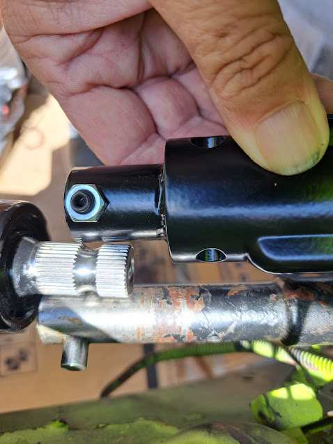

Moparlifer..... what did you do? I bought that adapter from Borgeson and it doesn't work. I called him and he said to hammer in the column... Doesn't sound good to me. How about one of those universals???
Any help would be greatly appreciated. Bill

I have not hooked it up yet. working on metal work lately. I did notice another thread today from Lee. W posted around 2:30 yesterday that a few guys have had to cut 1/2" off the shaft to get it to work.
