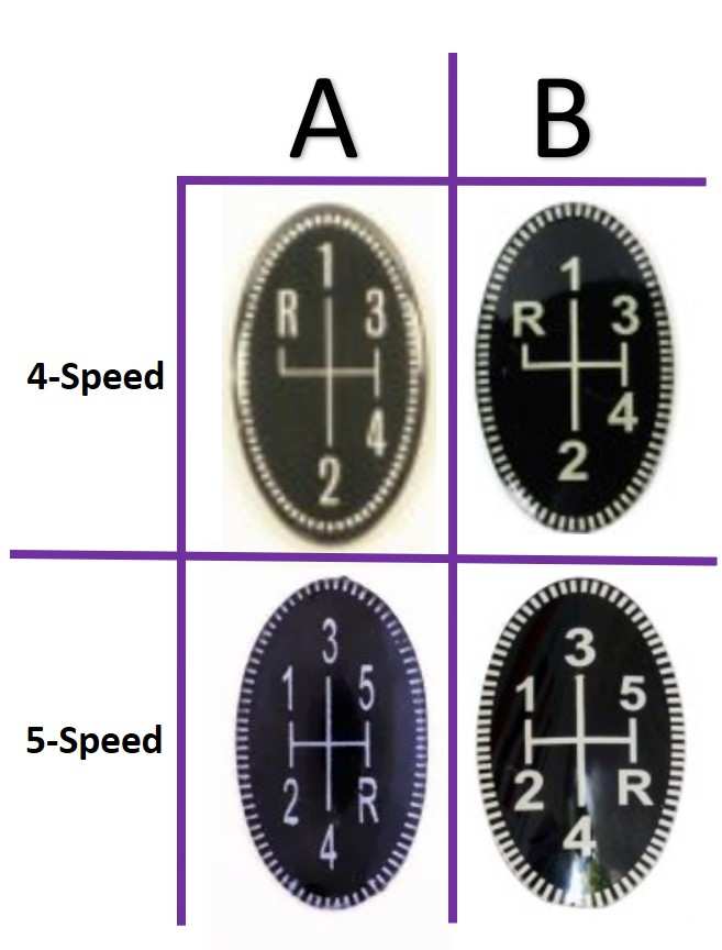

Can anyone shed some light on the differences in the fonts for the available reproduction shift pattern insert lenses for the HURST Pistol Grip Shifter?
I have seen two different fonts for the 4-Speed pattern as well as two different fonts for the 5-Speed pattern.
Which font is true to the factory shift pattern insert lenses' font? A or B?
EDIT
Conclusion: Style A is original for 4-Speed and Style A is also most correct for the modernized 5-Speed pattern insert lense.

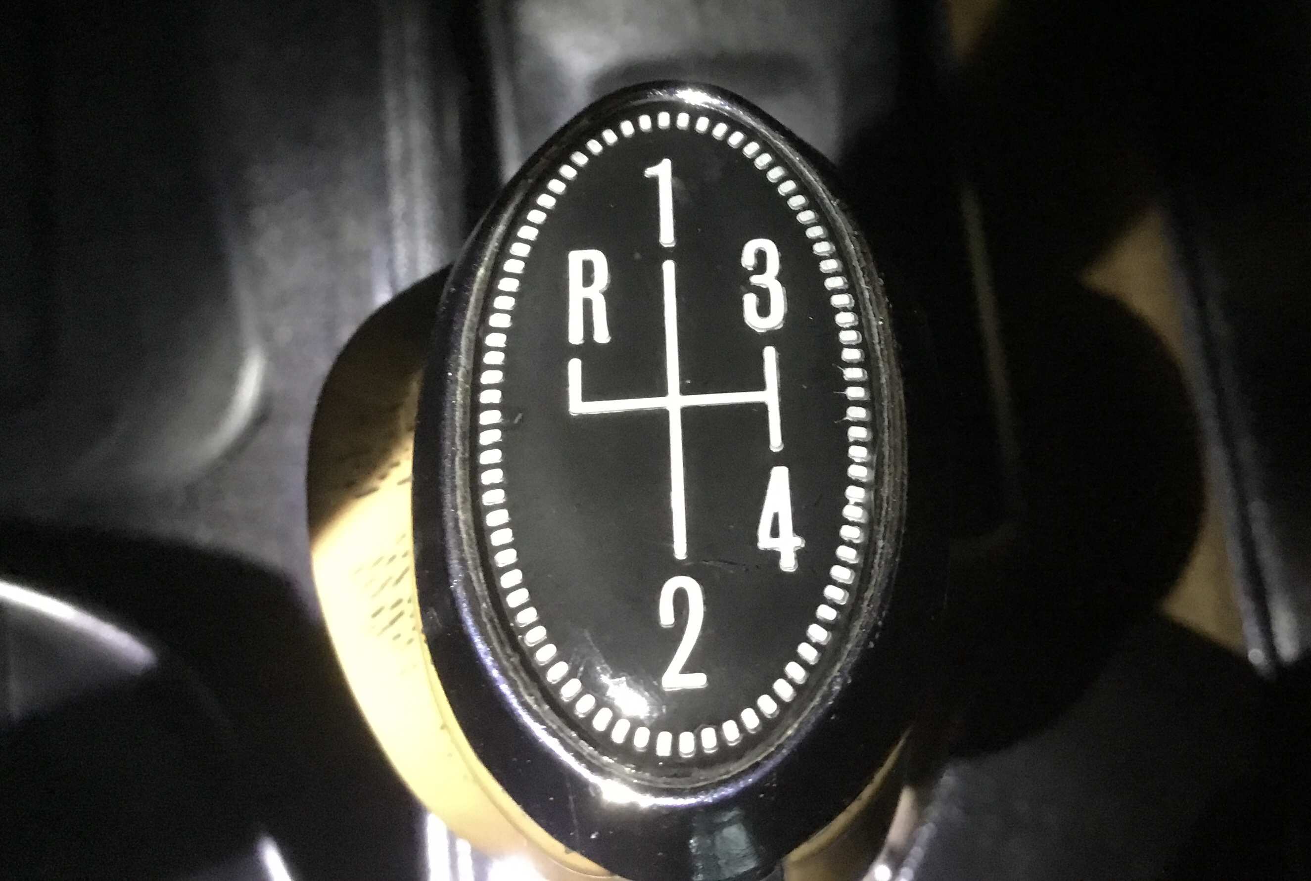

My car has the original shift lever in it. I guess it is very likely to be the original one. The shifter handle is the 1970 version with the push in shift lever as opposed to the later bolt on one.
I checked the car this morning and my bezel font is definitely the A version with the 1 and 2 numbers running up to the top and bottom.
The differences may be different manufacturers or the style of font changed over the years as the design of the shift lever changed?
