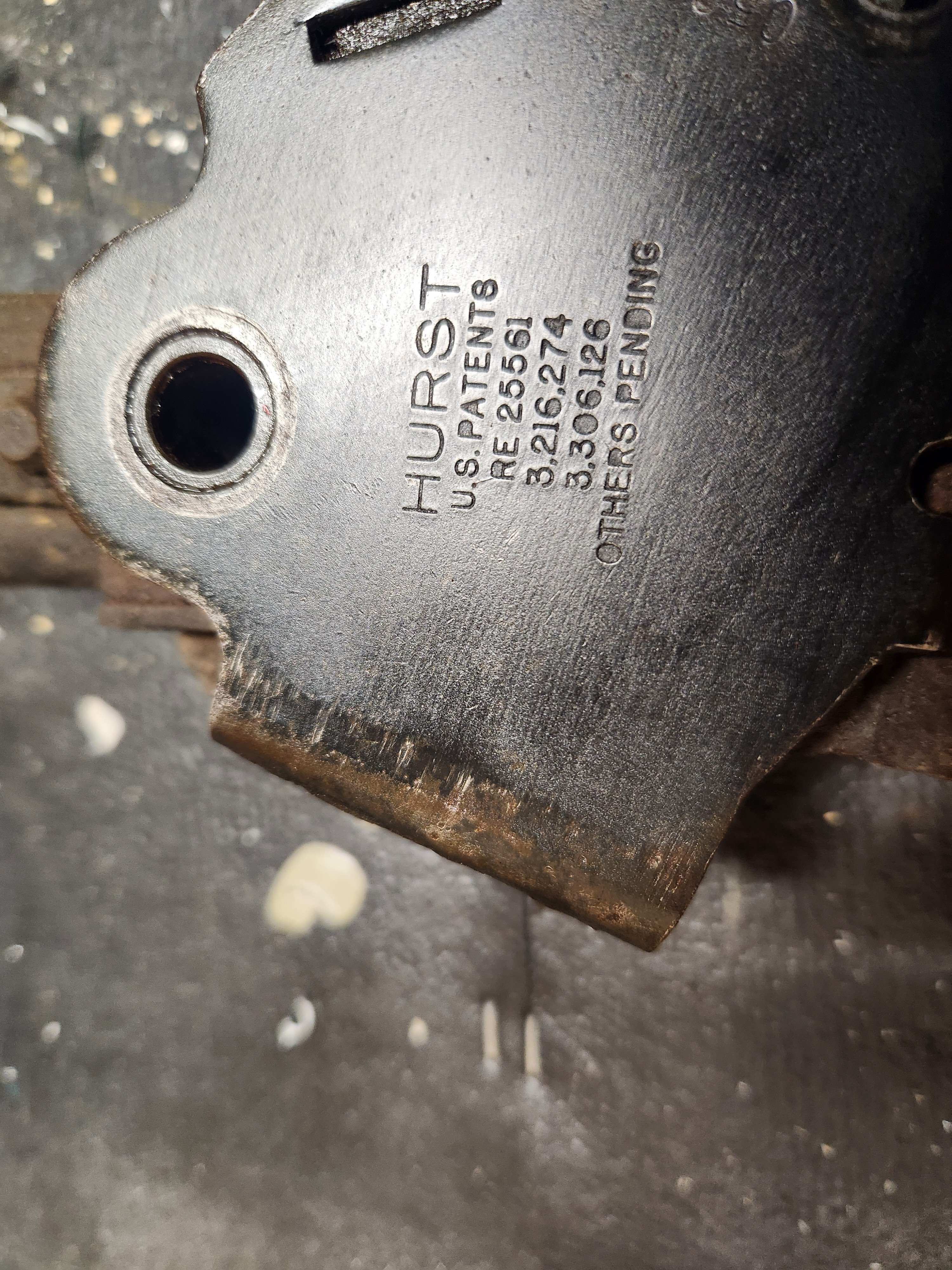

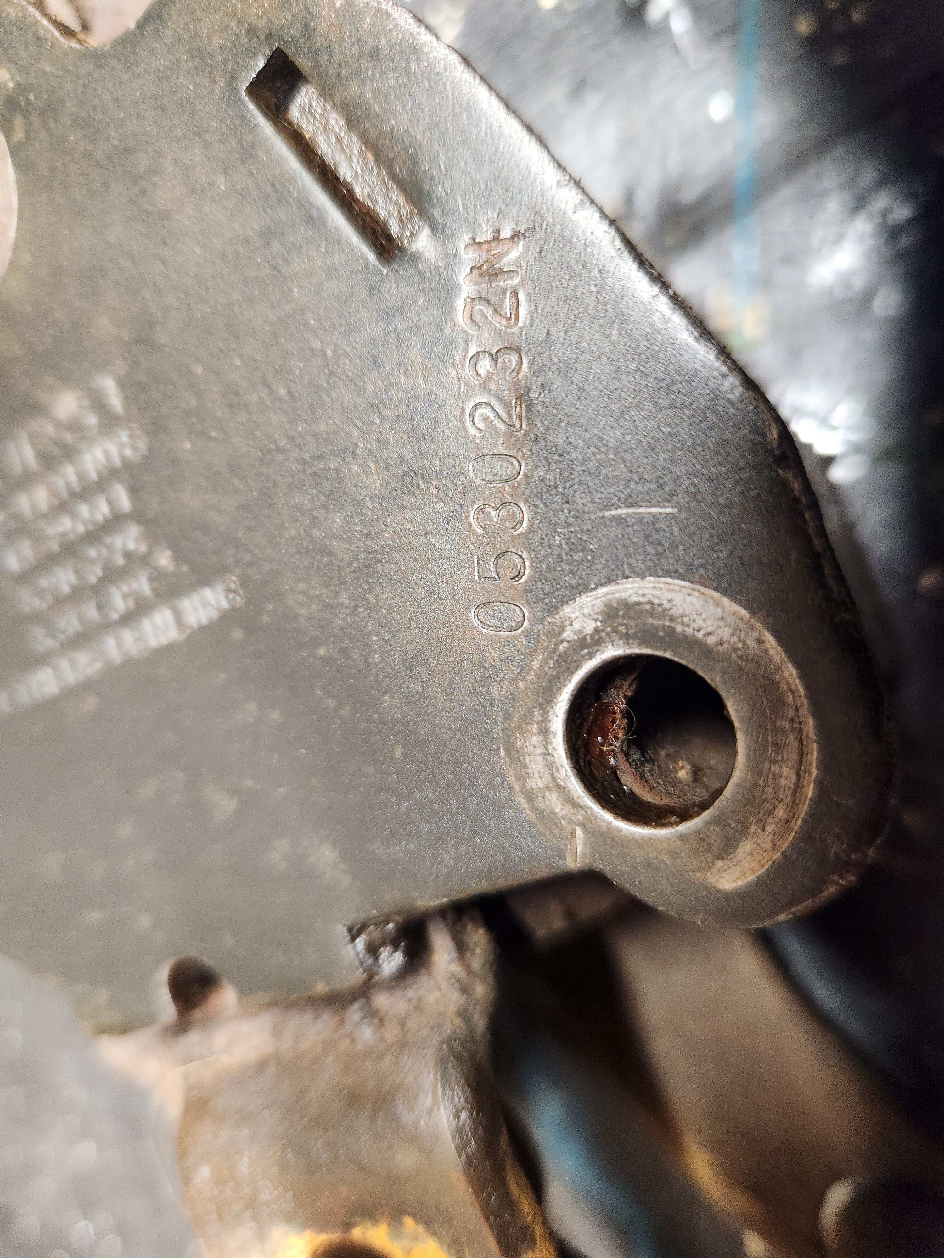

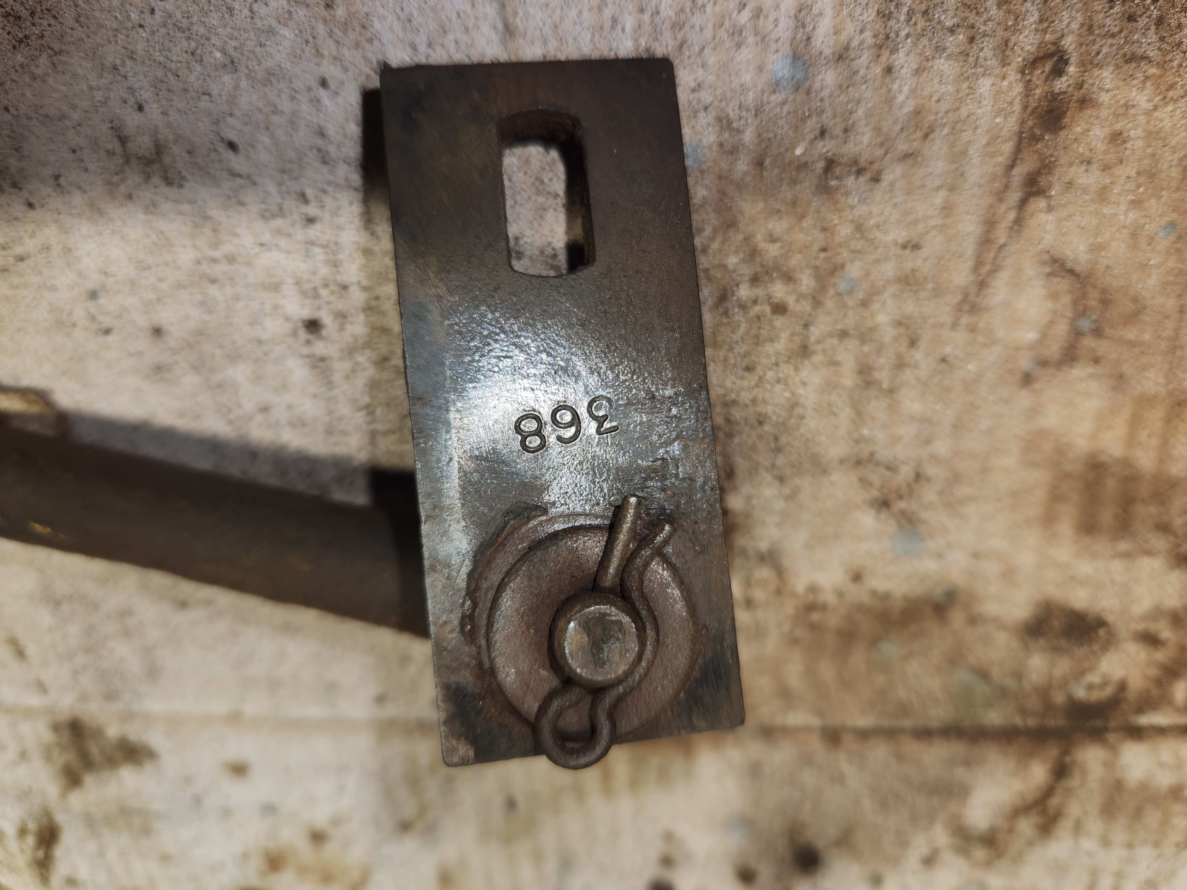

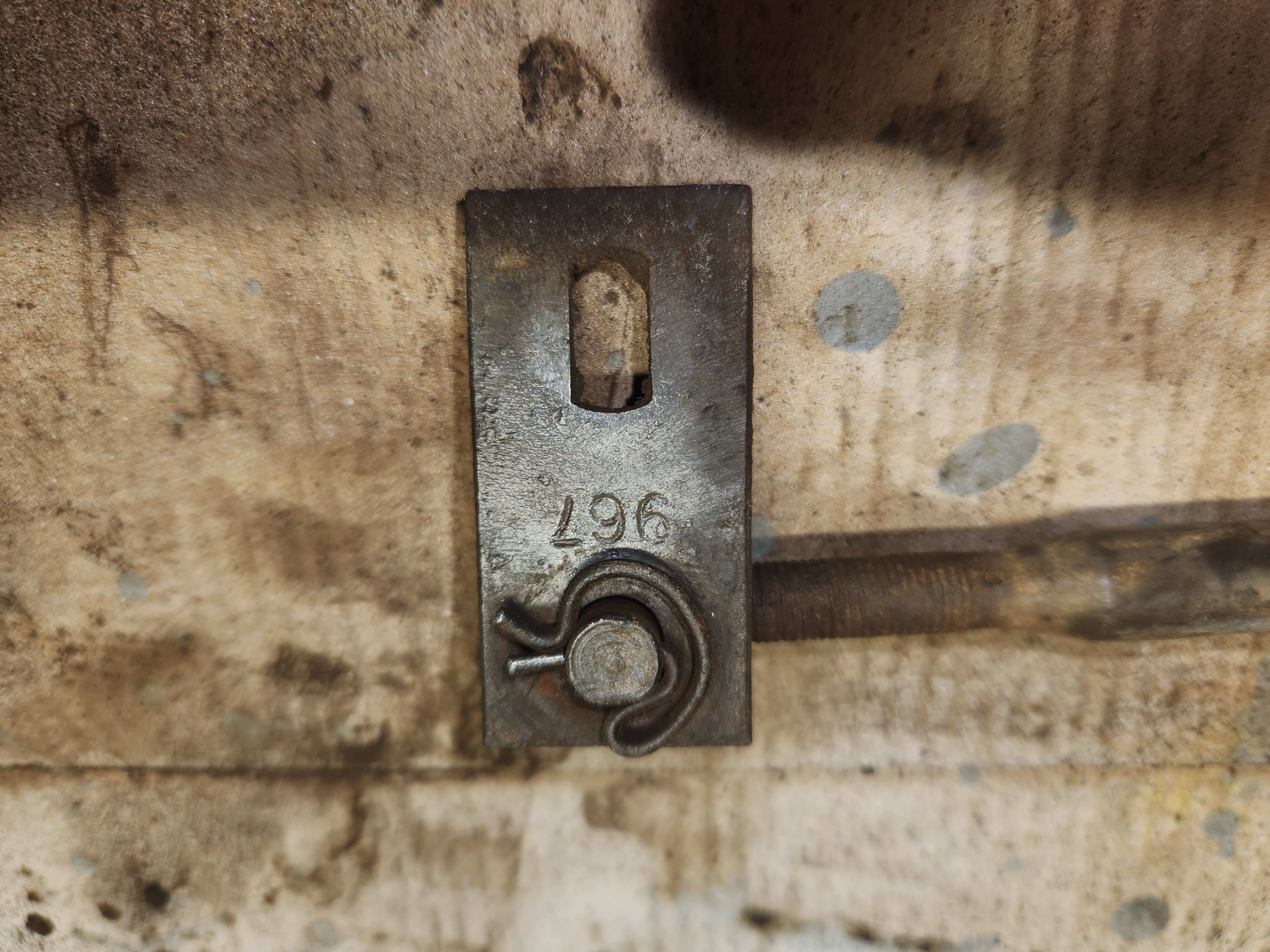

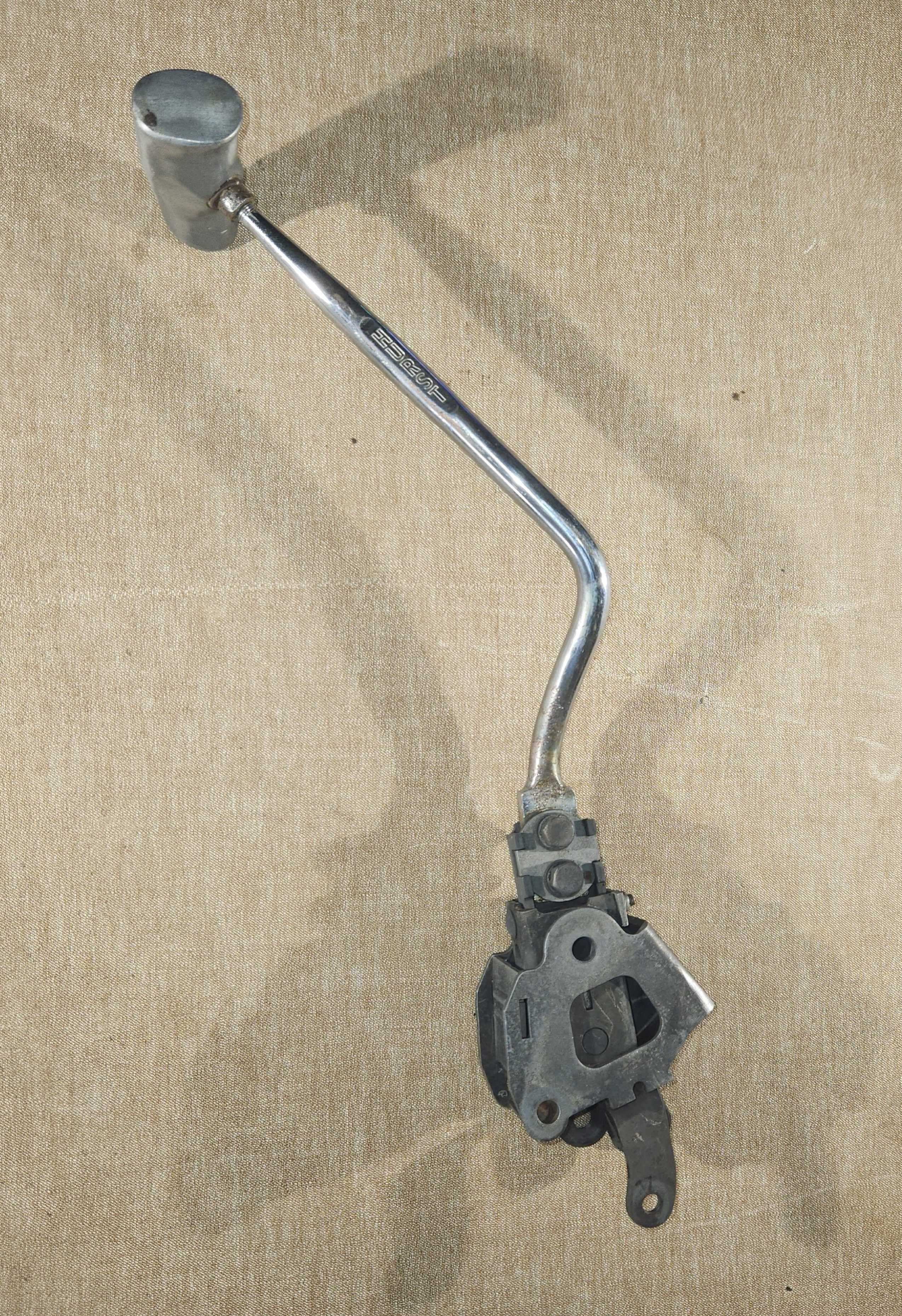

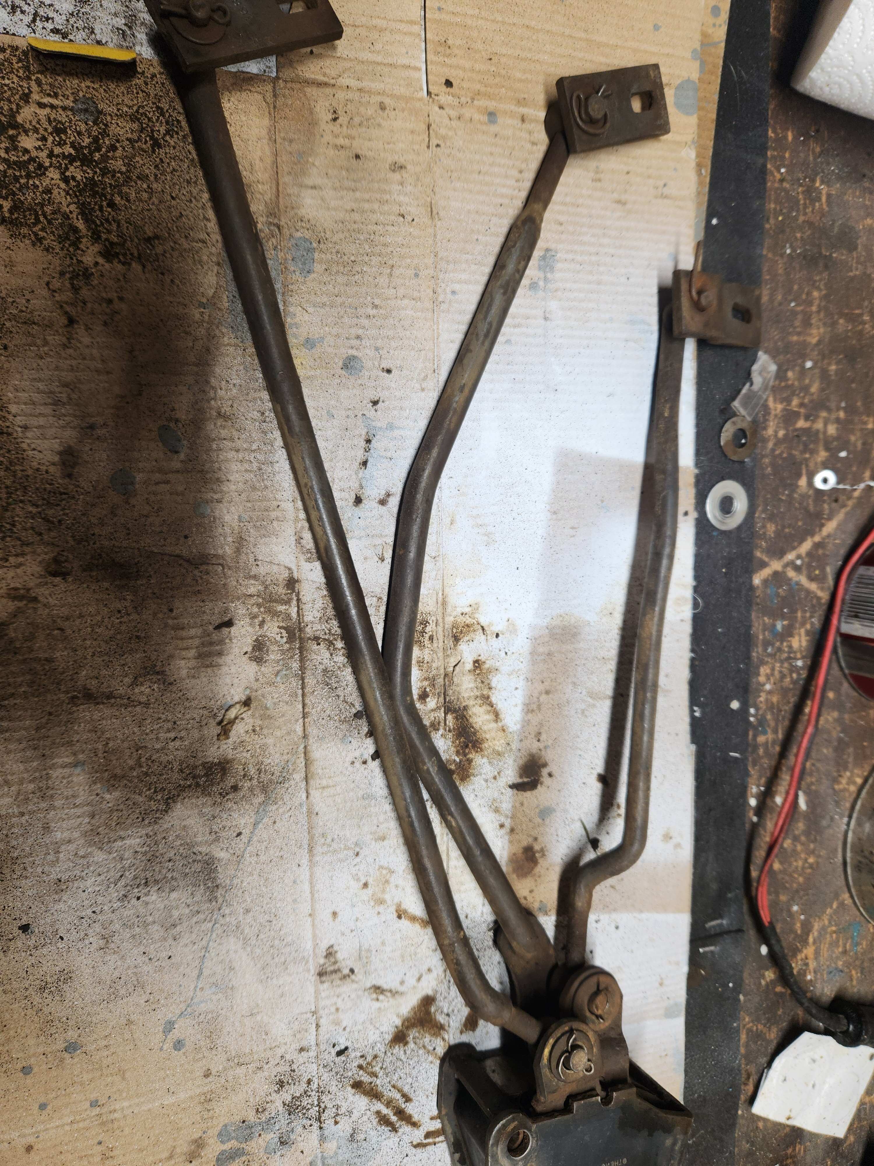

Here are some pictures of what I have. The guy I got it from years ago couldn't remember for sure what it came off of.

Top pic:
far right is reverse rod & lever
middle 'candy cane' is 3-4
longest is 1-2
Mopar went to the fatter rod sometime early to mid70's
I'm out'a-shape on this stuff but try that.....they look right for mopar
In the 3rd pic, that number is an individual unit warranty number. That is to say that NO 2 HURST shifter boxes had the same number.
There is 1 more number on the box and it is down low on the front panel and will consist of 4 digits/numbers
Along the bottom edge of the side panels is a raised portion with a notch in it; that is your neutral adjustment. The 'fingers' that protrude from the bottom of the box that the rods attach to have an alignment hole in them that a certain size drill bit or small screwdriver will pass all the way through. At that point you trans should be in neutral

I am no expert but here is my opinion. I went on the Hurst website a few years ago and all the "factory" reproduced Hurst shifters all had the pistol grip handle style lever. Not a round one.
That makes me suspect your shifter is not made by Hurst for an E body.
The Hurst lever housing always appears to be the same/similar. To change them for each car they have different levers and adapter plates to mount the shifter housing to the gearbox. The shift fork levers and the shift rods are designed to fit each gearbox as well and are different for each application.
