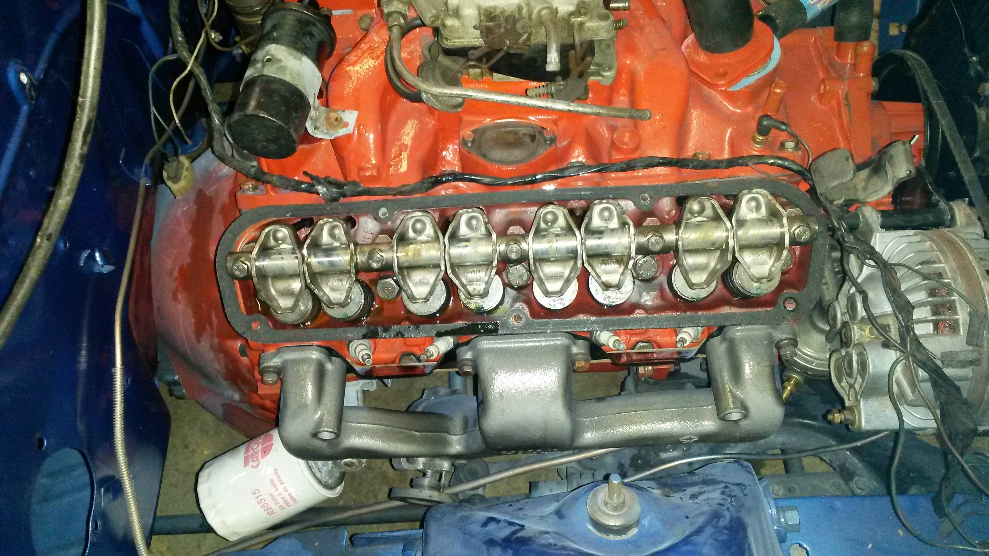

The one thing you can do is remove valve cover. You will see a set up simular to this. then loosen bolts that hold down rocker arm shaft. lift rocker shaft straight up and off. careful not turn shaft over and loose bolts and washer in side head! Next use any straight edge.ruler or level anything. the springs all should be the same height. You might see a broken spring. Might be an easy fix to get it running right again. Keep a magnet handy my come in handy.

Valve tips should be the same height as well if there is a bent valve it will be lower .
