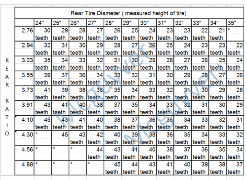

Hope this helps
sir_veza
Feb 10, 2021
165
74
Brampton, Ontario Canada
How are you measuring your actual speed ? GPS phone app ? And is it off at all speeds ? Use a tape measure and verify your tires diameter. The tire charts are averages. Some are taller and some are shorter.
The actual diameter of the rear tire is physically almost 26" therefore a 36 tooth speedo is probably needed.
