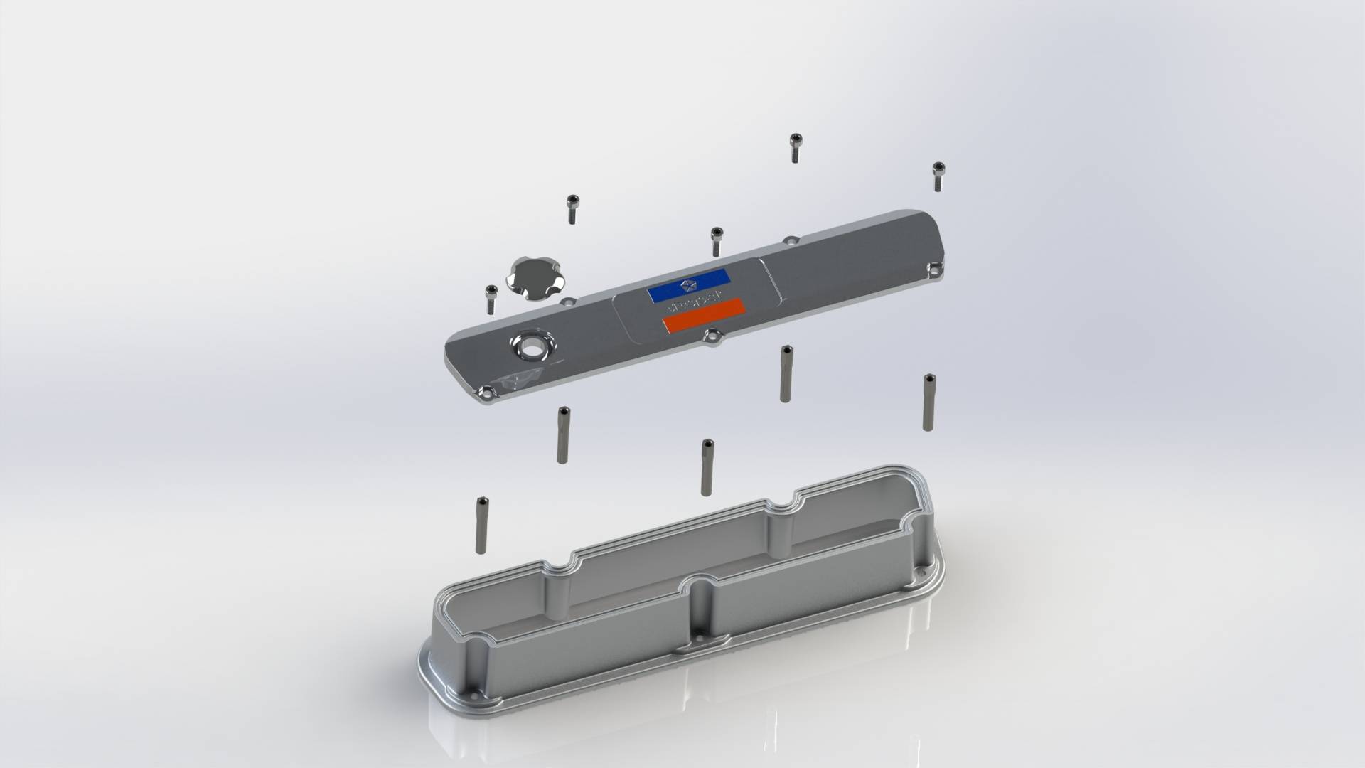

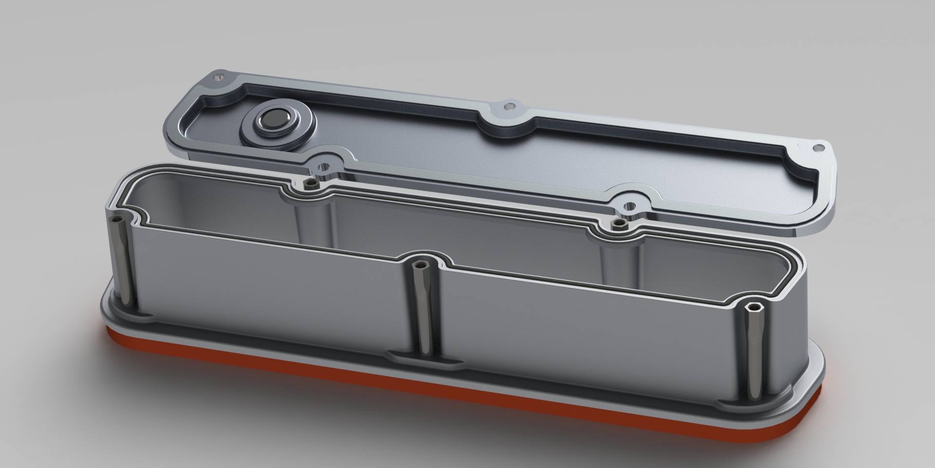

There's a company called Nordic American Performance Products. They've developed a new valve cover. I've been involved helping them. The pictures I'm posting are of the small block Mopar stuff, but big block stuff is on the way as well. As you can see, it's a "two piece" system with a decorative lid. If you are interested in commenting on this product, please search Nordic American Performance Products on Facebook and leave a message or ask your questions. If you like these, we need to let them know. They are pitching this to Mopar soon and hope to get enough interest to proceed.

I like the concept, especially the fastener arrangement (which is fargin' brillant). However, I find the design a little "busy" to the eye.
My main suggestion would be to lose that overhang where the top plate fits to the riser. They need unity of line: ultimately it should look as much like one piece as possible. To be blunt, that overhang serves to make the assembly look like it's comprised of mismatched parts. I realize there must be some overhang around the upper bolts, but the perimeter needs to be as smooth to the riser as possible.

I see a number of issues here , one more place to leak , the main problem with valve covers on Mopars is the surface they sit on was never milled flat & rigid valve covers are a pain to seal on far from flat heads which is why Mopar Always used steels covers so they will flex & conform . I also dislike the overhang of the top plate & why 2 piece harder to clean ? It doesn't seem like you can adjust valves on mechanical rockers unless you use a crowfoot on the nut so what is the advantage of 2 piece design ?.

I like them, can you post a pic of the other side/Pcv provision. Btw, years ago I bought new, as cast, Mopar aluminum valve covers, both had small cracks near one end just above the flange. They definitely would have seeped oil. I also find the stamped factory covers too be less than ideal for custom engines, strokers, etc. So there is a need out there.

The owner is going to get me a picture of the PCV provision. When I get it, I will post it for you.

I have to say I like em. I’ll be able to adjust roller rockers with wrenches I already have ( it appears) but, I have the BB. It’s a pain removing the driver side due to the booster. The sealing for iron heads may be an issue, If everything is straight, no problem. Like Chryco said, possibly more places to leak. Rubber gaskets in a nice valley should be fine. The PCV valve provisions is a must. Thumbs up JMO
