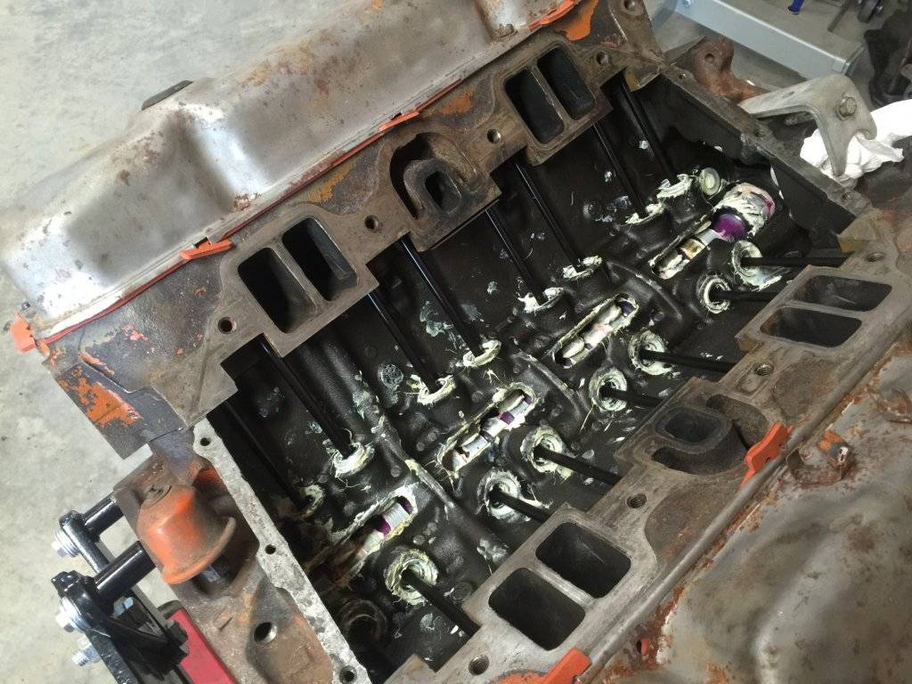

yes numbers matching block came from machine shop with a spot or two of orange no blue anywhere.
It's an on going question. It seems that all 71's were orange. The rule for 70 is blue auto and orange 4 speed. So when was the change to all orange; mid to late 70 production or for 71 production?
Orange it is then! If the engine had not previously been rebuilt and the only paint found on it is orange then I'd say it left the factory that way.
