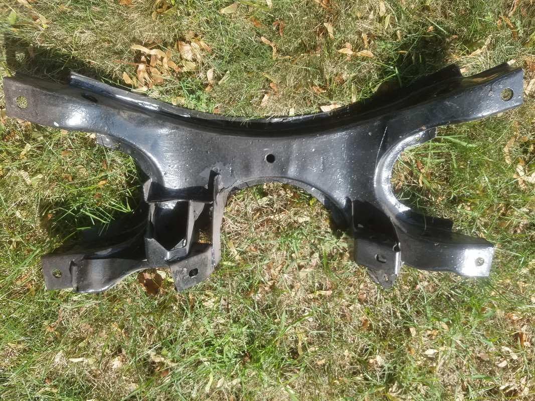

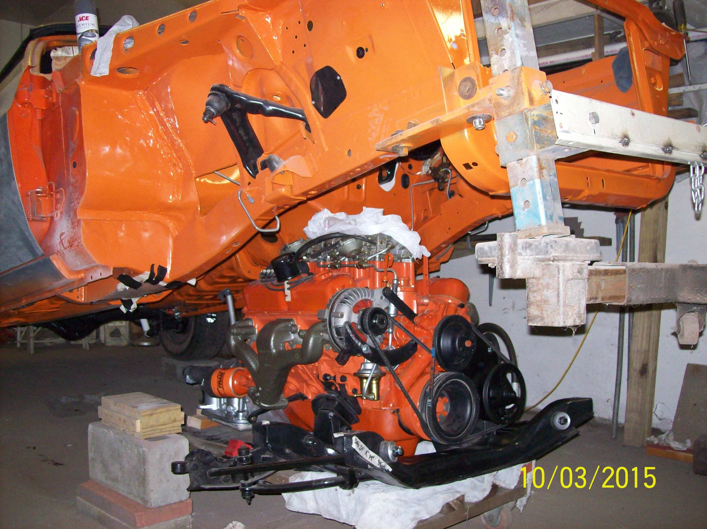

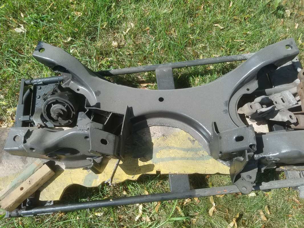

Hello Mopar friends, I was installing my engine this past weekend and had an issue with lining up my K frame bolts (3 ok \ 1 not ok). I built a jig and installed from the bottom with transmission attached. The main question is, with the weight of the engine/ trans already on the K frame, alter the bolt holes line up? This is a recent K frame I purchased and had it restored and had no damage to it. To take it one step further, the original one I had to put back in because my new purchased one wouldn't line up also gave me a hard time lining up until I took the weight off K frame with a screw jack. Has anyone experienced this problem?? Thanks in advance.
