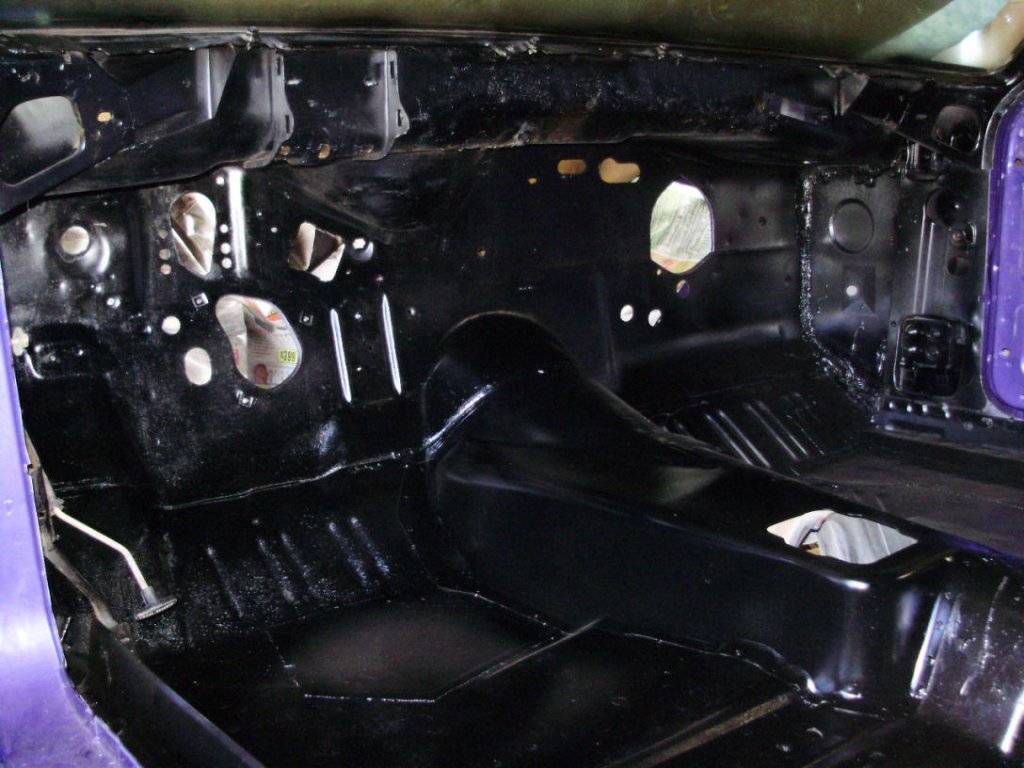

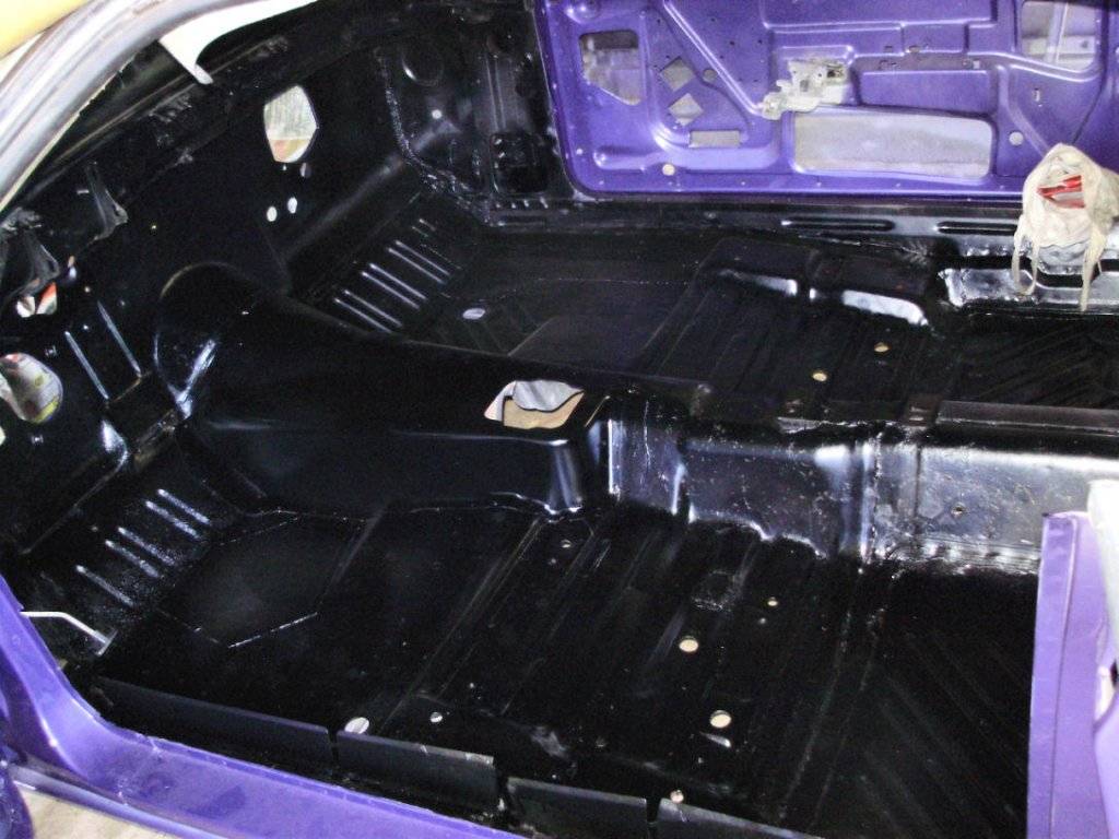

Great news that you got the problem sorted so quick. This is a little interesting to me as I also have a 71 Challenger and the exact same TKO 600 kit as yours. Except mine is going behind a 440. I got it many years ago and I never really checked everything properly, however it seemed to be all correct (11" clutch etc). However I am worried that it will not be a direct bolt in like they claim. Two different people have told me that I will have to modify the floorpan because it will not go in as easy as Keisler advertise. I don't want to do this as I just got a manual trans hump welded in, and don't want to be banging big bulges in that.

When I ordered the kit I also ordered Keislers hump as well. The salesperson said it allows the trans to fit. I've welded mine in already if I have to make modifications then I guess I will. I really want to be driving the car by spring. Good luck.
Ah, if they also supply a trans hump (which I didn't know about until I read this) that would explain why they say a direct bolt in. Any chance of a good photo of your trans hump please? I have attached mine here. Maybe I can get an idea of the differences.

Yours looks no different than mine. Welded in the same location. I can't take a pic because I'm traveling for work. Based on the Keisler reputation I still see making modifications with the hump even though I purchased it from them. :)
