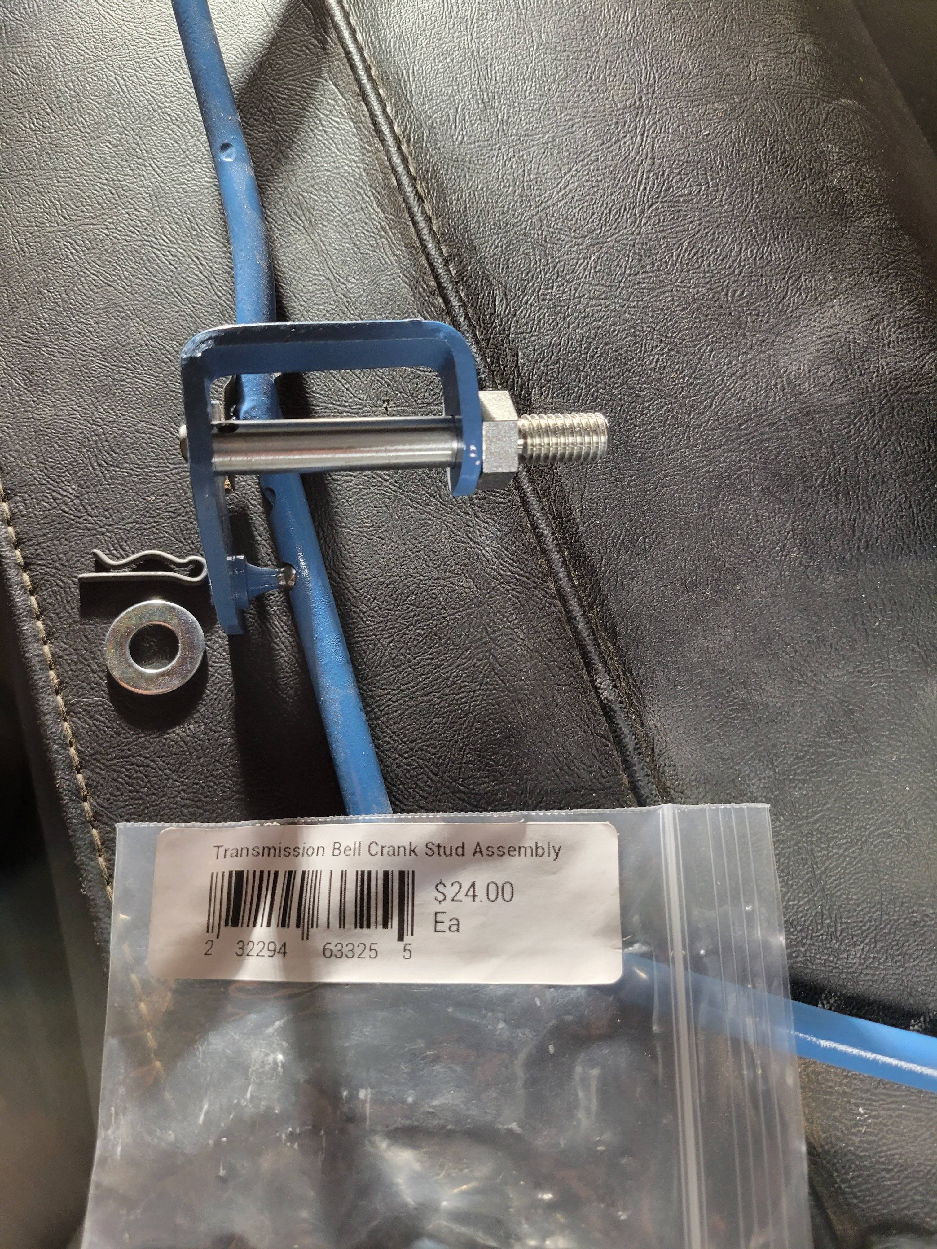

Is the kick down lever assembly the same for a 727 and a 904? I just got a bell crank stud and it came up about a 1/4" short at the end where the cotter pin goes through.
Short answer...maybe. The 727 has a straight kick down lever on the trans and the 904 should have a bent lever to compensate for the difference. What engine/trans combo is the 904/727 conversion ?
340, stock carb on an aluminum intake, 904 trans. The linkage seems to line up nicely, but the stud is too short - see photo. I wonder if the width/gap on this linkage at the bell crank is wider for one versus the other. And I do not know which one I have as the car was puchased without engine or trans. The previous owner had a bunch of parts he had acquired, and I assume (ha, ha) they all go to this car. Now that being said, this car originally came with a 727, so this may be the incorrect linkage.

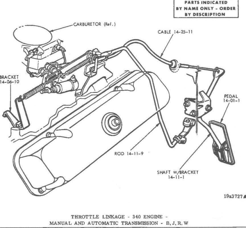

A little puzzled on your part. What year is your car ? I know at least the 72 and up don't use that part. The car came with the linkage shown on the diagram that I posted. Just a 1 piece rod from the top of the manifold all the way down to the Kick down lever on the trans.
Look at pages 5 and 6 of the following link.
