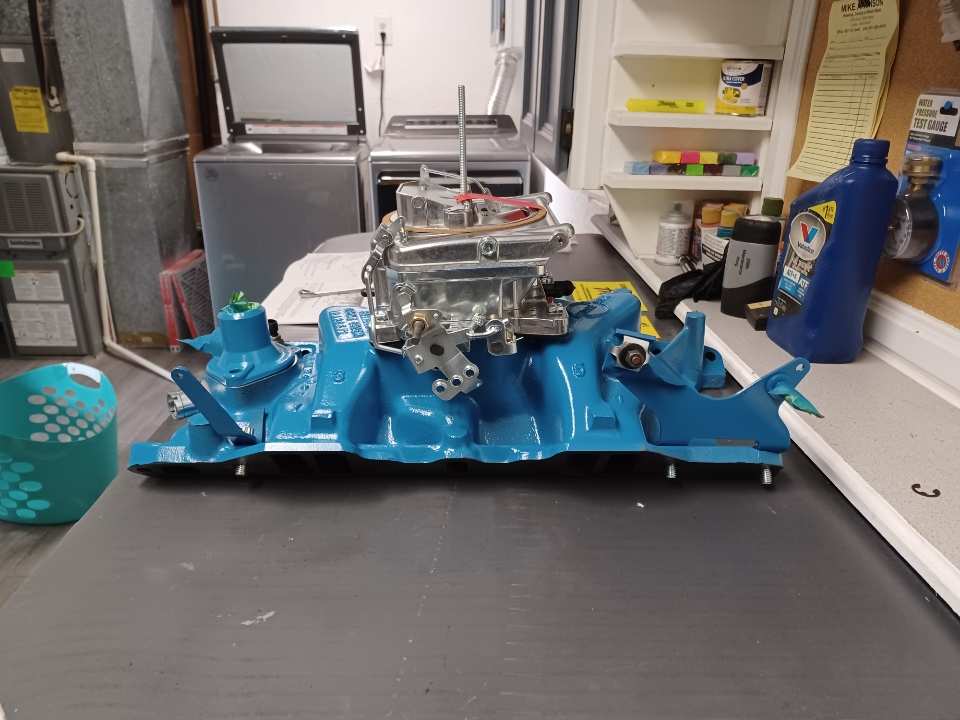

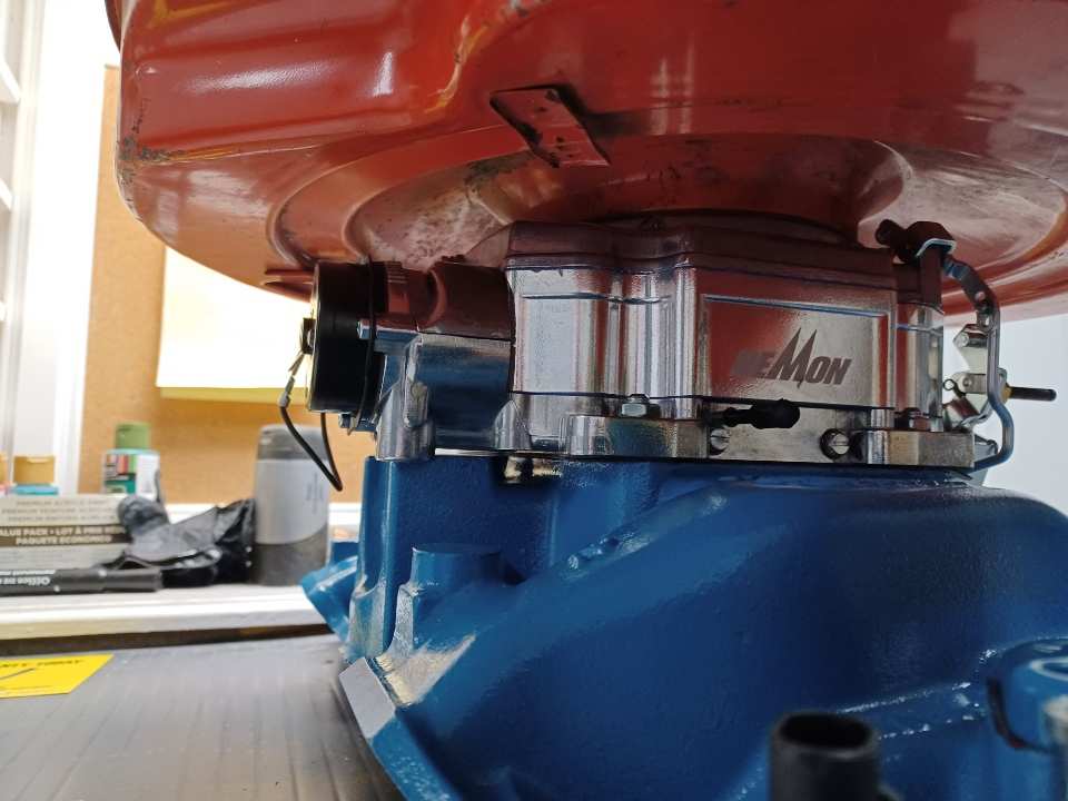

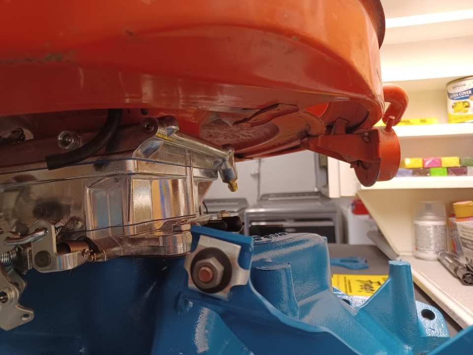

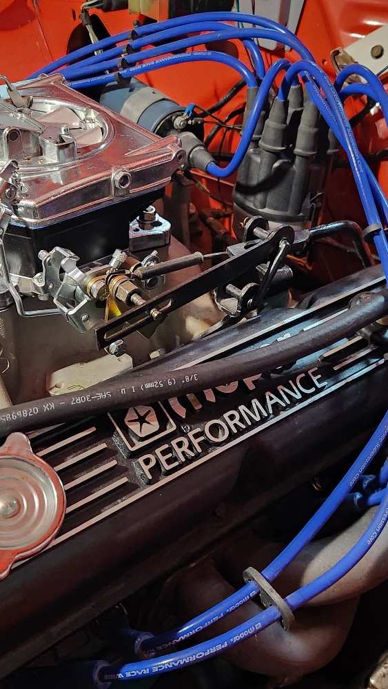

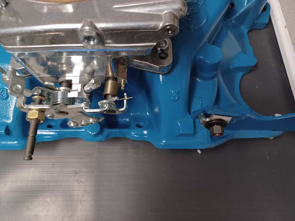

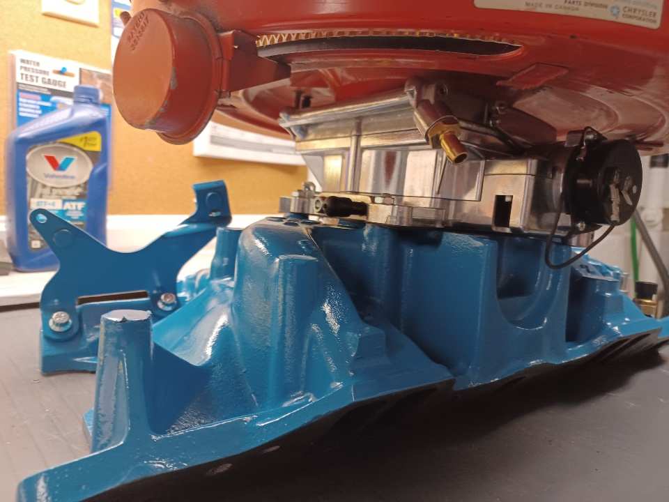

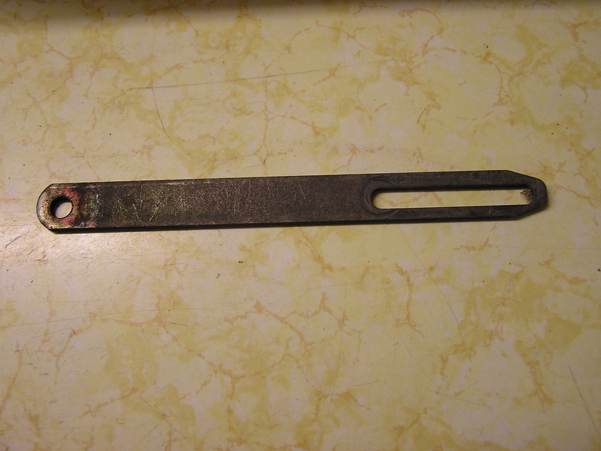

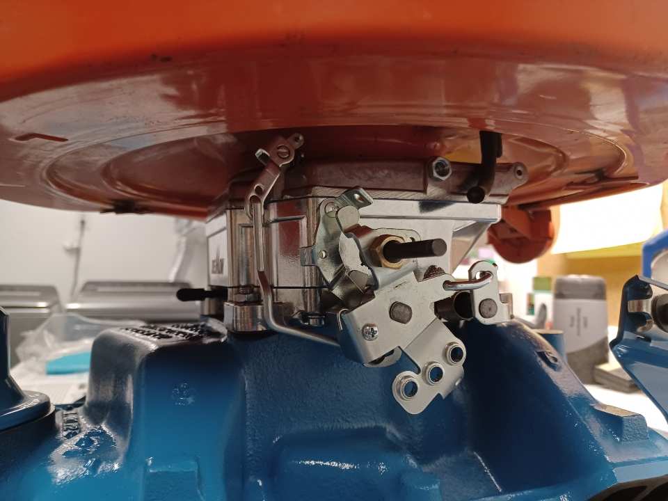

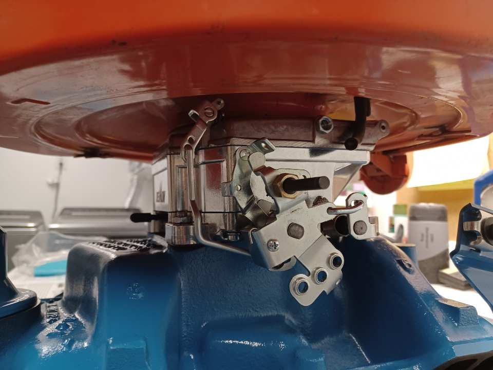

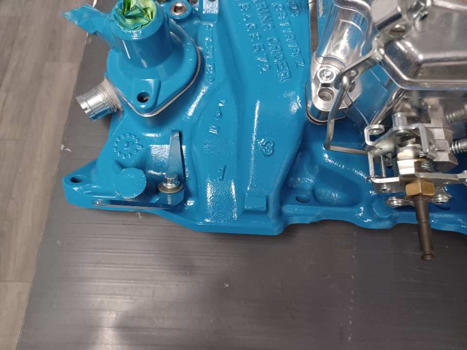

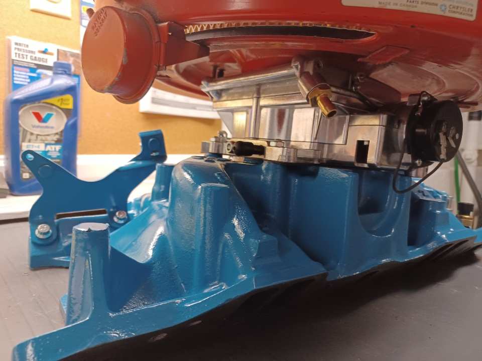

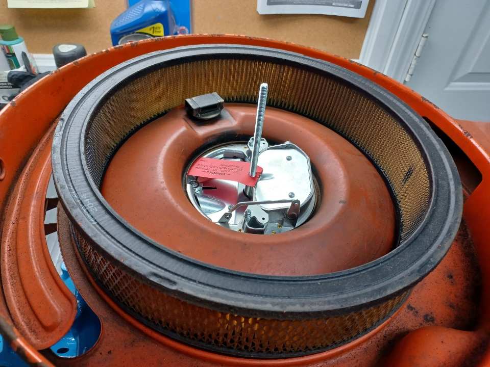

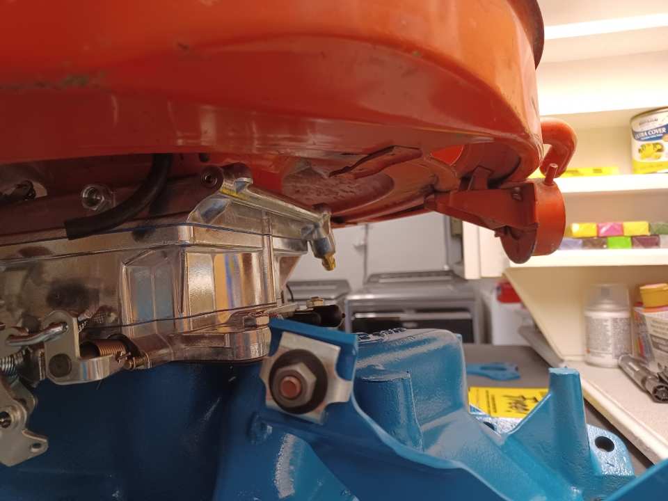

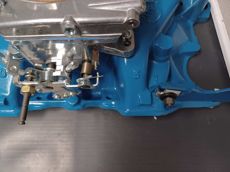

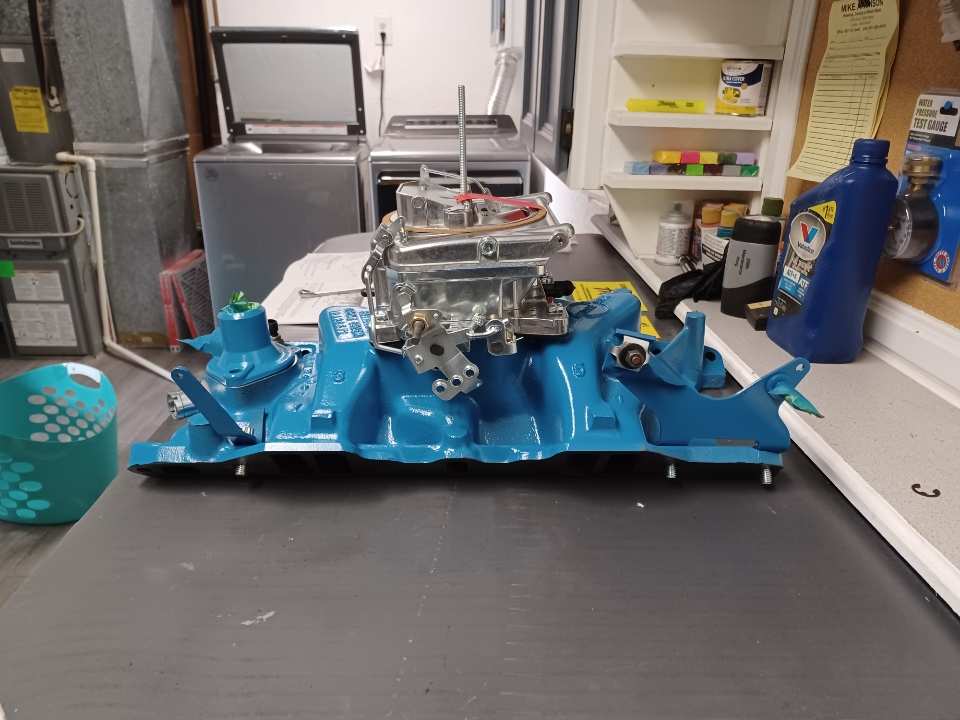

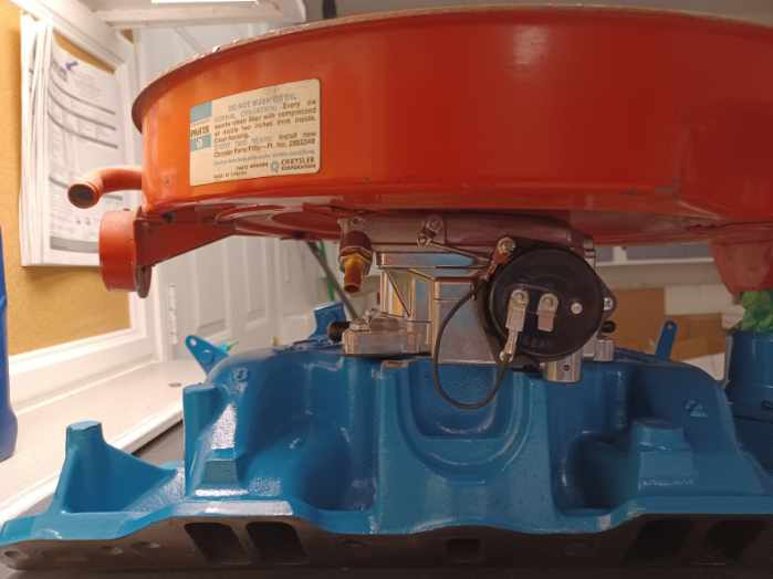

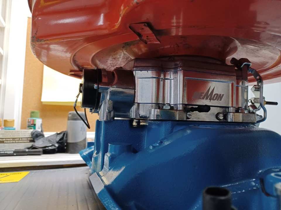

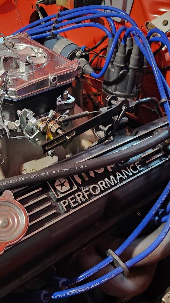

Anyone using the Street Demon carb? I am swapping out a TQ. Street Demon not matching up with kickdown very well. I believe the linkage I have is stock for 72 model small block with 727 and TQ. No linkage problems with TQ. I am using the throttle stud from TQ and got the Chrysler throttle adapter bracket for the Street Demon. Secondaries open with no linkage but can't fully open with kickdown attached. I moved the slotted rod to other side of pivot arm for better alignment on throttle stud but still need about an inch of travel. Could probably increase the length of slot in slotted rod but want to see what others are doing before I get caught up in mods and fabrication.
