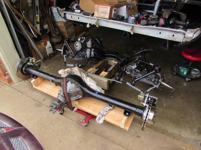

My suspension in my 71 Barracuda. Can't see the stiffing plates, but they are there.

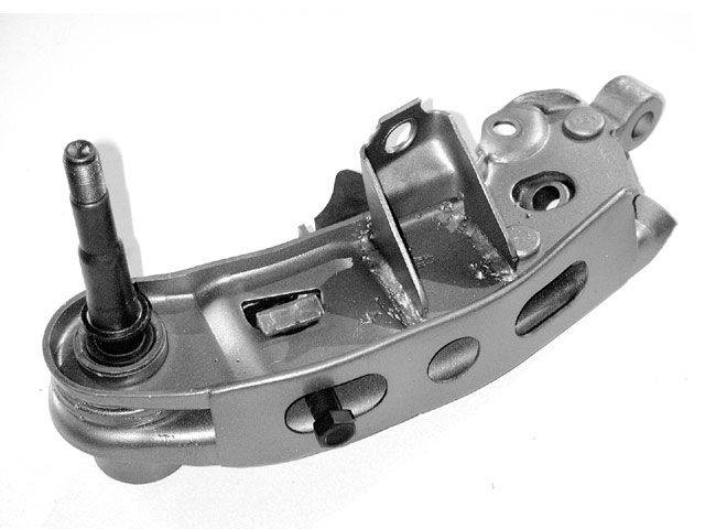

If you choose to install, I clamped the two sides of the lower control arms together a little tighter, making sure that the torsion bar arm still pivoted freely. This is where a lot of the looseness takes place on the LCA. Then weld on the support plates.
