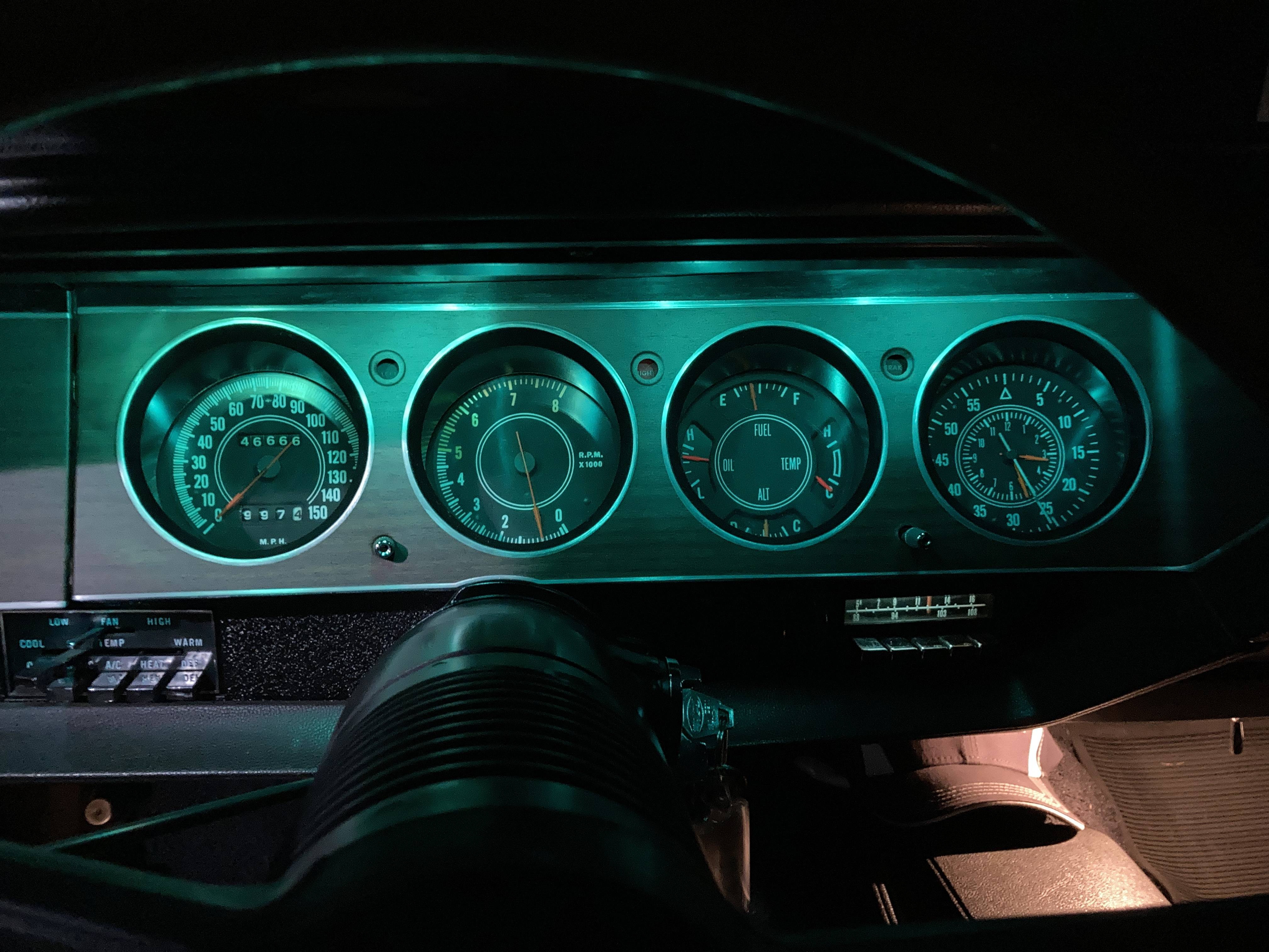

I tried white initially, and the color was blue, as the factory lenses are blue.
I then got yellow LEDs, that when mixed with the blue lenses yield a green light shown above.
Incandescent bulbs give off a yellowish light.
