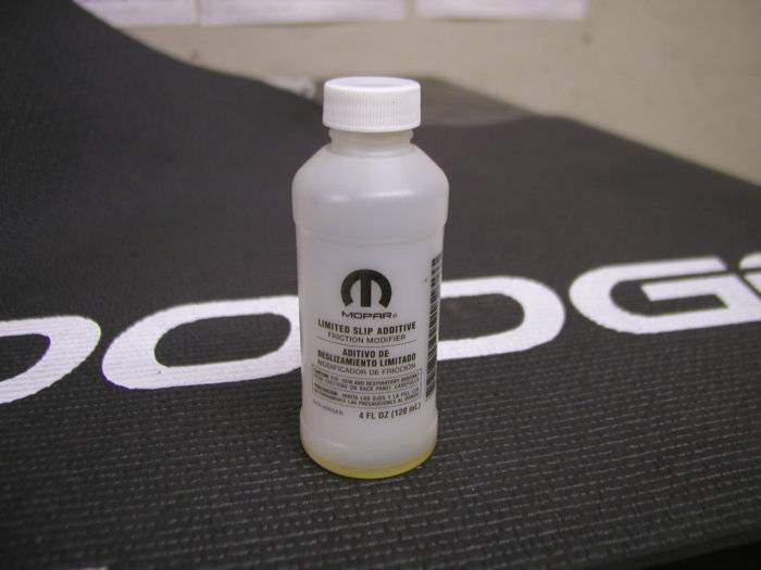

If you've got a "sure grip" in that axle, then Yes you do need it.
Go to your local Dodge dealer and get a bottle of the "real thing". They've got it.
Mopars & Missiles
Jan 1, 2012
236
106
Here's the Mopar type. P/N 04318060AB
