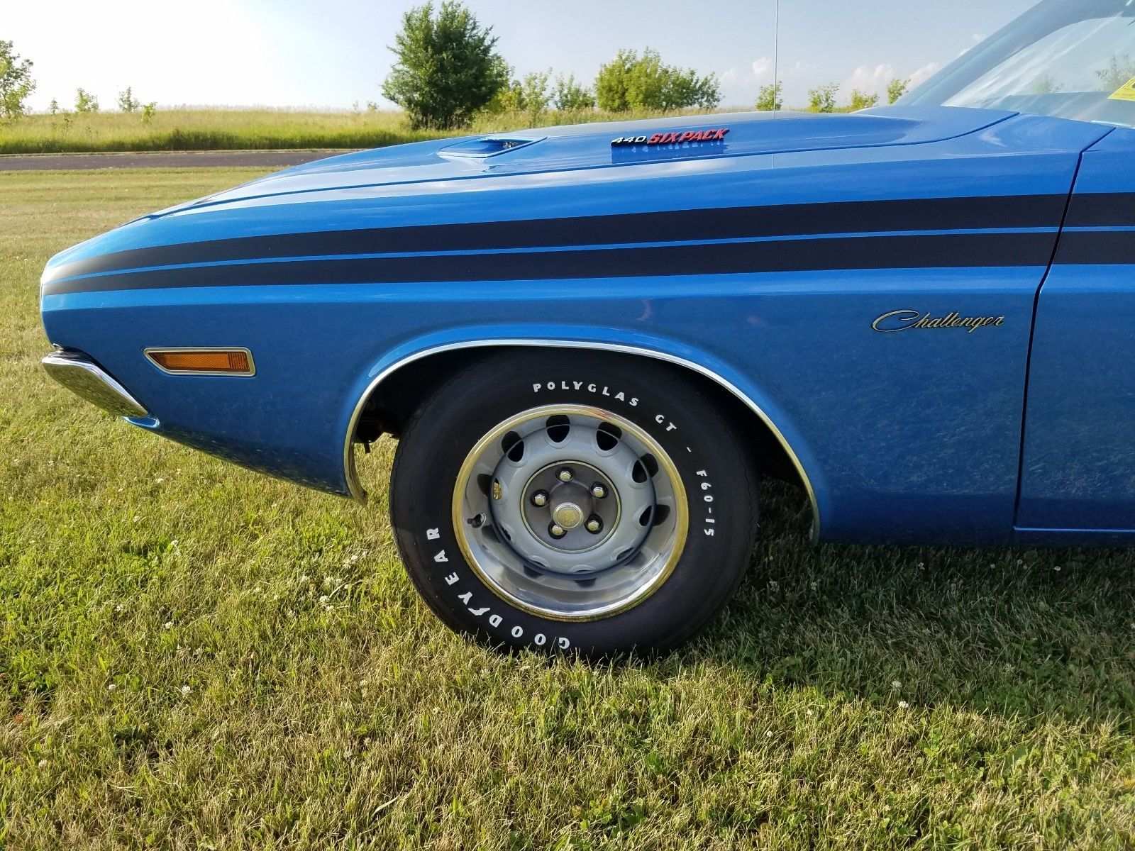

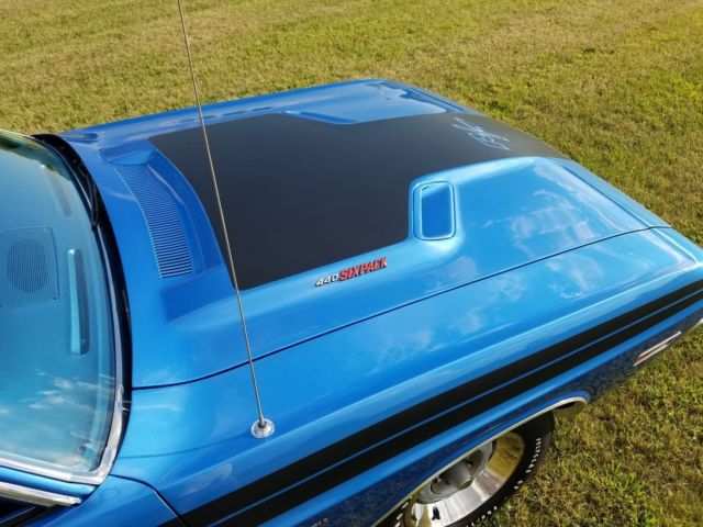

Here's a method that's been used.
Use a large refrigerator magnet a solid sheet magnet that will stick to the hood and push the pins of one of your emblems into the magnet, mark and punch out the holes, trim around the outside to make a template of your emblems that will lay flat on the hood (this aids in placement, you can stick them to the hood and stand back and look at them). Trim the holes so that they are round, clean and neat so you can find the center of them with the center punch. Start at the rear corner of the hood and mark a line 6 inches in from the edge toward the center at the rear edge of the hood, both sides, from this point measure straight forward toward the front of the hood exactly 17 & 3/8 inches and mark a line up and down on the raised part of the bulge. This is your front to rear placement. On the driver side the rearmost part of the "K" fits here, on the passenger side the front most part of the "4" fits here. Place the template on the hood and position it as close as possible to the center of the hood bulge, make a mark through the template pin holes. Remove template, you now have the three pin hole locations. Your emblems should have small plastic covers on the pins, these are the retainers. They are intended to "snap" into the holes. To make this work the holes must be spaced exactly the right distance apart and drilled exactly the right diameter. I found a .185 drill bit to be correct (3/16). You might want to get a bit and drill a flat piece of sheet metal using your template to make sure your emblems will fit the holes before you drill your hood. Also they are hard to remove once you pop them all the way in, so be cautious there too. Attached is a pic of hood with the emblem.

This is exactly what i have and thank you so much for the help
