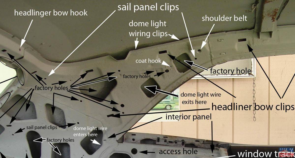

I really screwed up replacing the headliner in my 71 Barracuda! I forgot to measure the location of the hole for the bolt that secures the shoulder belt harness to the roof above and behind the window and I can't feel the hole in either side. I do have the sail panels and coat hooks mounted but I can't find the hole for the shoulder belt... Can anyone help me out, maybe measuring off the coat hook and edge of the window opening? A picture would be helpful I'm sure.

Here you go..

Here you go..
Hello moparleo,
I was able to locate the factory location for mounting the seatbelt using your information, the hole was 4 and 1/4 inches forward of the screw hole for the coat hanger, and about 2 and 1/2 inches above the rear window measured from the open side of the steel pinch weld.
Thank you for your assistance with this, its very much appreciated!

The best way to exactly find the hole is use one of the wife's very fine sewing needles.
Carefully pierce the head lining until you can find the hole.
Thank you, I did find the threaded hole on both sides (4 and 1/2 inches forward of the screw hole for the coat hanger, and 2 and 1/2 inches above the rear window opening pinch weld).
Thanks for your assistance, it's much appreciated!

That's what I ended up doing, it was helpful to have a picture showing the location of the threaded hole too.
