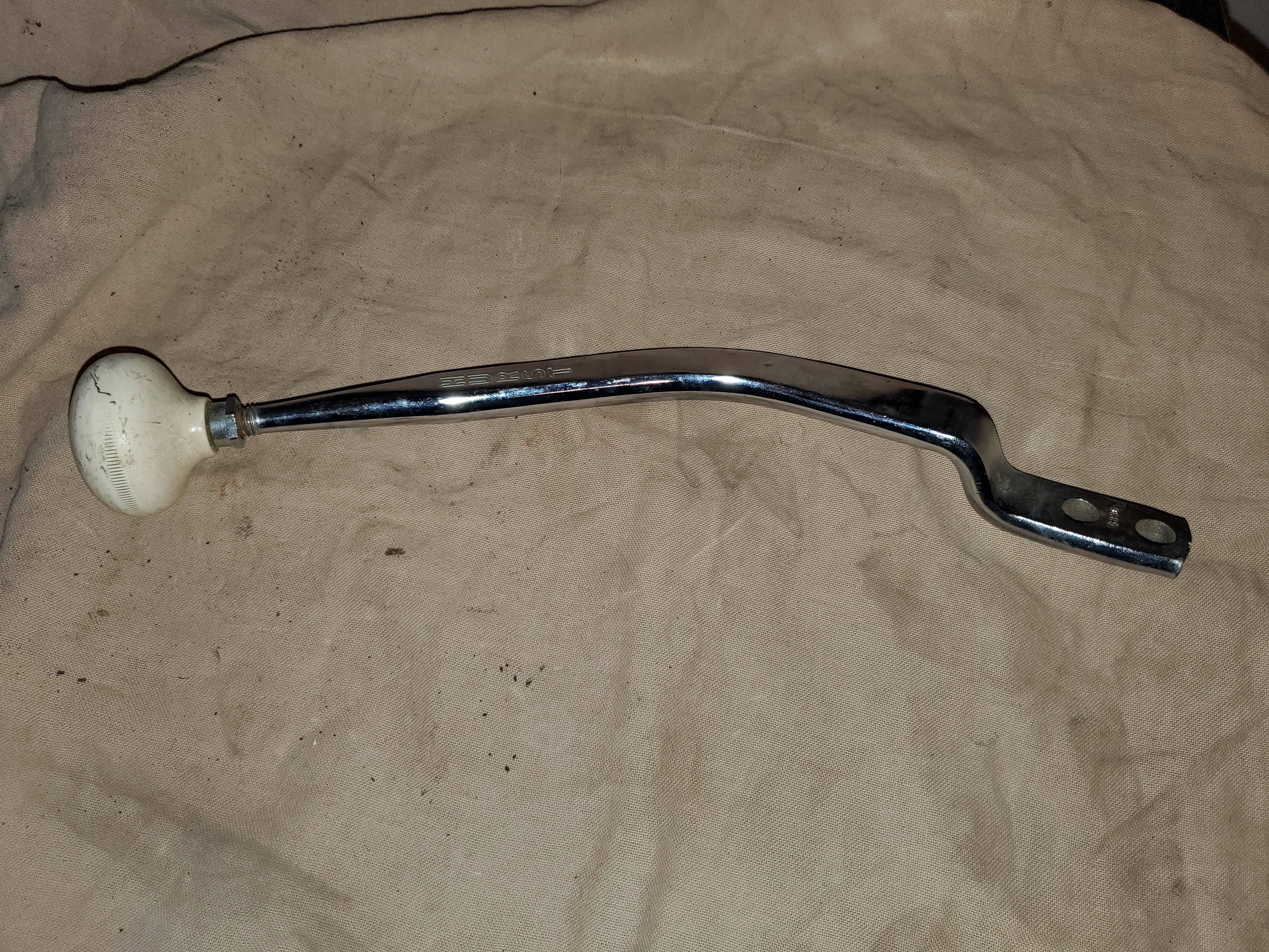

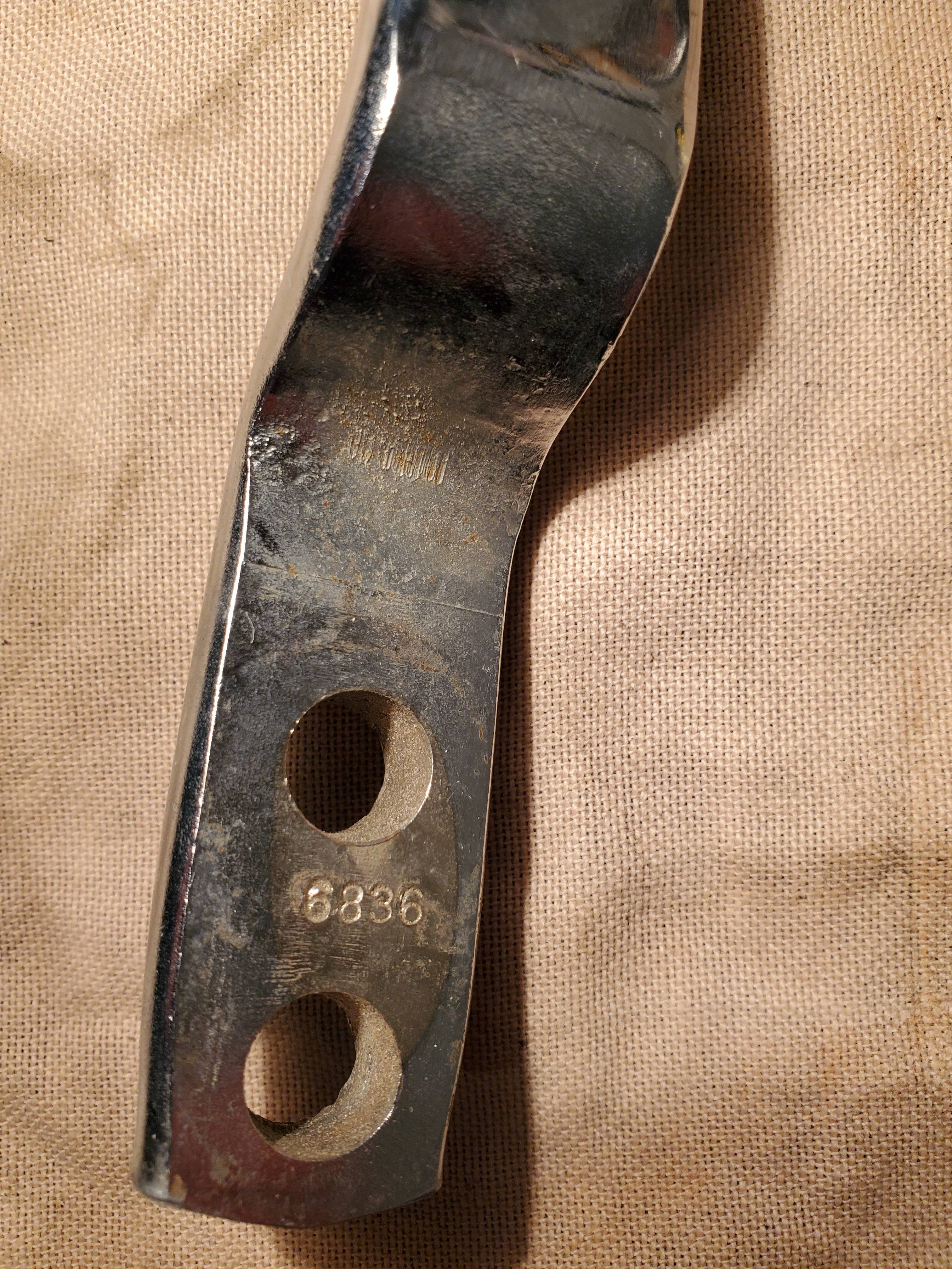

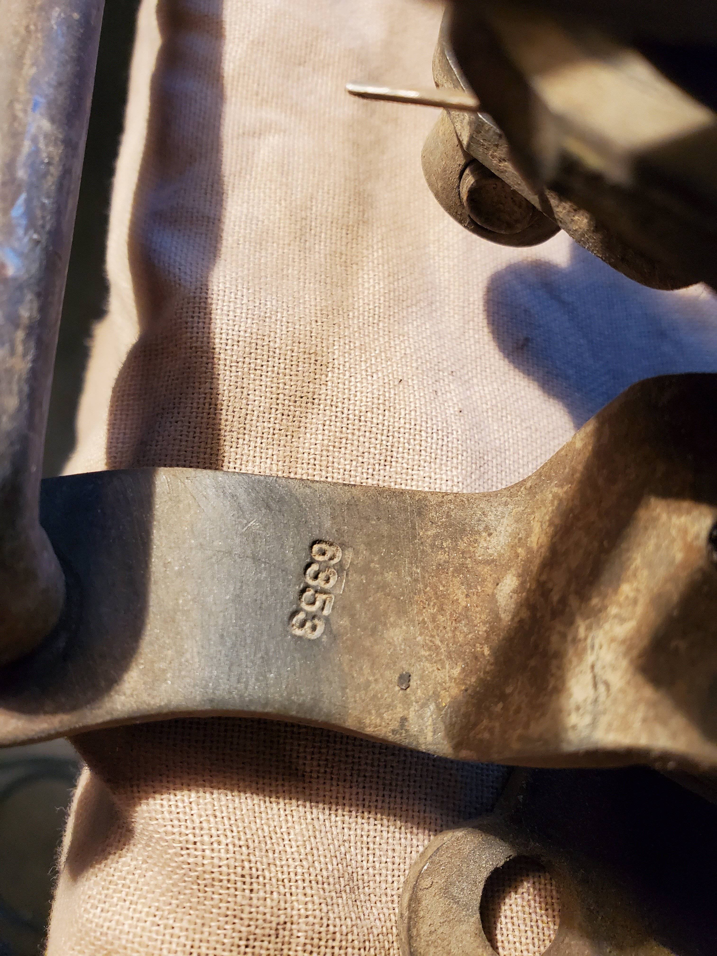

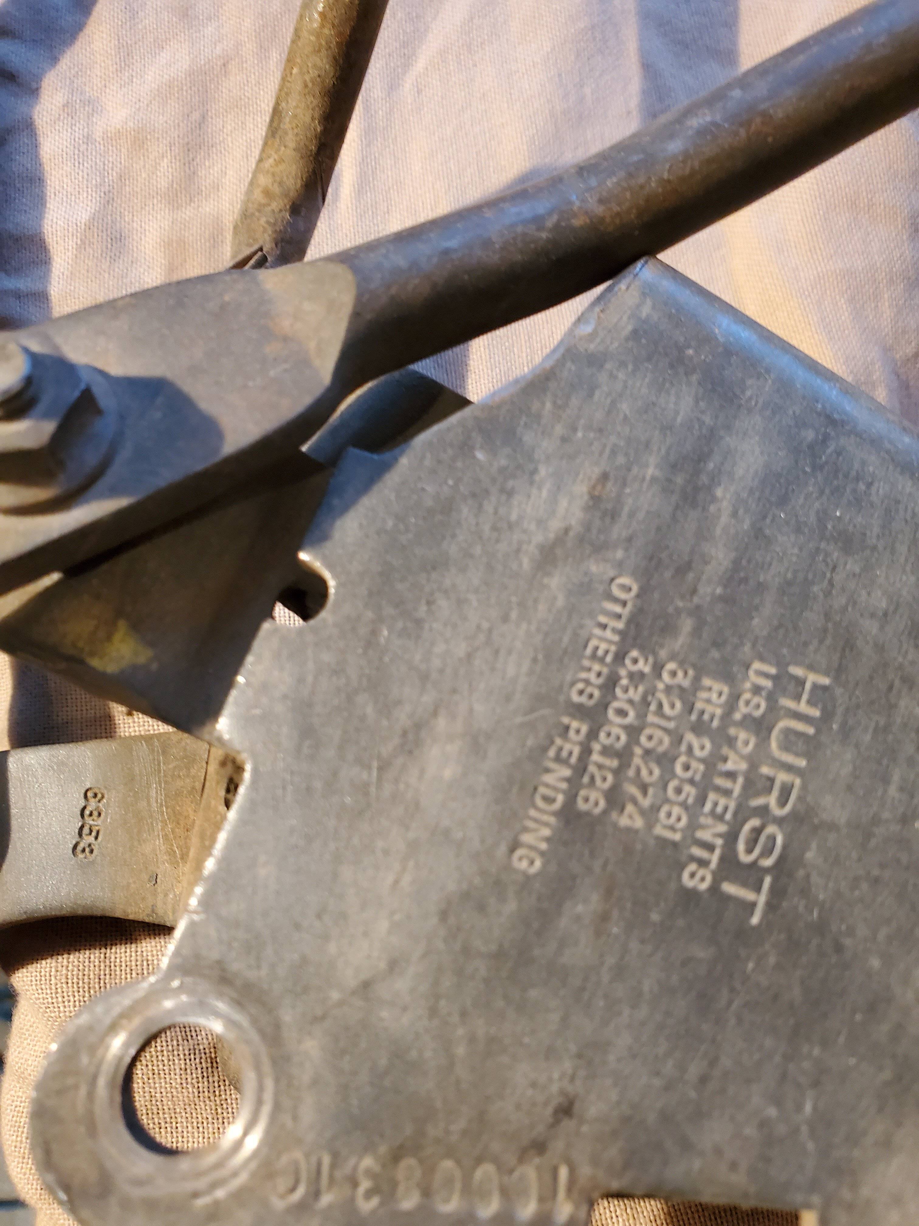

I put a 4 speed in my challenger, it was a 3 speed. Now this is a abody shifter mechanism (#6353 on reverse lever) dont buy one with is # on it if someone tries to sell it to you, it won't work in an ebody however brewers will give you $95 core charge on it ( trade in) if you buy rebuilt shifter from brewers but not sure if you can trade abody for ebody? Now if you find a old ebody shifter you also have to find old ebody shifter rods because brewers ebody fingers on bottom of their shifters (new or rebuilt) are longer and wider and need brewers longer, wider and thicker rods. I dont want you to finding out the hard way like I did. I hope this info is of some help. Packers #1 fan Hugh

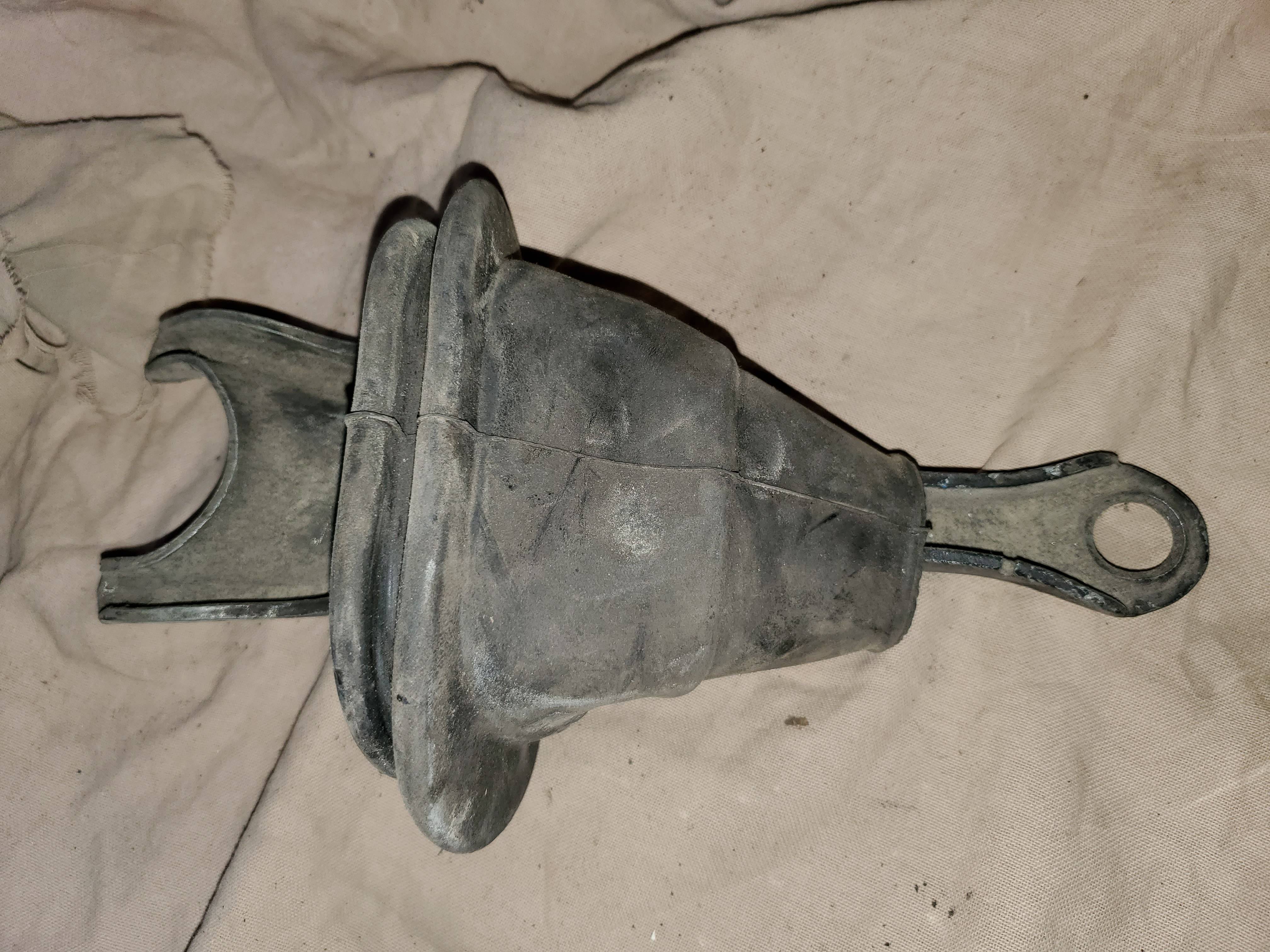

I did find the shift mechanism and mount, rods, big block clutch fork, and the shift levers. I already had the pistol grip and trans so now I think all I need is everything for the clutch. Also bellhousing

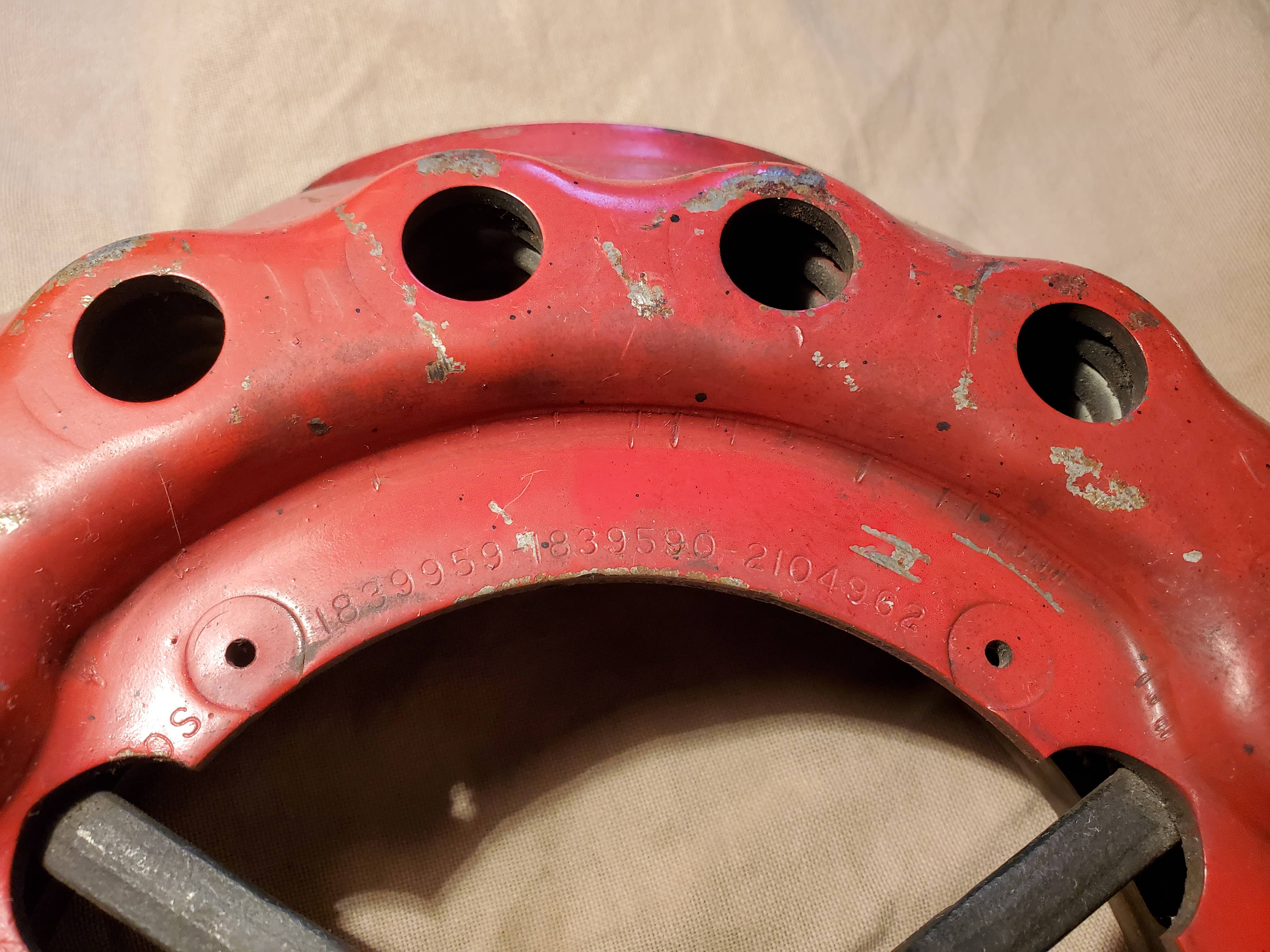

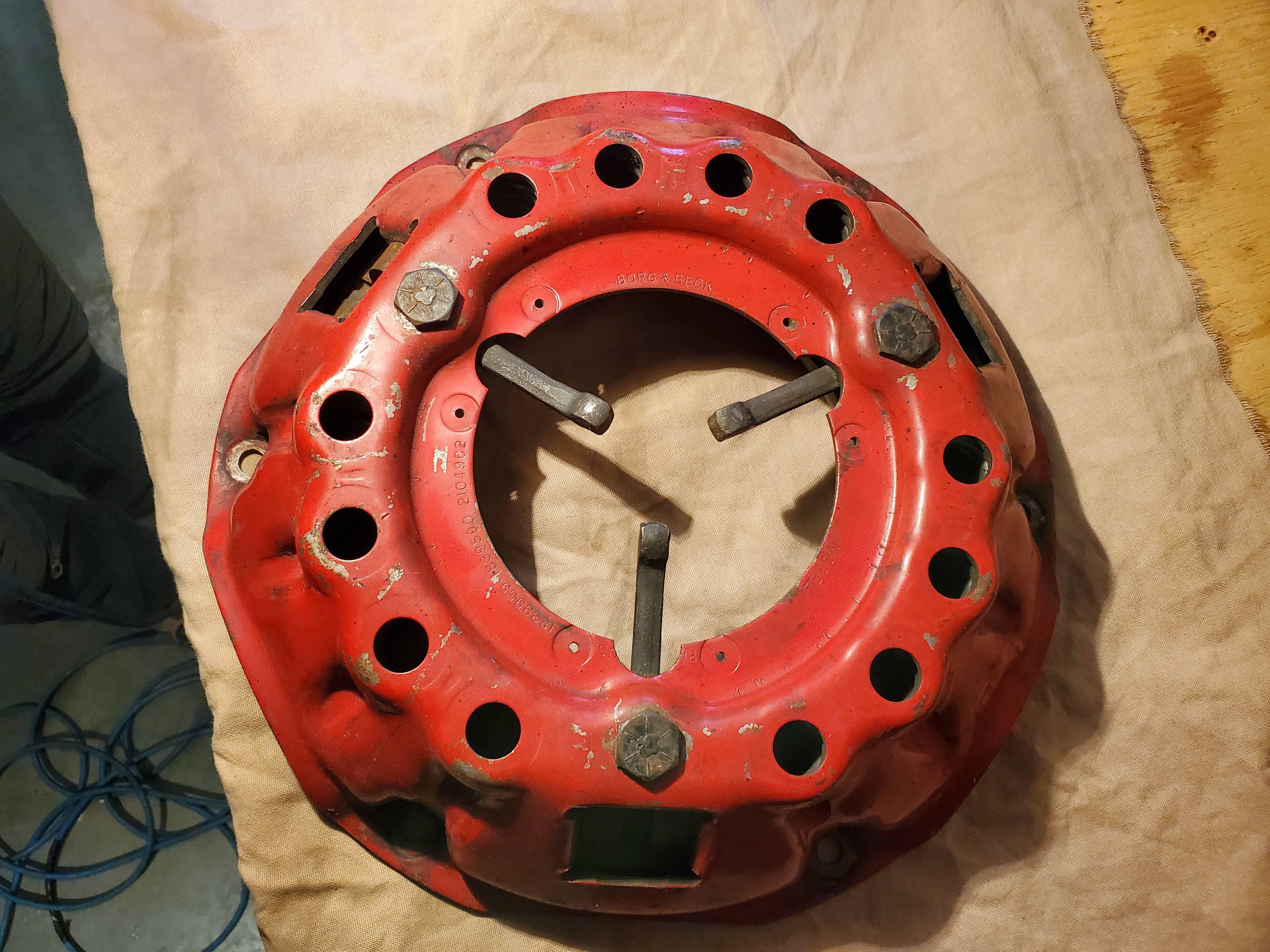

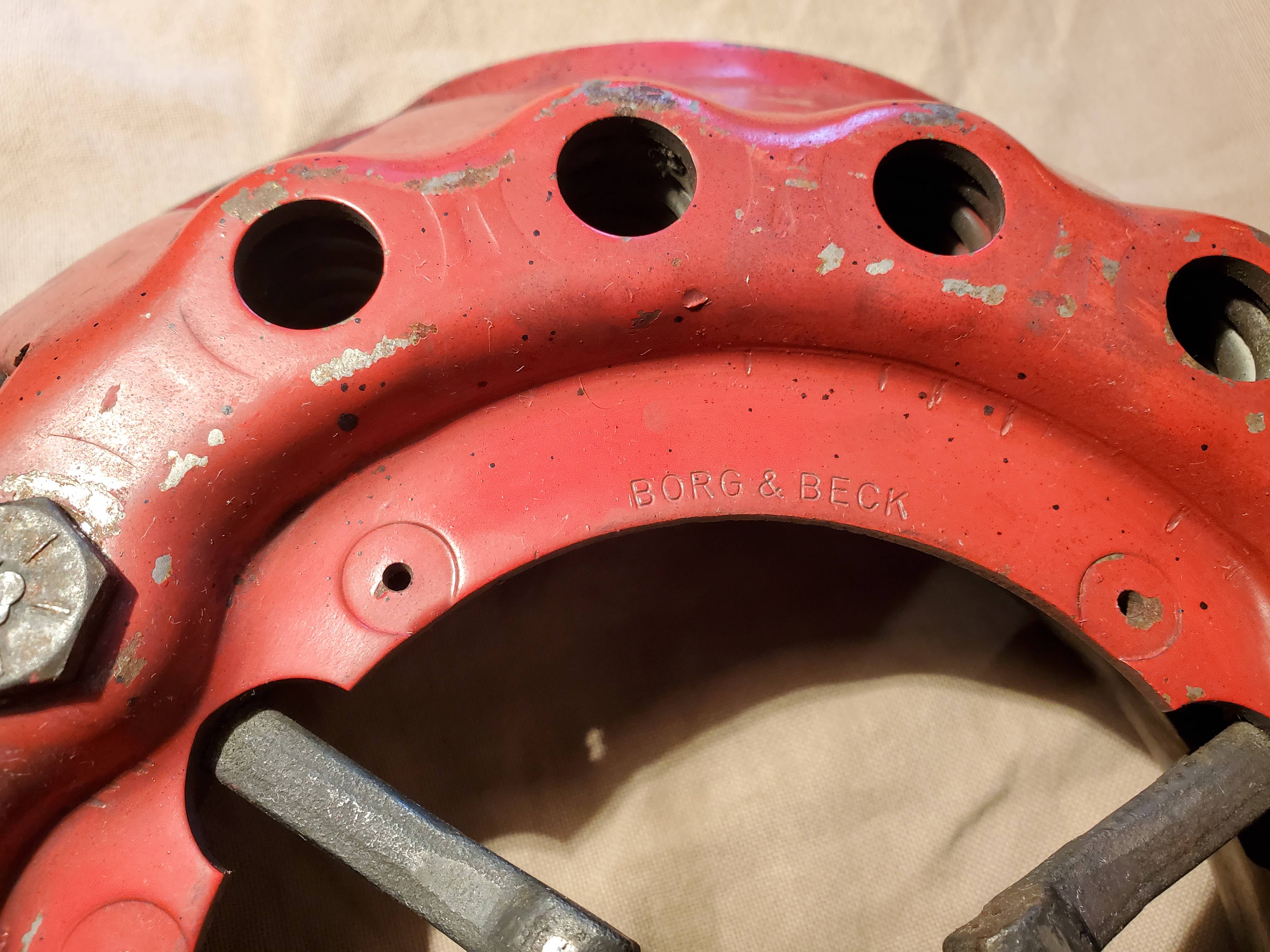

I had a flywheel but when I went to buy my clutch and pressure plate I talked to a dodge speed shop owner he told me he had a 4x4 owner that kept burning up clutches he sold him a centerforce clutch disk and pressure plate he hasn't seen him since - so I bought a centerforce packege very happy with it - its not too expensive and no problems - just throwing the idea out there. #1 packers fan Hugh - ( still waiting for summer to show up damn canada )
