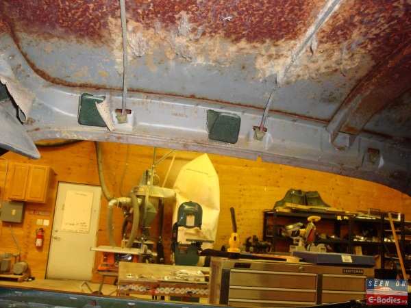

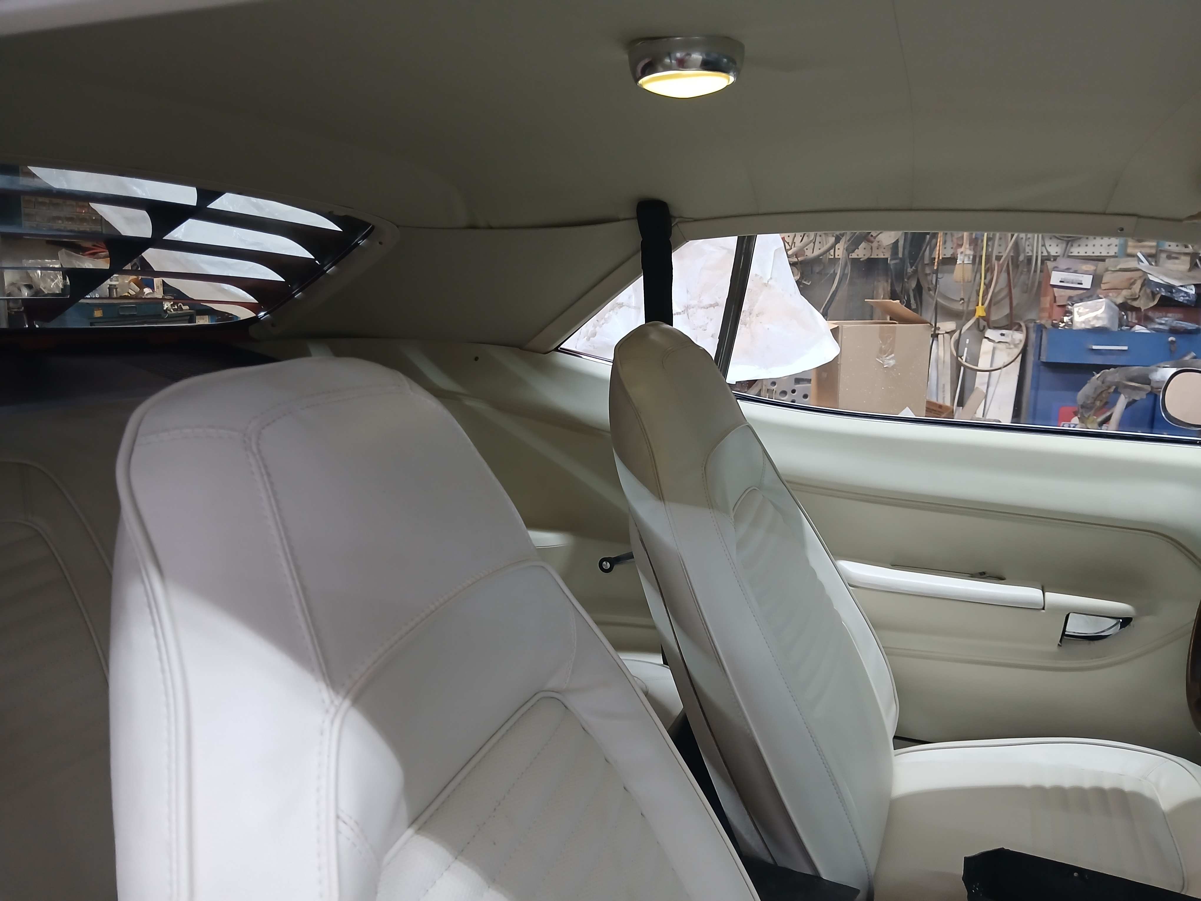

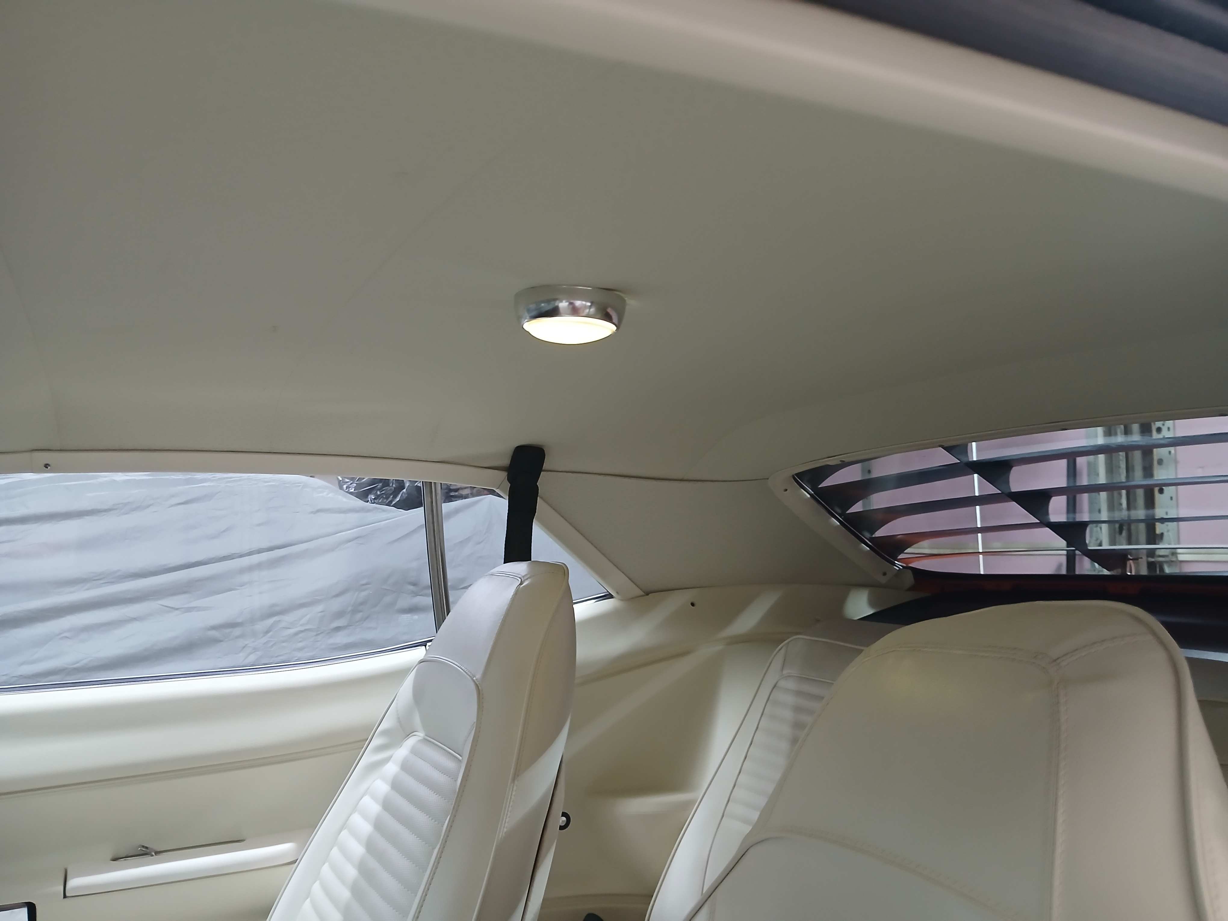

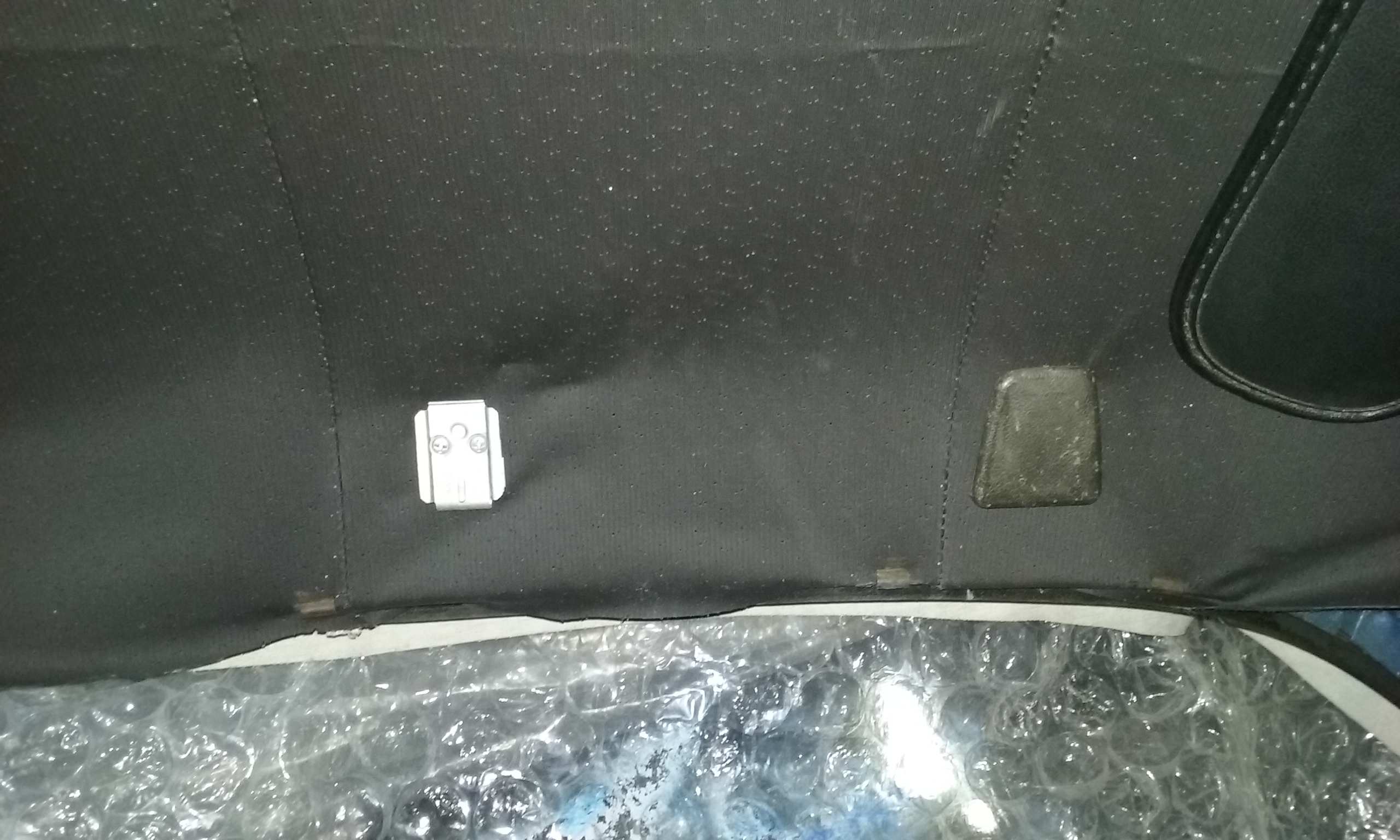

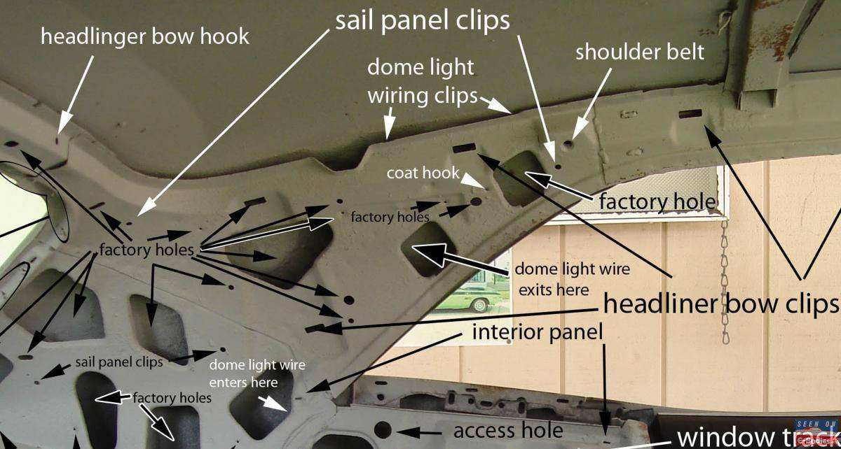

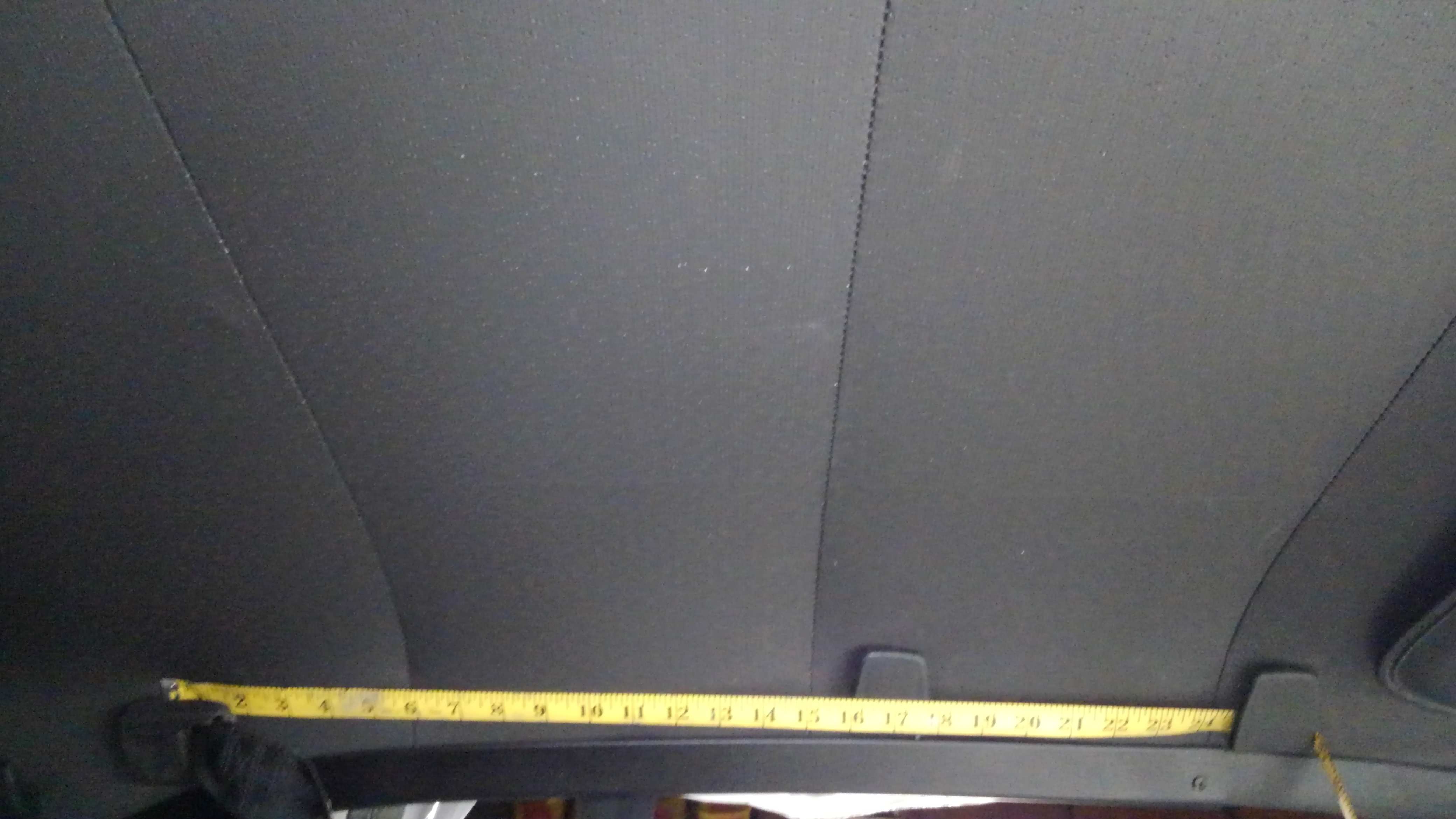

2 1/2" up from the trim edge. From center of the seat belt bolt,the rear clip is 17" and the front is 26". Feel for the flat mounting areas and you might also feel the holes.

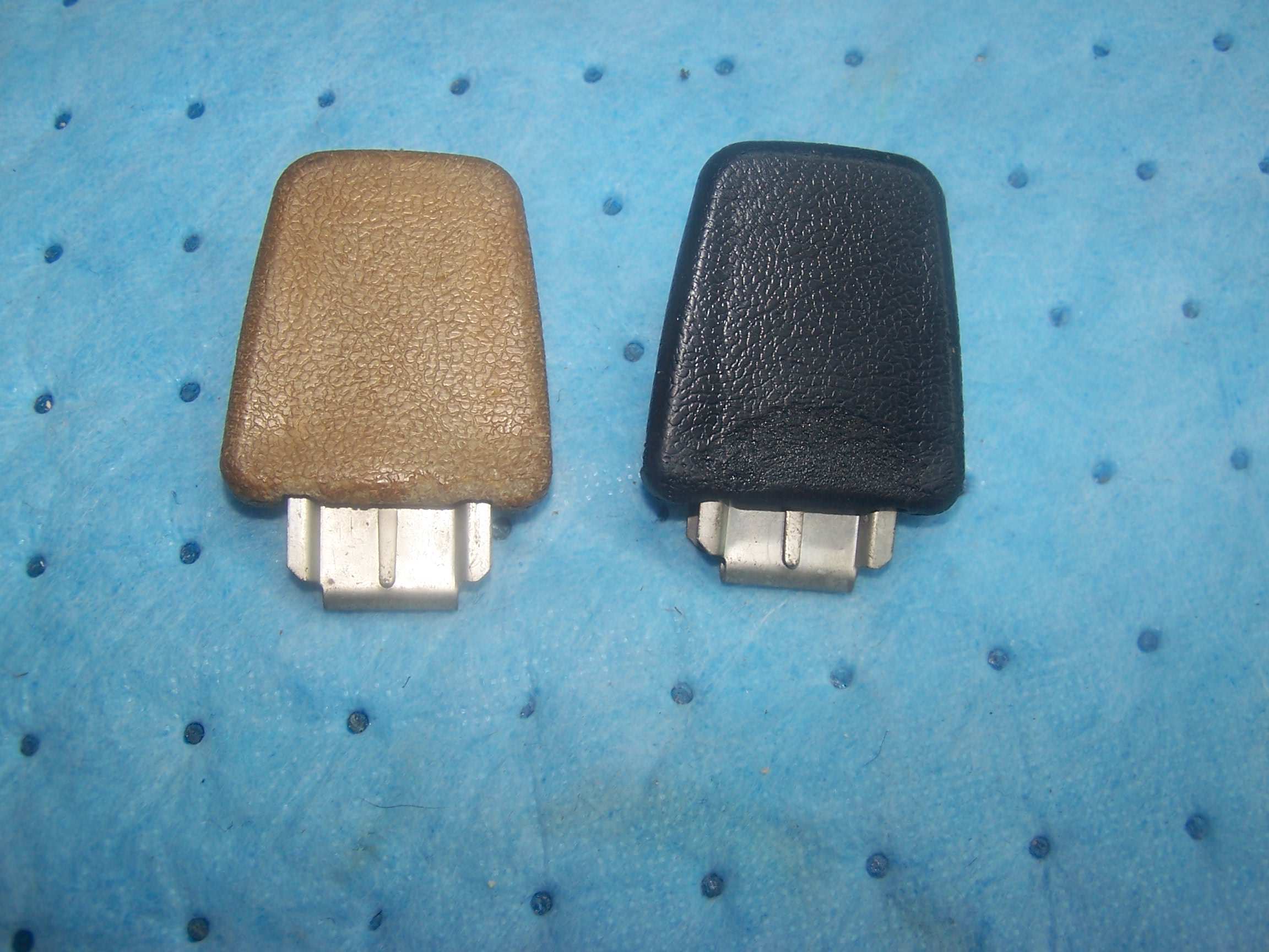

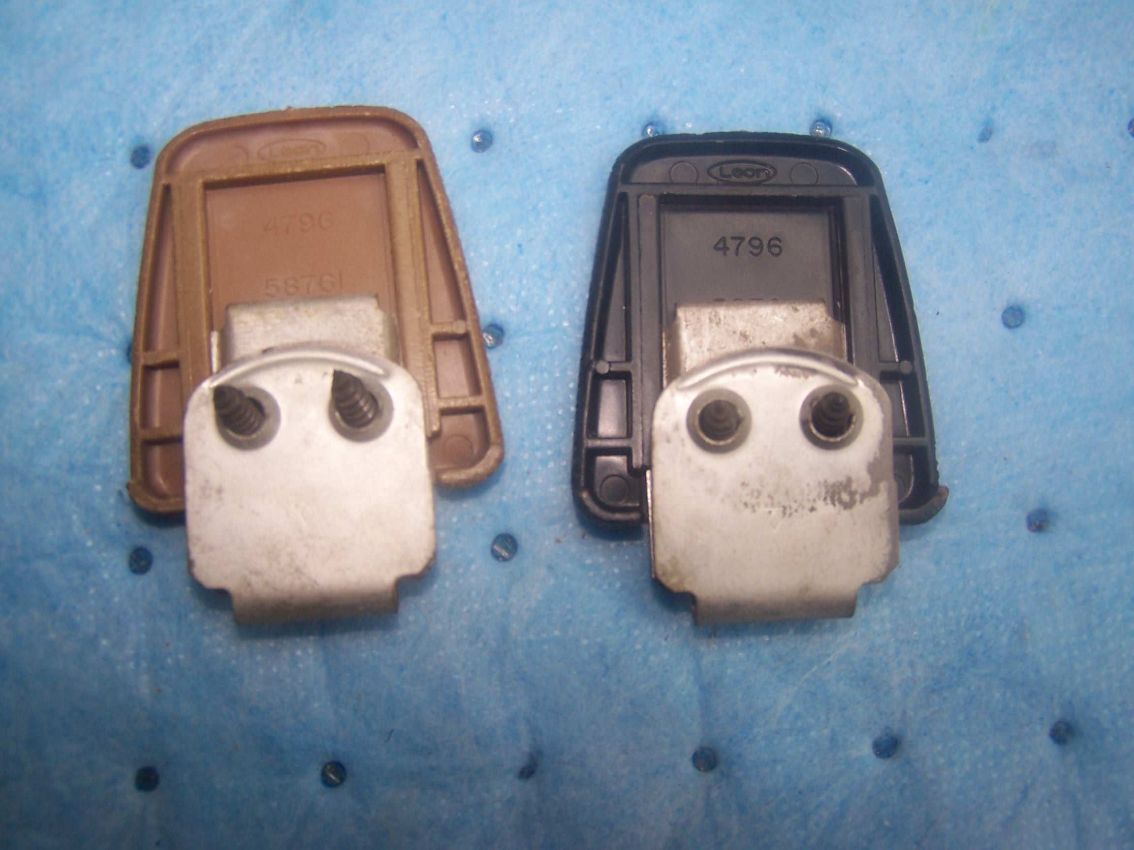

If someone doesn't have all four, I can help with two. Both clips and screws are nice but both the black and caramel covers are not the nicest ones in town. They are not broken or cracked but have some crazing at the bottom as you can see in the pic. Let me know if interested. $10.00 shipped.

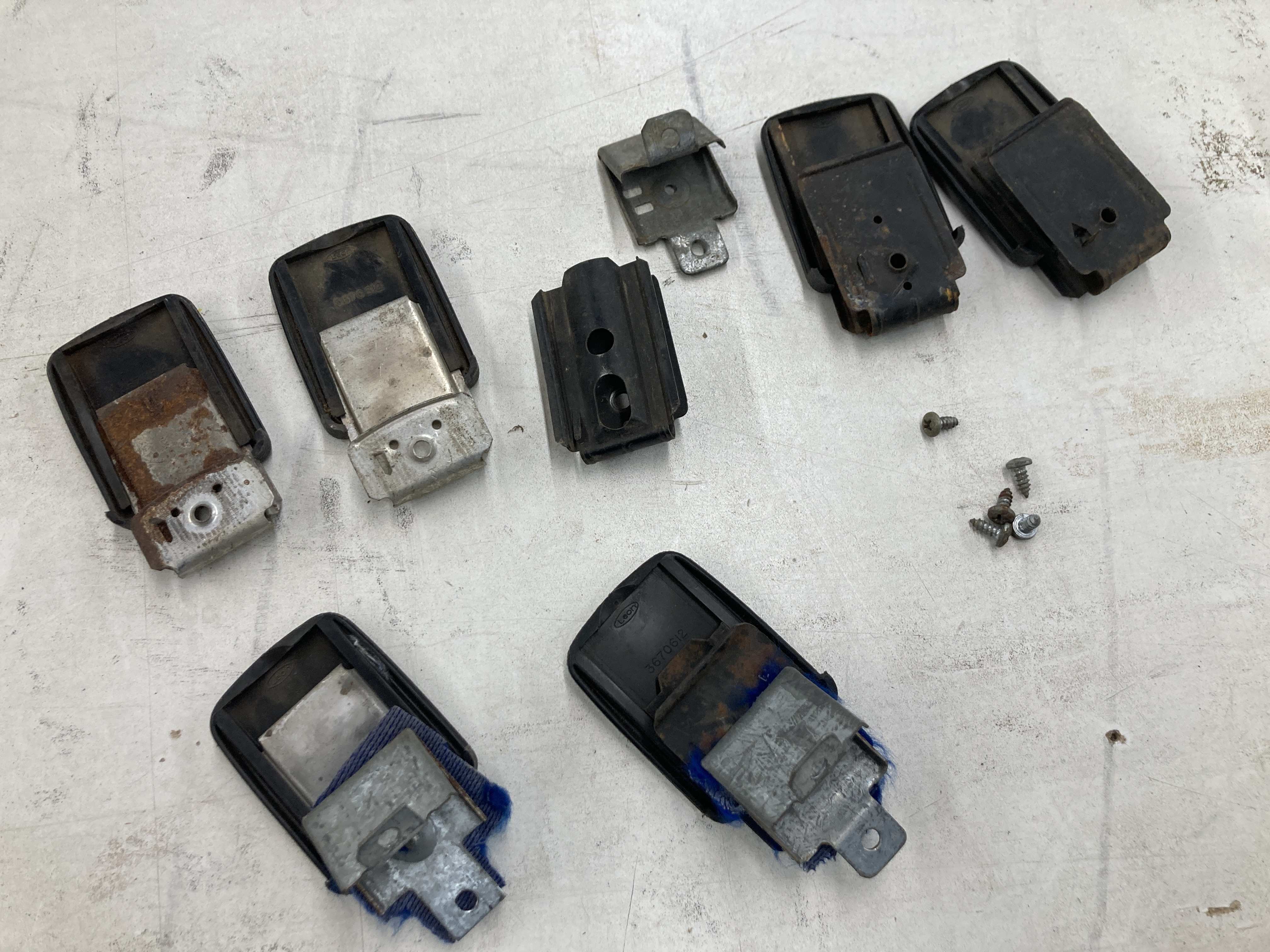

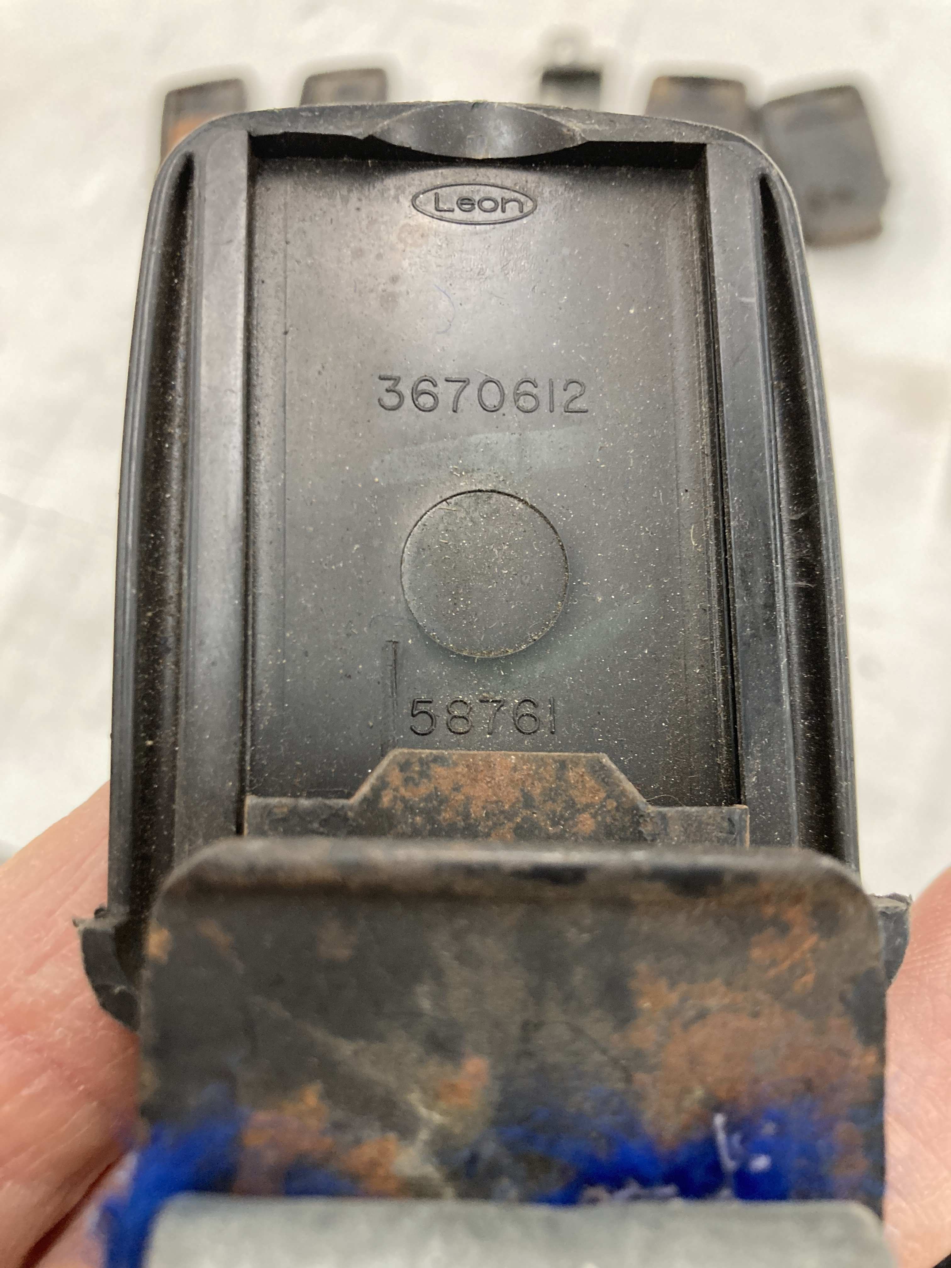

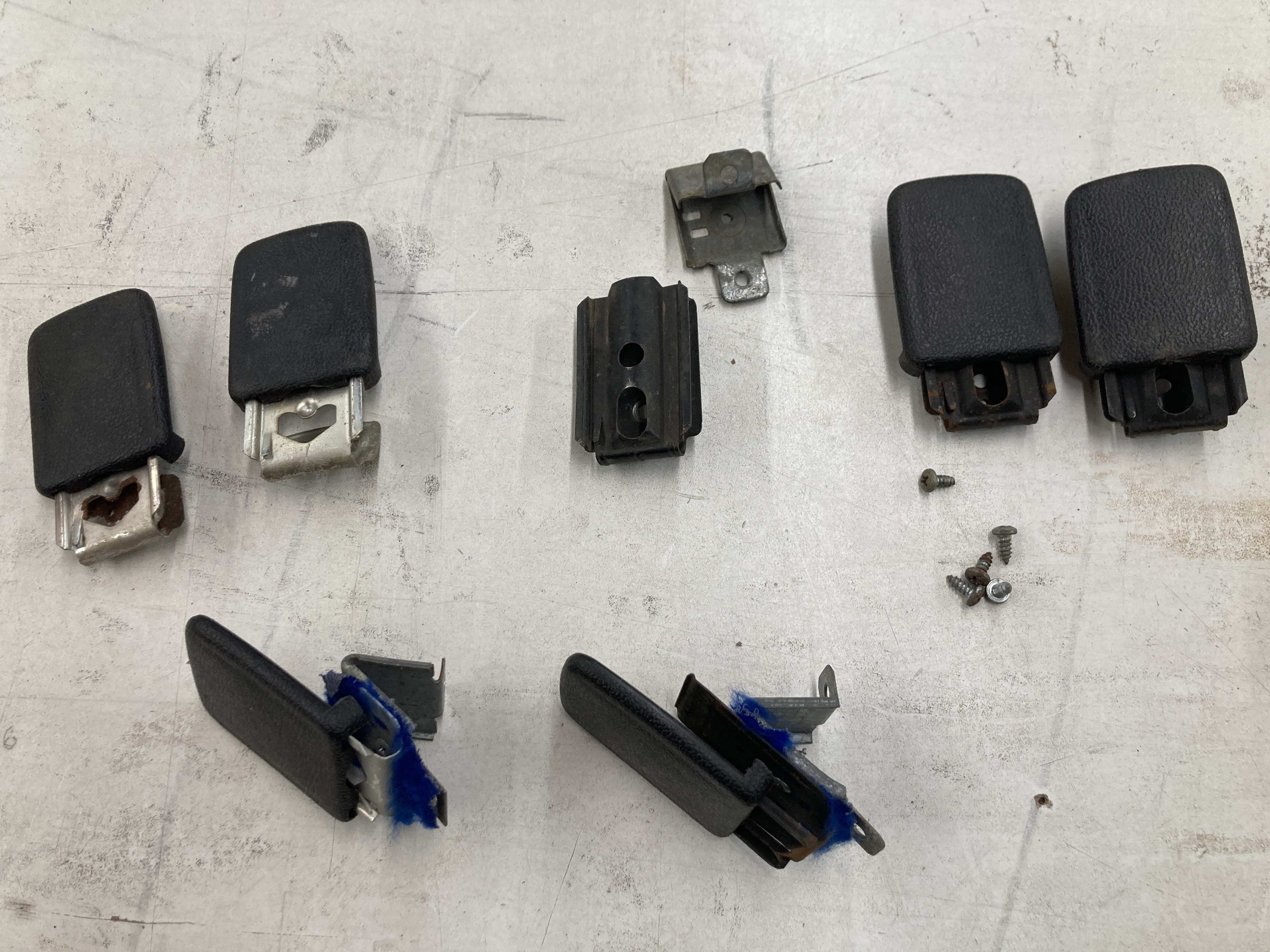

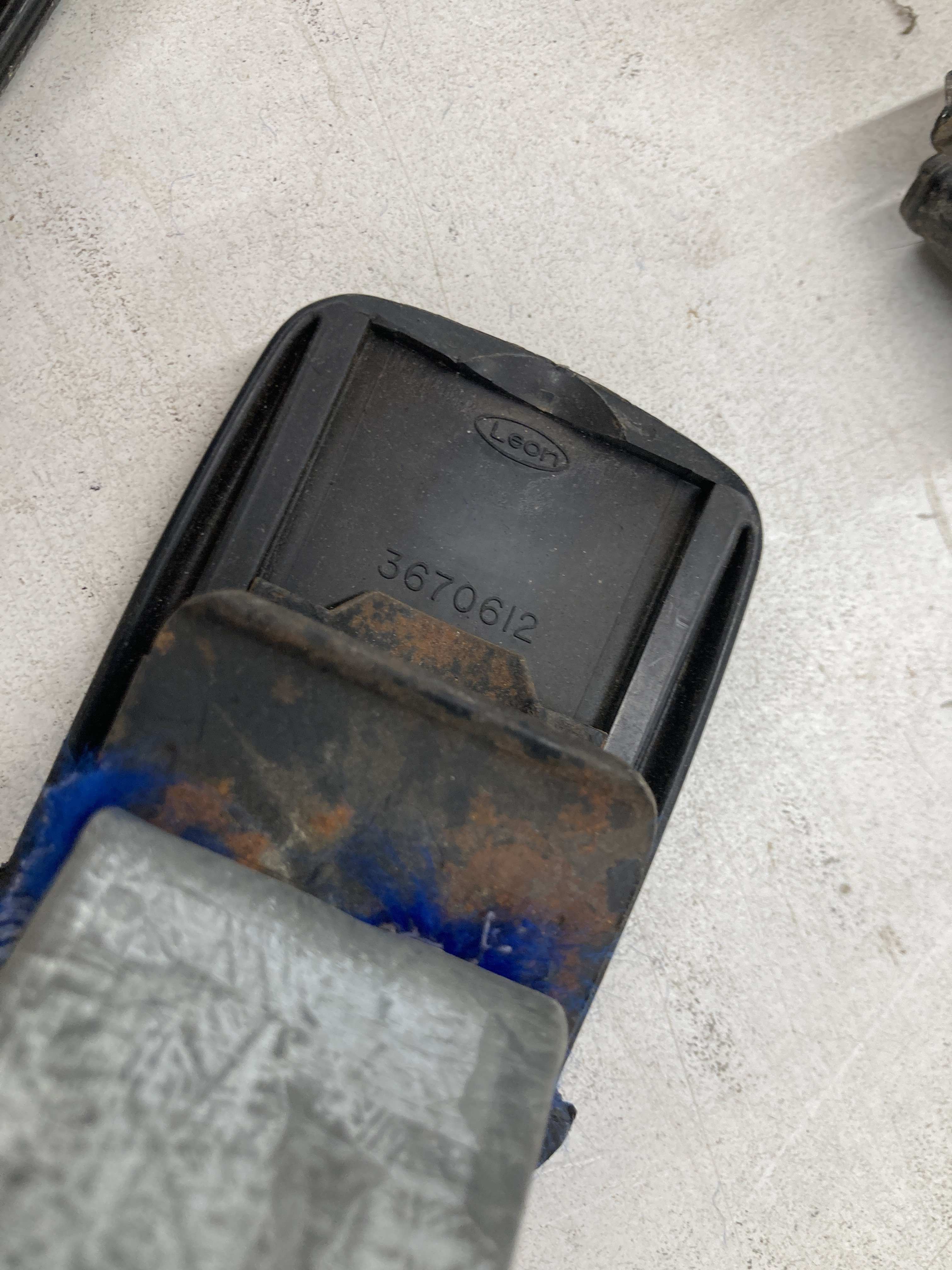

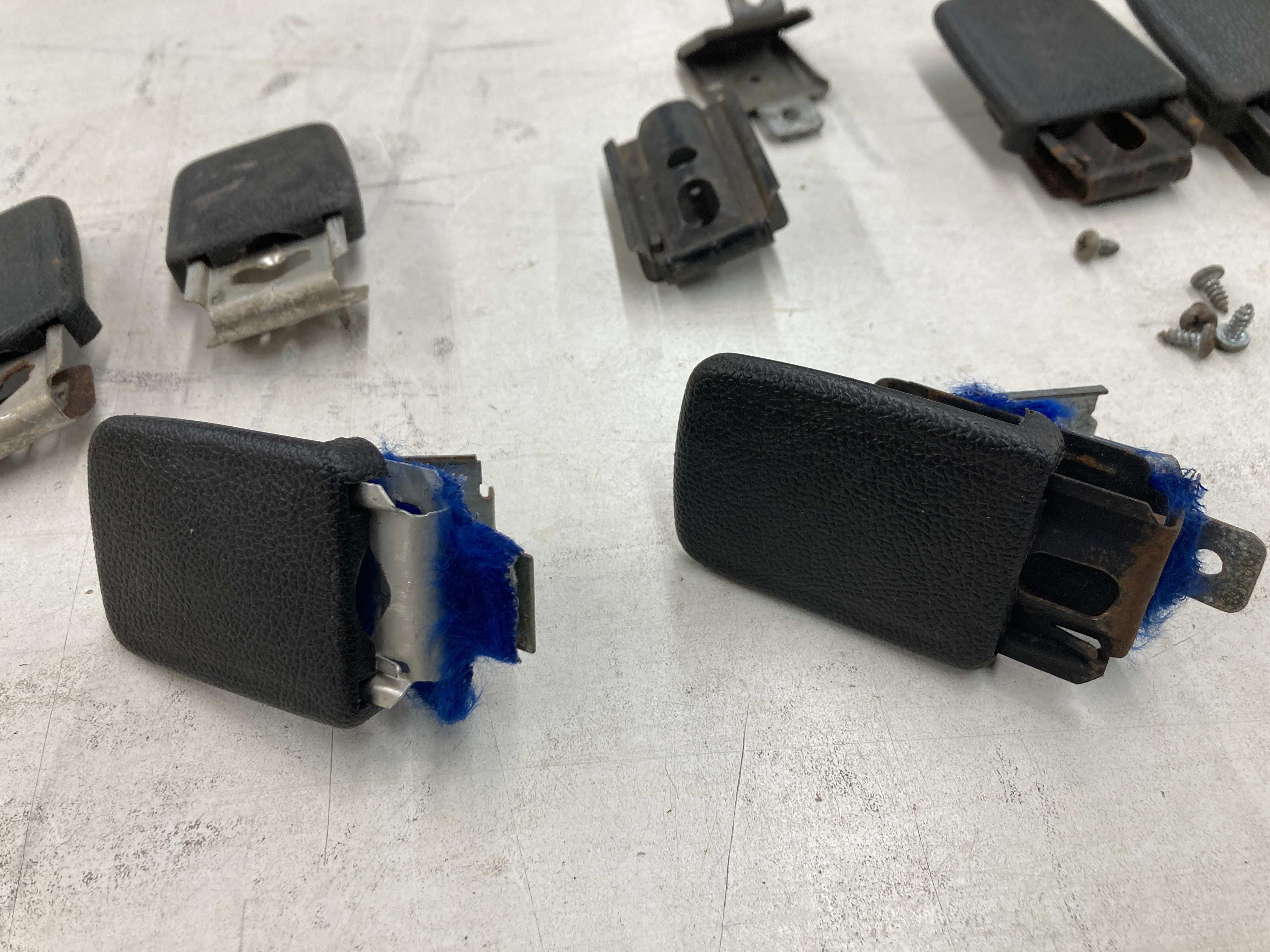

All of the ones I have have the same part number on the plastic cover, we’re in a bag marked ‘72 Cuda and came with a huge collection of parts that were 95% E-body. I did not remove these from the car myself.
They do look different from the ones pictured above and only have 1 screw to attach the metal clip.
Also shown are 2 different metal clips(3 of each) + 1 extra black metal clip and 3 additional metal mounting brackets that would attach with 2 screws. Notice the 2 in the foreground of these pics have the same crazy blue material still sandwiched in between the metal parts so that tells me they were removed from the same car. That electric blue fur headliner must have been a sight to see!
If the ones @sixpactogo posted were removed from a ‘70 E-body maybe there was a change by ‘72?
Anyway, this is what I have…

Give me a little time to research.
