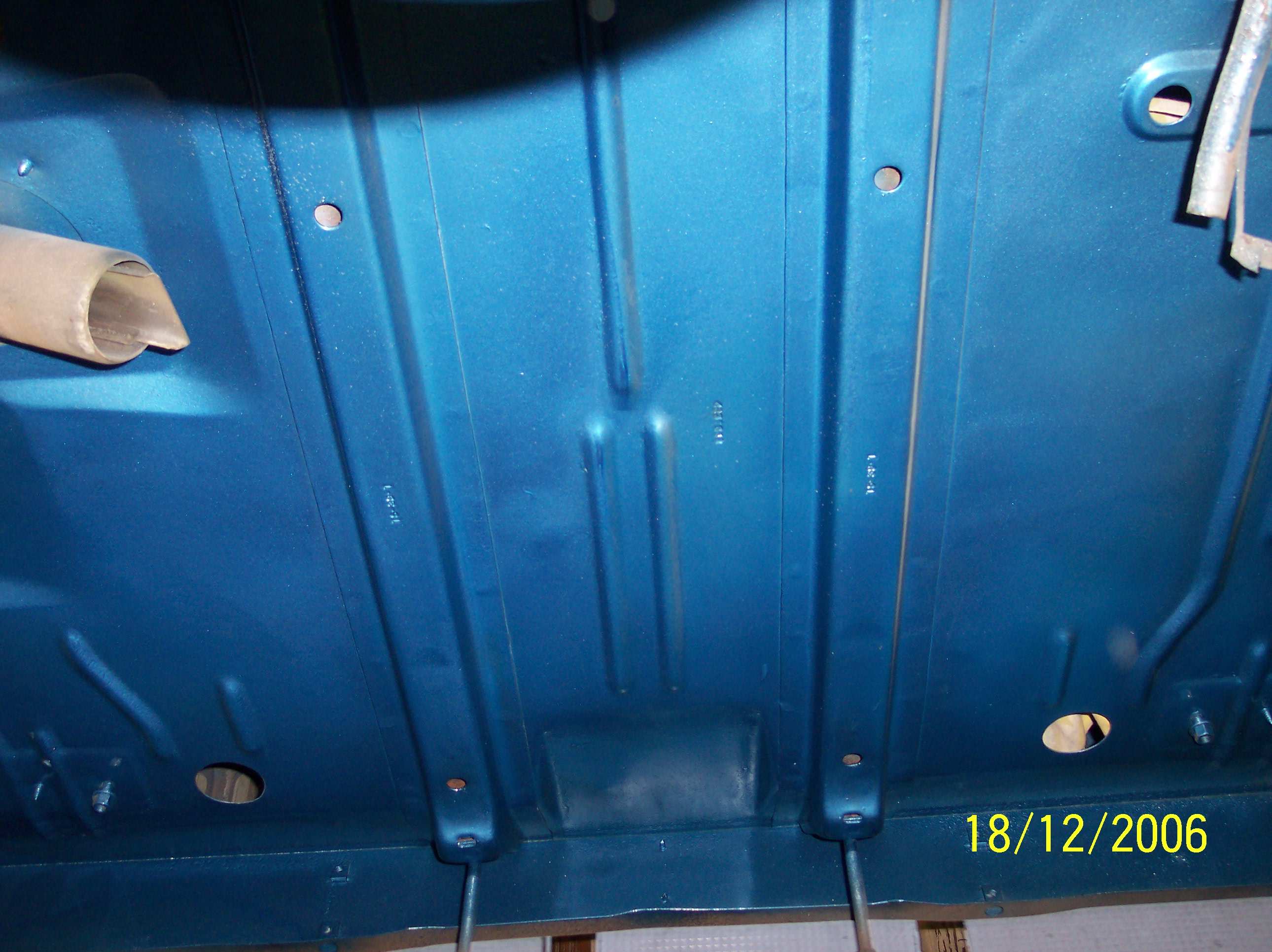

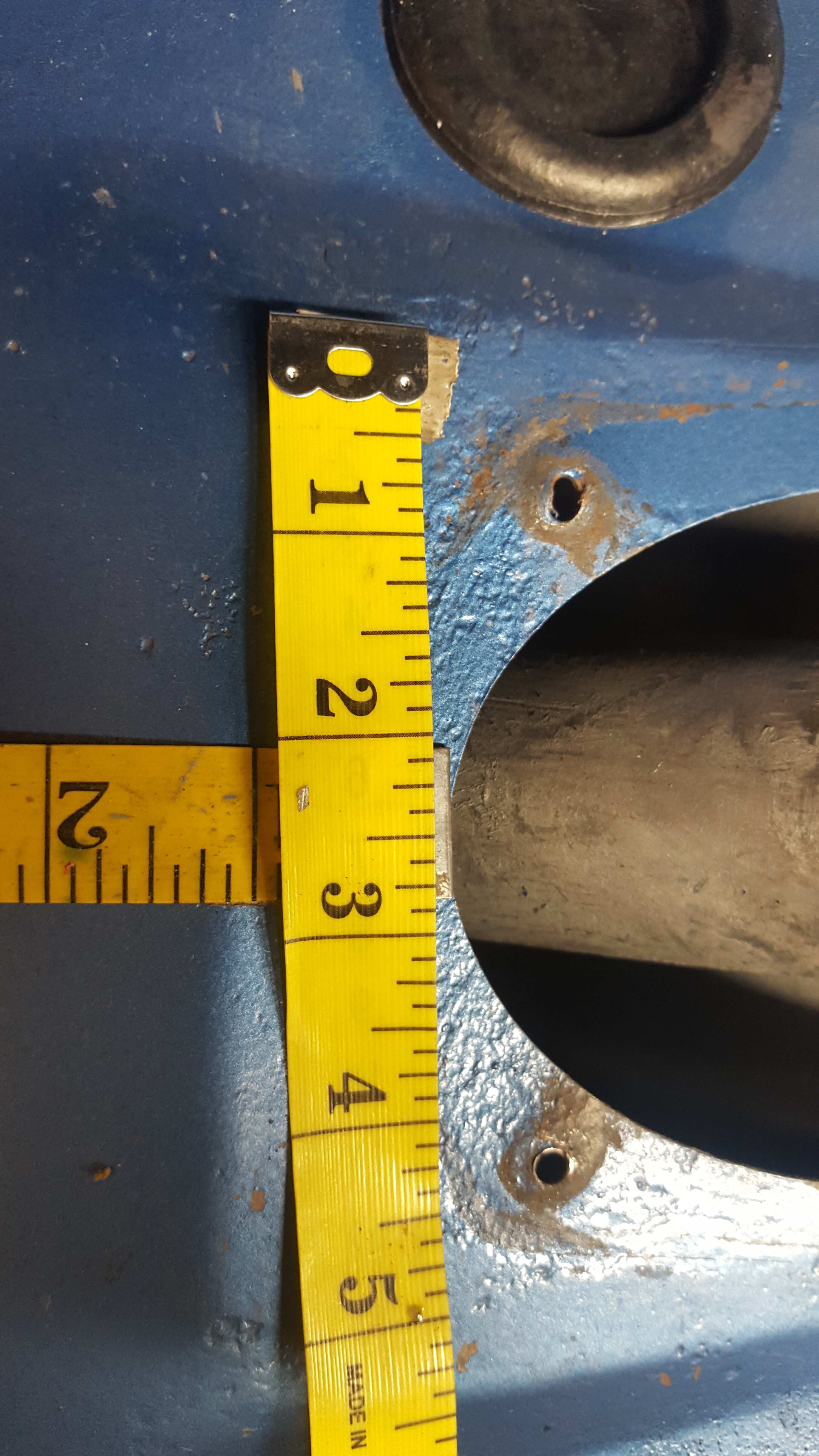

Good afternoon gents,
I'm looking for the measurements for the proper placement of the trunk floor/fuel tank braces. Also looking for the correct size hole in the trunk floor for the fuel filler neck.
Thanks in advance

Use the tube filler gasket to make a templet. As far as the gas tank straps. Measure the gas tank straps location on the tank for width placement. Someone might come up with other measurements.
