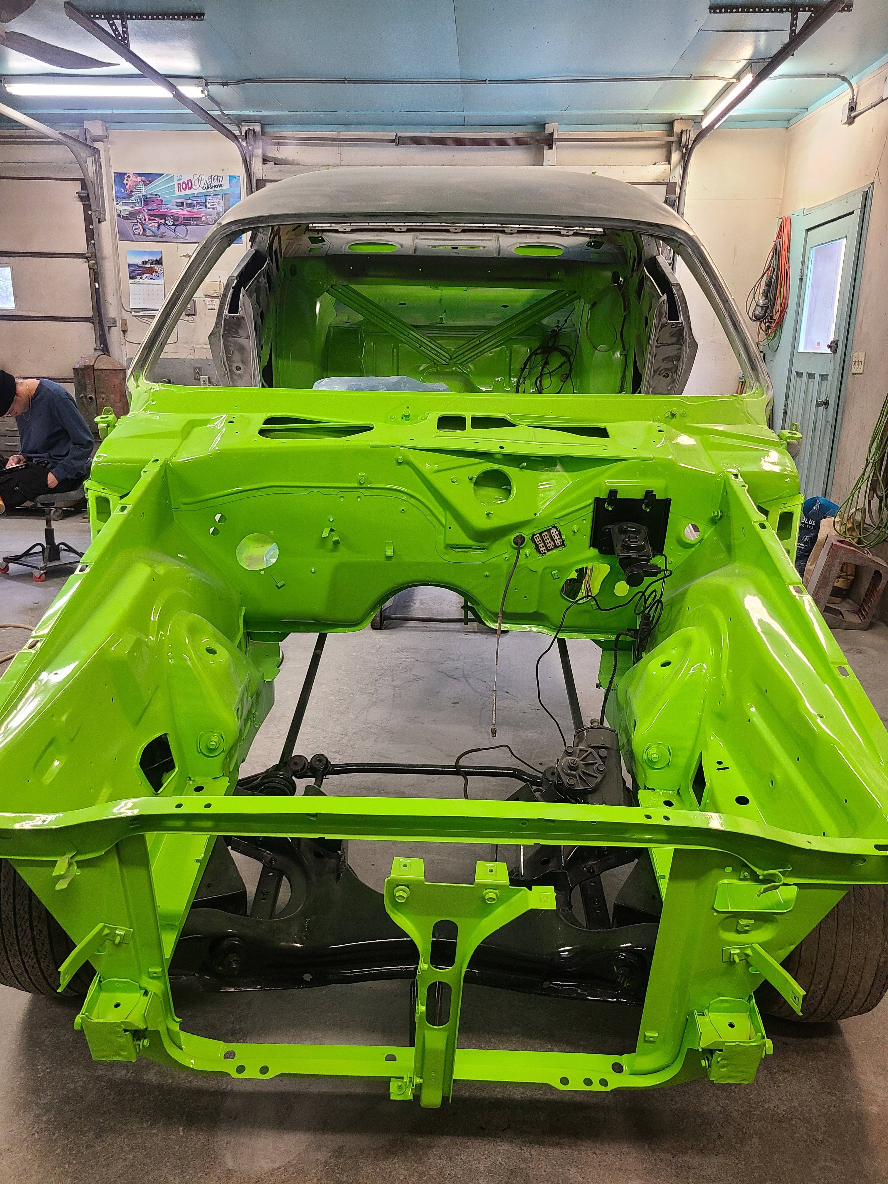

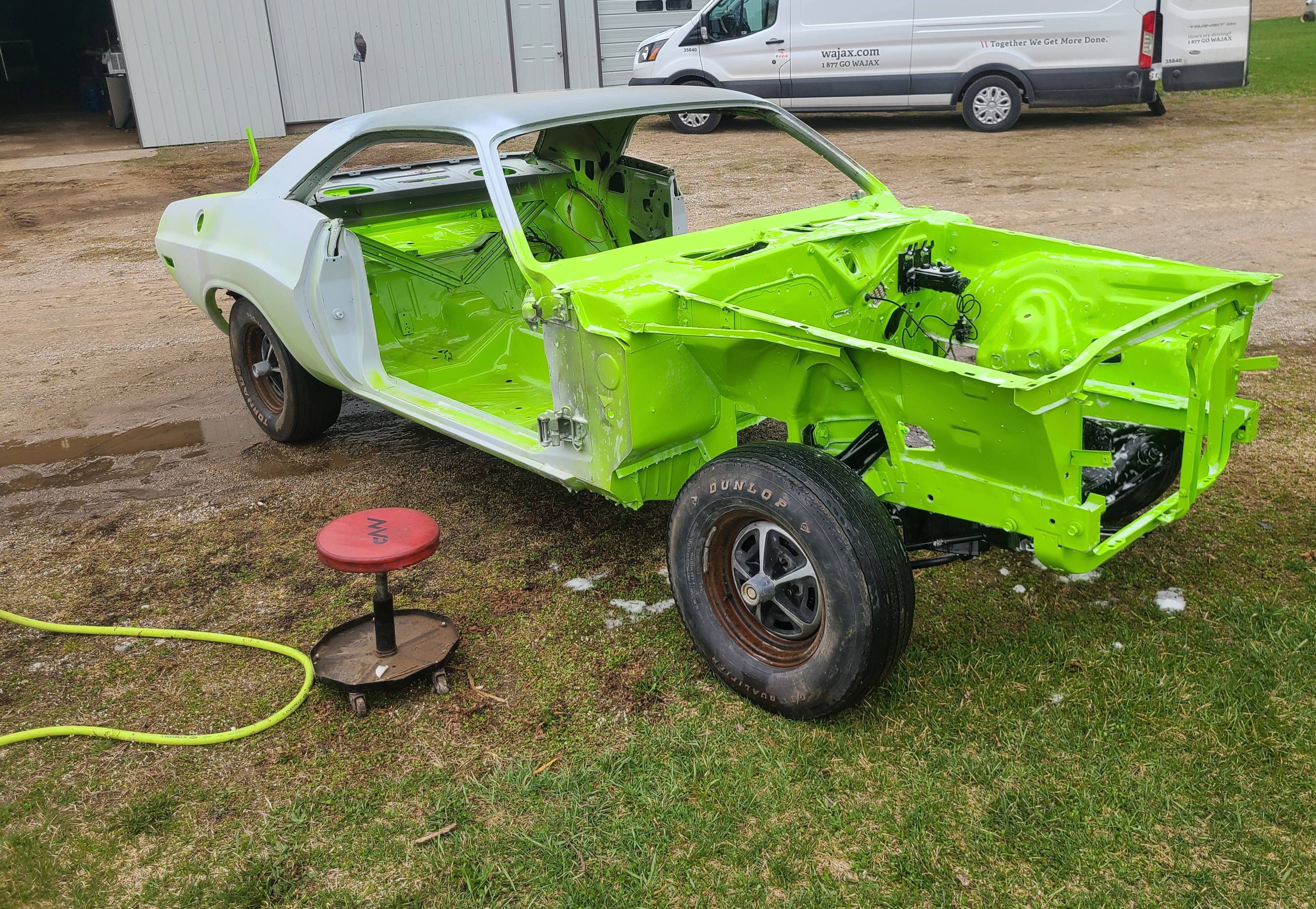

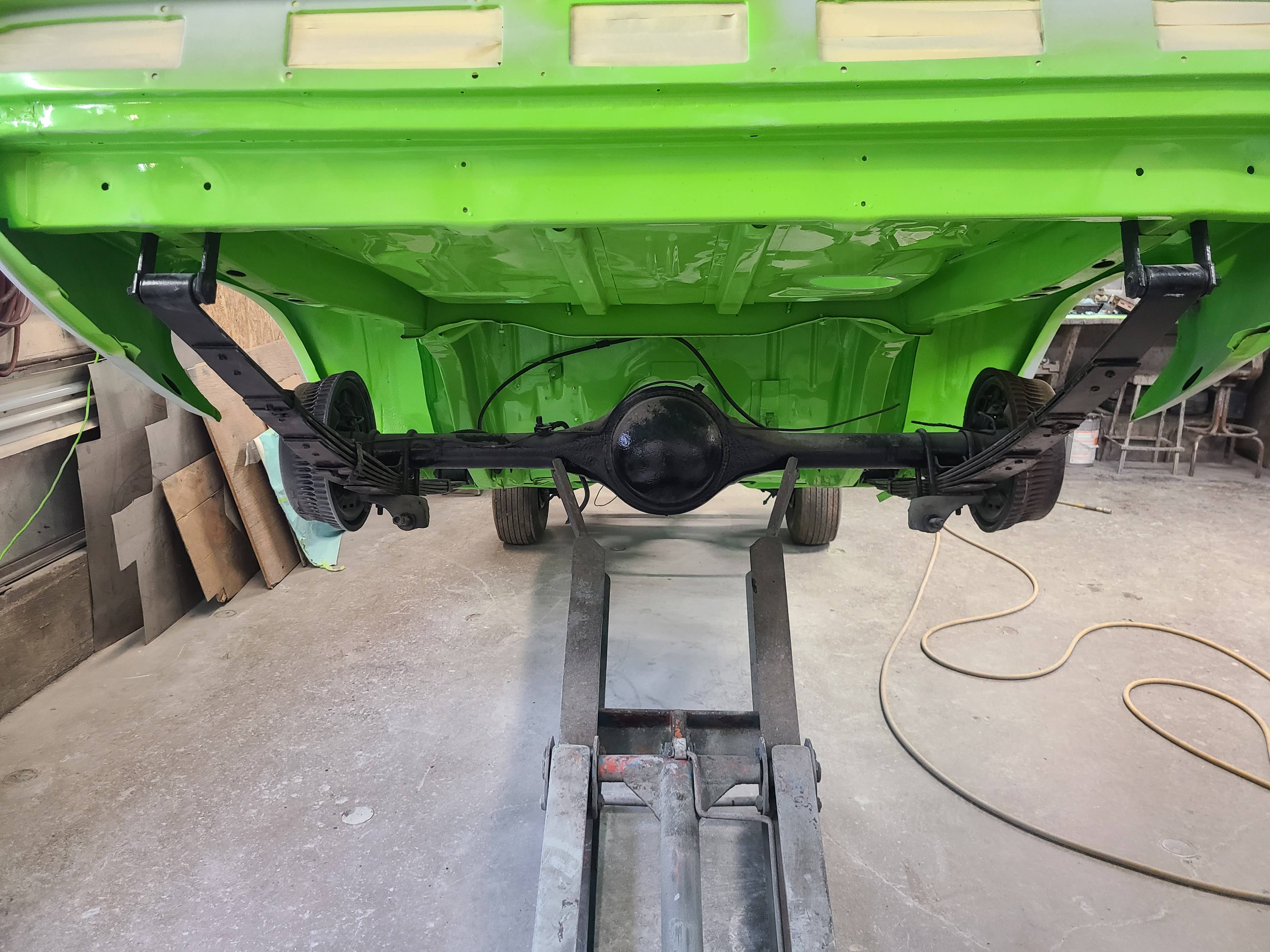

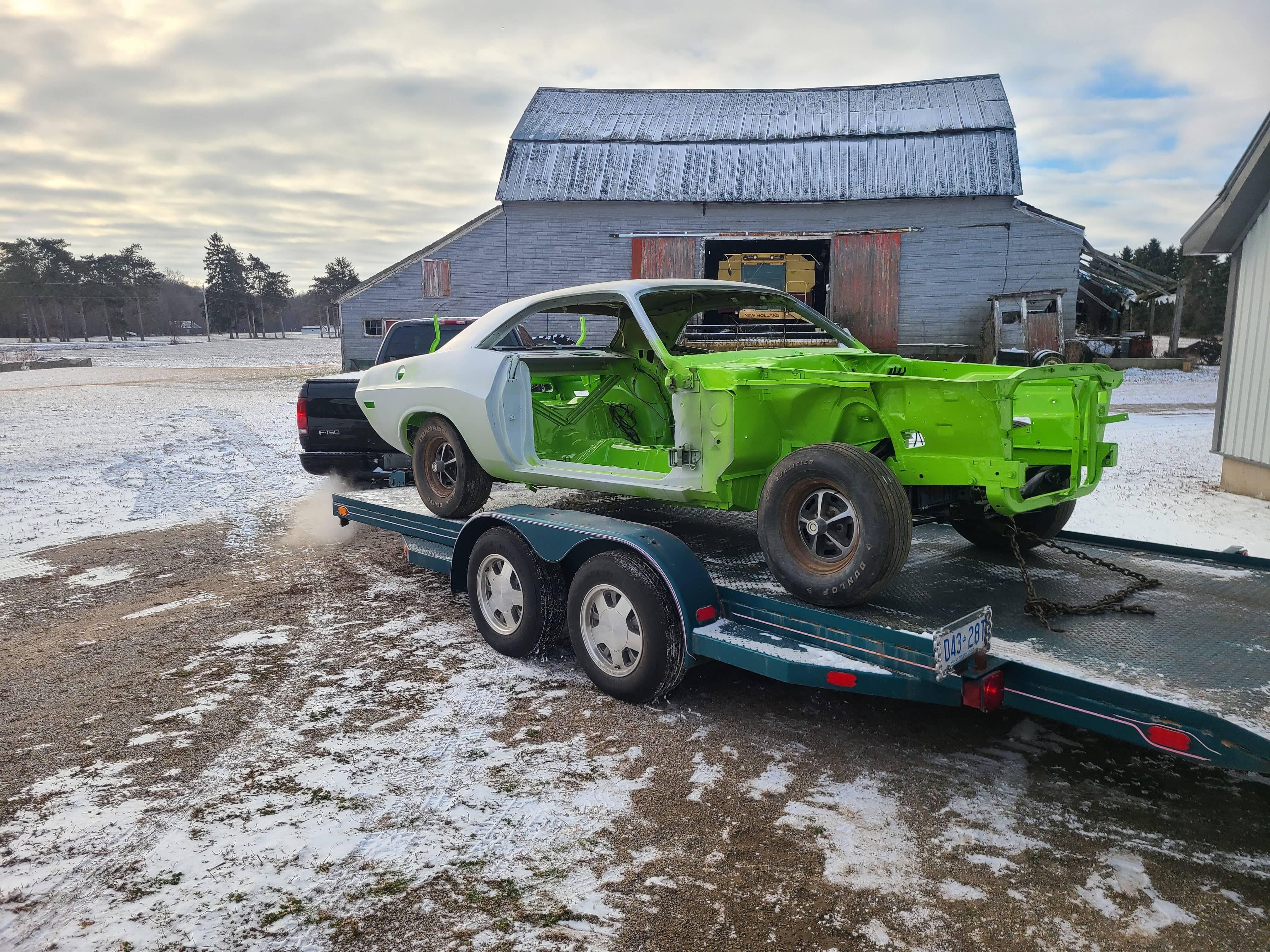

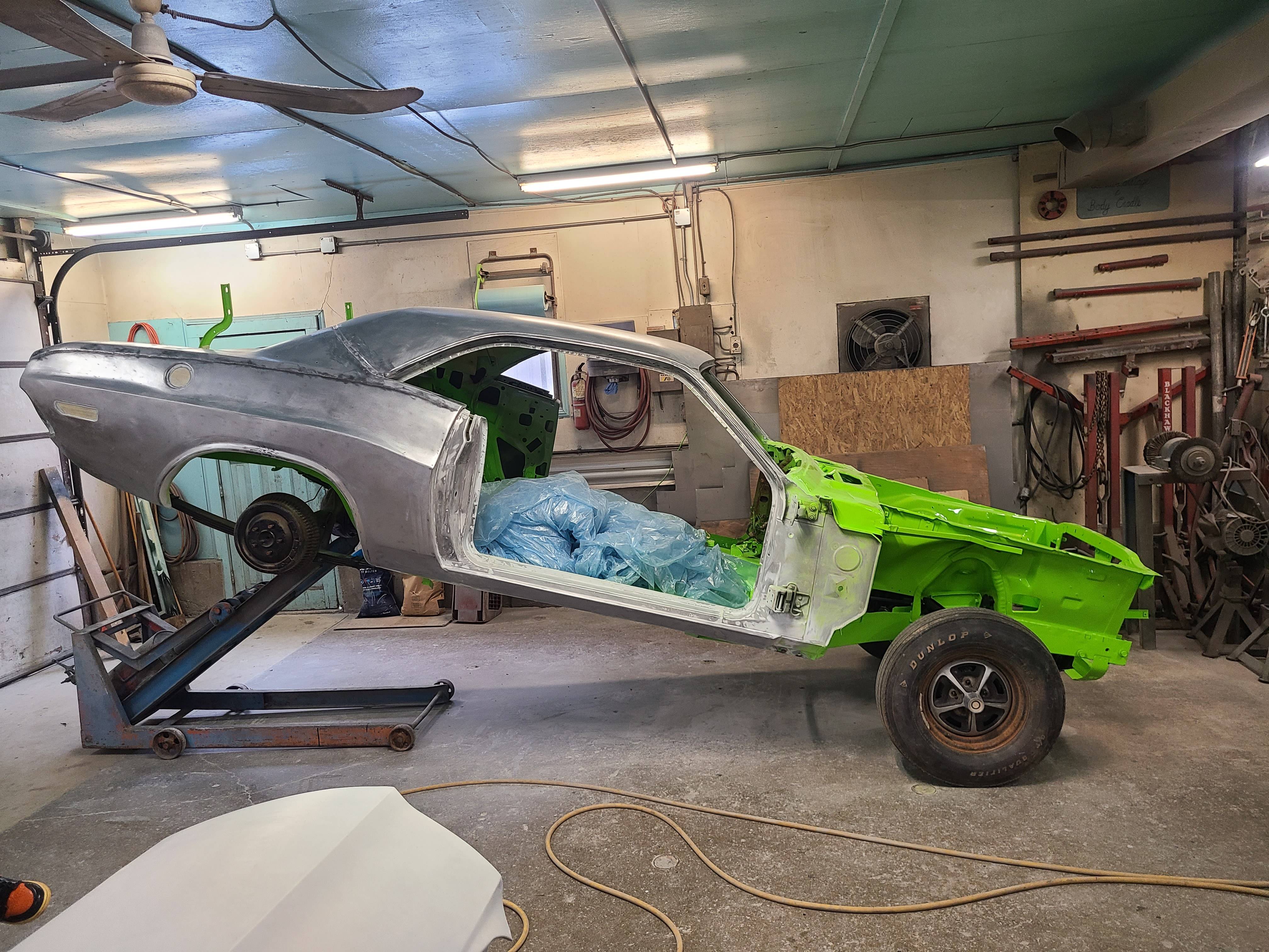

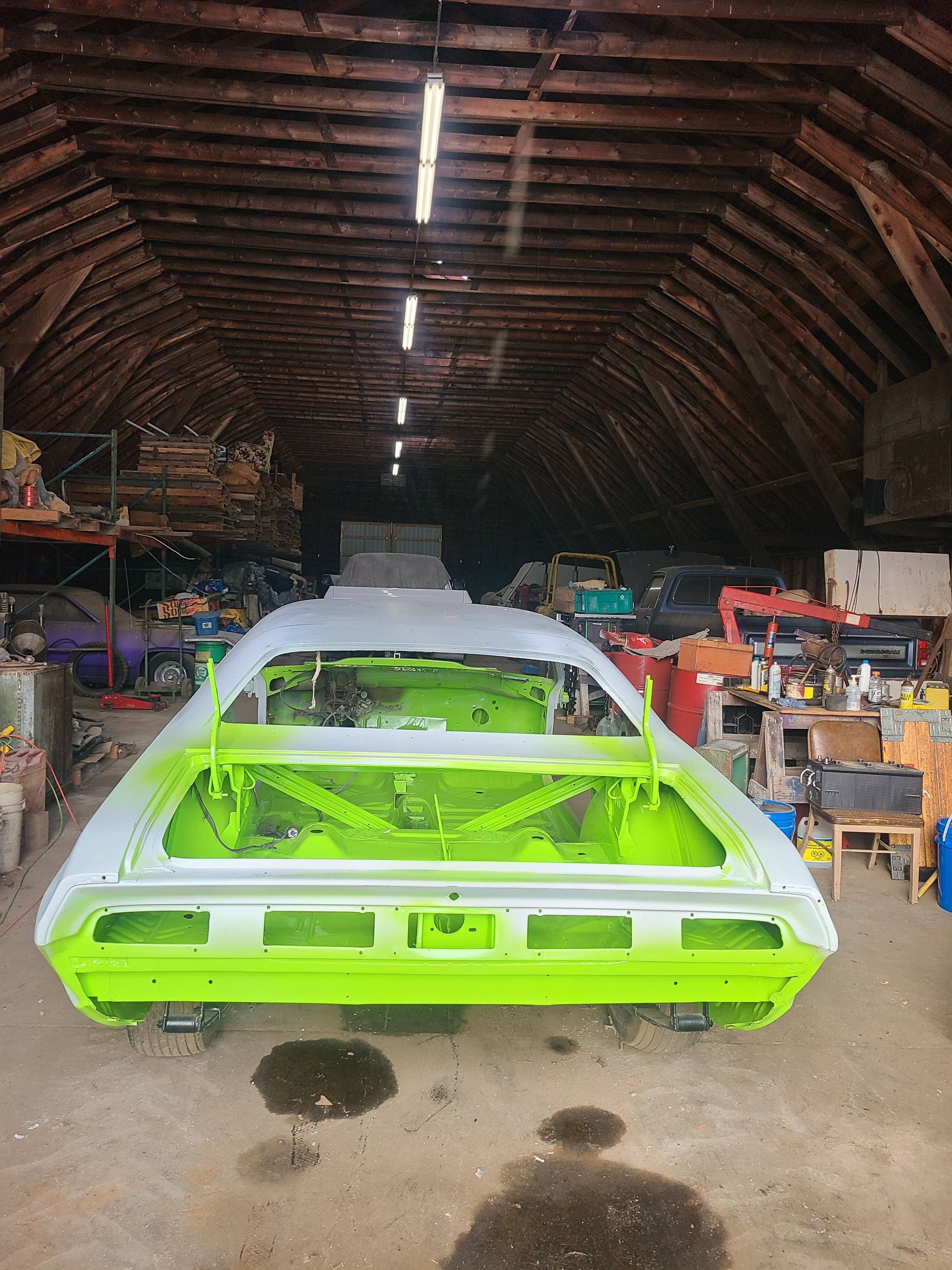

Here are some pictures of the car

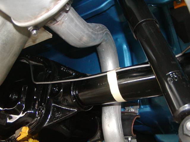

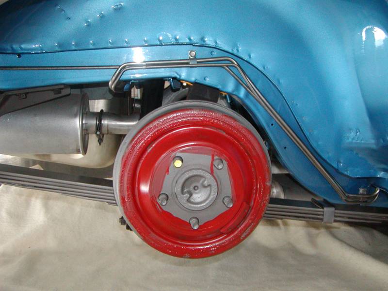

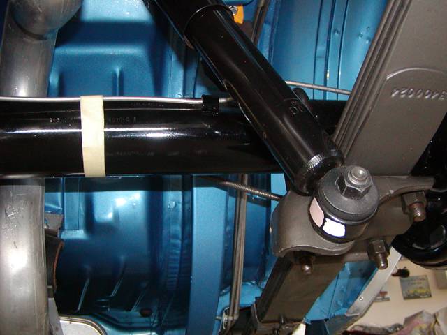

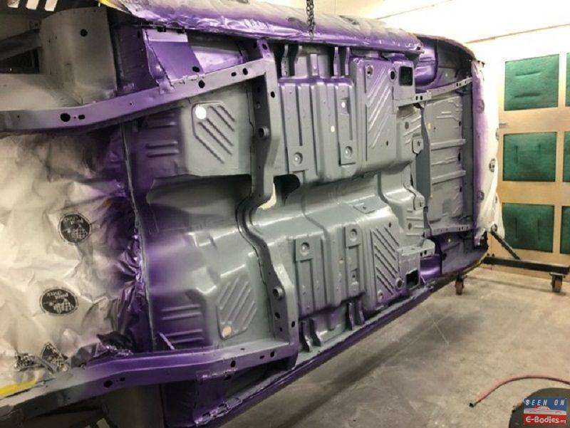

First off you paint it like you don't care. Your beyond that. Different option cars got different black out treatment. Spring , anti sway bar master cylinder lower control arms transmission natural.I spray,with cast blast. what are the detail of your car. others and myself will let you know.
look here: Painting underneath 1970 challenger and here AAR painting process question
