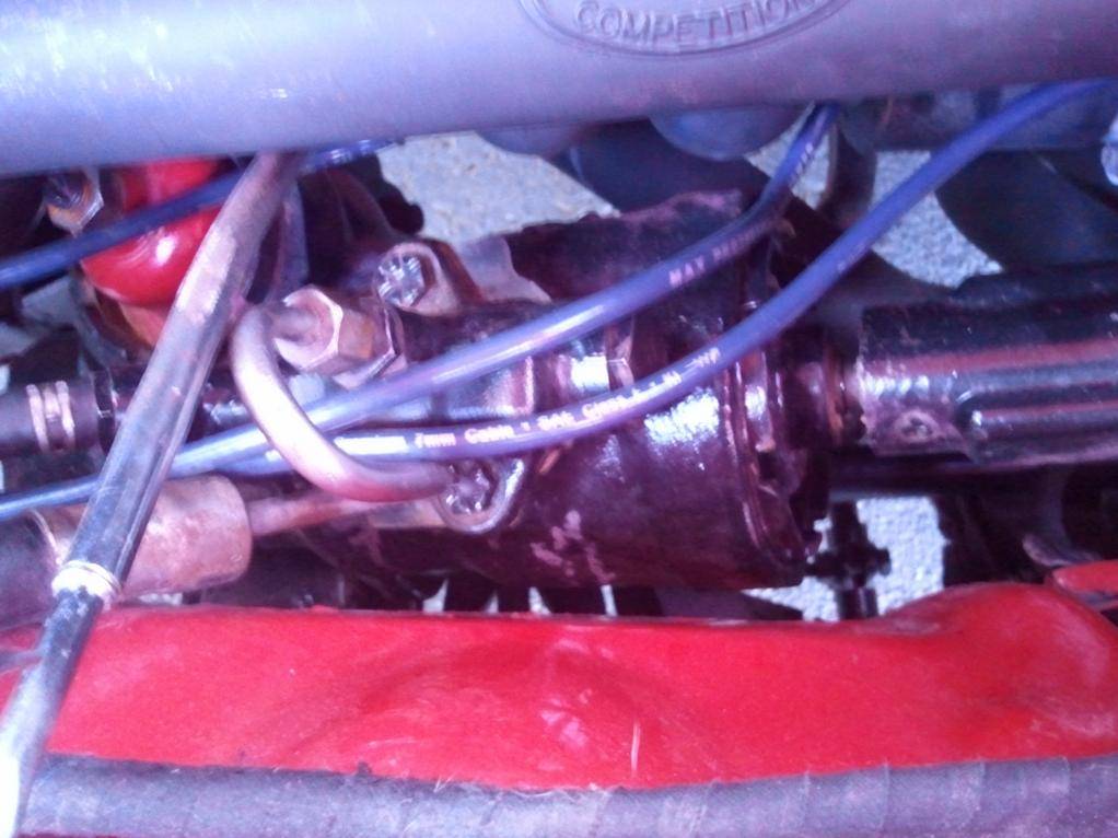

My steering wheel has a lot of play in it and when I bought the car the guy showed me a receipt of the power steering box being rebuilt. How can I make it more feel more firm? I replaced the idler arm and lower ball joints recently.

First, make sure it is the box that is loose and not the coupler. Have someone move the wheel back and forth while you look at the coupler and steering box. Hood open naturally. If the movement is in the coupler, rebuild kits are less than $30.00, if it is the box, there is a slotted shaft with a lock nut to adjust play. If the shaft sticks out with several threads showing above the lock nut, you can adjust it. If there are none or only a few threads exposed, its time for a rebuild/replacement.

If the shaft is moving around with a lot of play, it is probably atleast going to need the bearings replaced, but really if its that bad, you need a new box. If you have a receipt for the repaired box I would see if there is any warranty left on it.

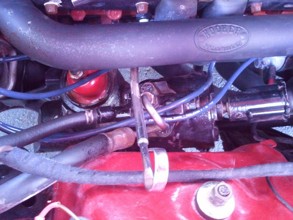

Pictures
Here are some Pictures.
