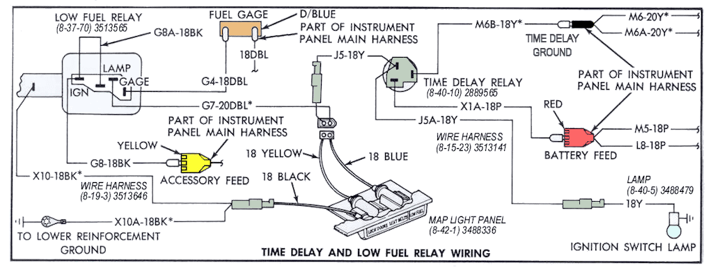

Starting to put wiring into place.... Looking for a clear diagram of the low fuel wiring for an overhead console. I have the lights and Ajar switches, but not the fuel wiring. The DBL connector is somewhere in the middle of the drivers seat. Rally gauges, 440 Cuda with a consollete - Thanks in advance

I have this schematic on my computer.

Thank you but this does not match up with what I have
Sorry, I saved that picture a long time ago before scrutinizing it. I thought it'd be close enough for an E body. I believe it's for a B body because there's no seat belt bulb shown in the "map light panel". Owning a convertible I personally never had reason to look closely at it.
