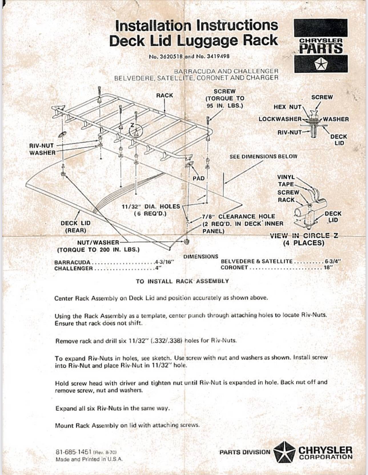

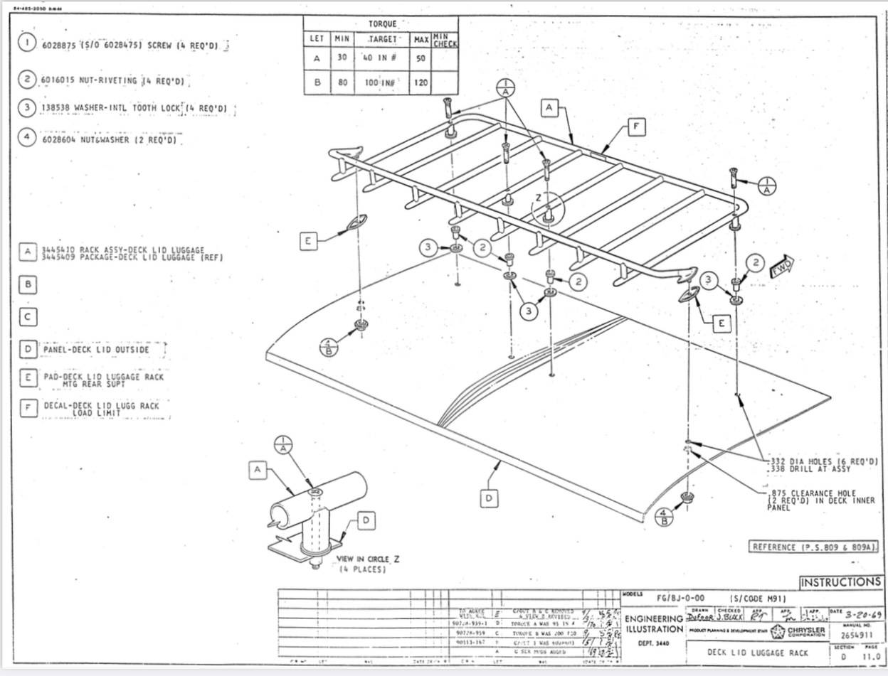

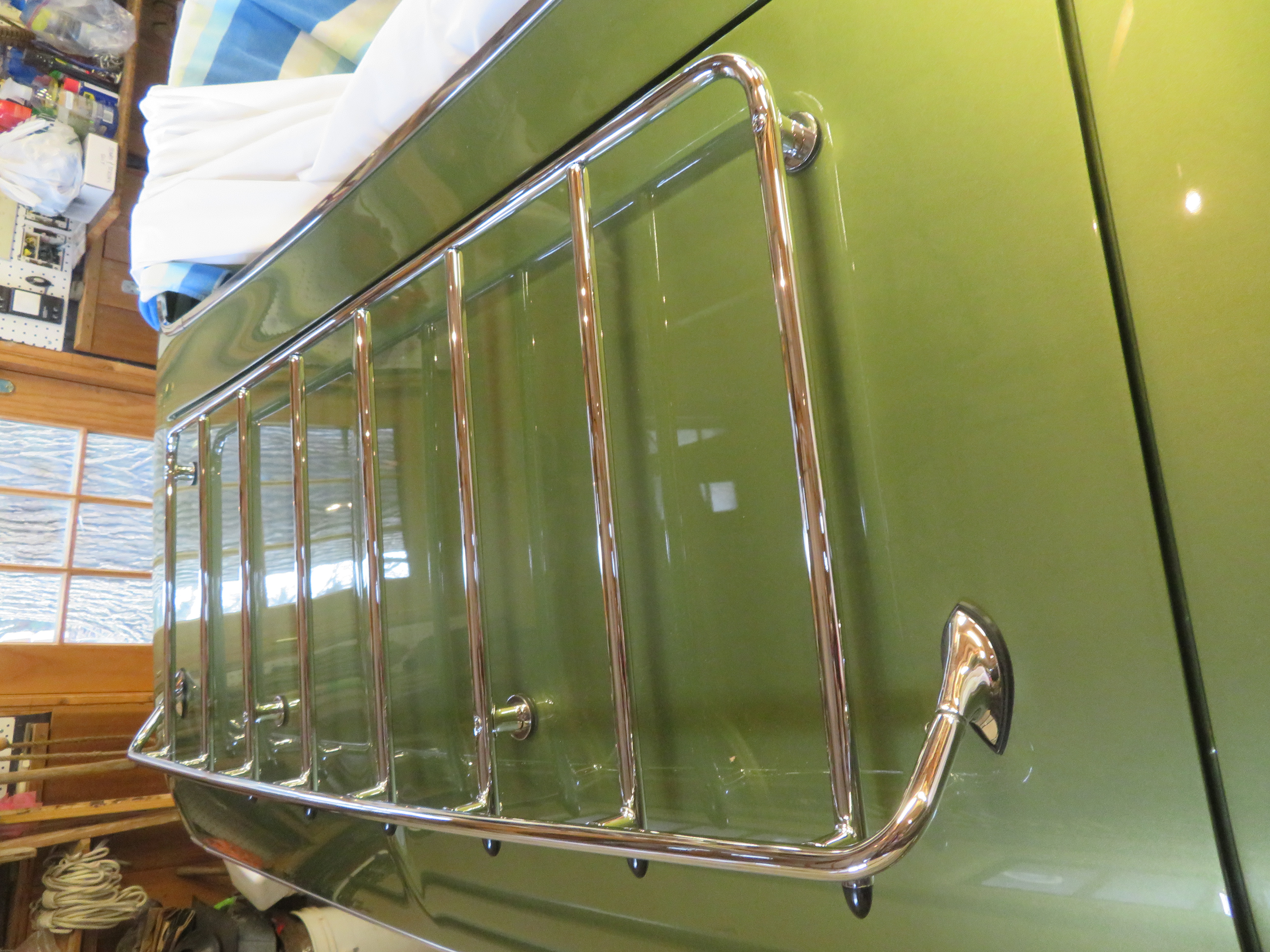

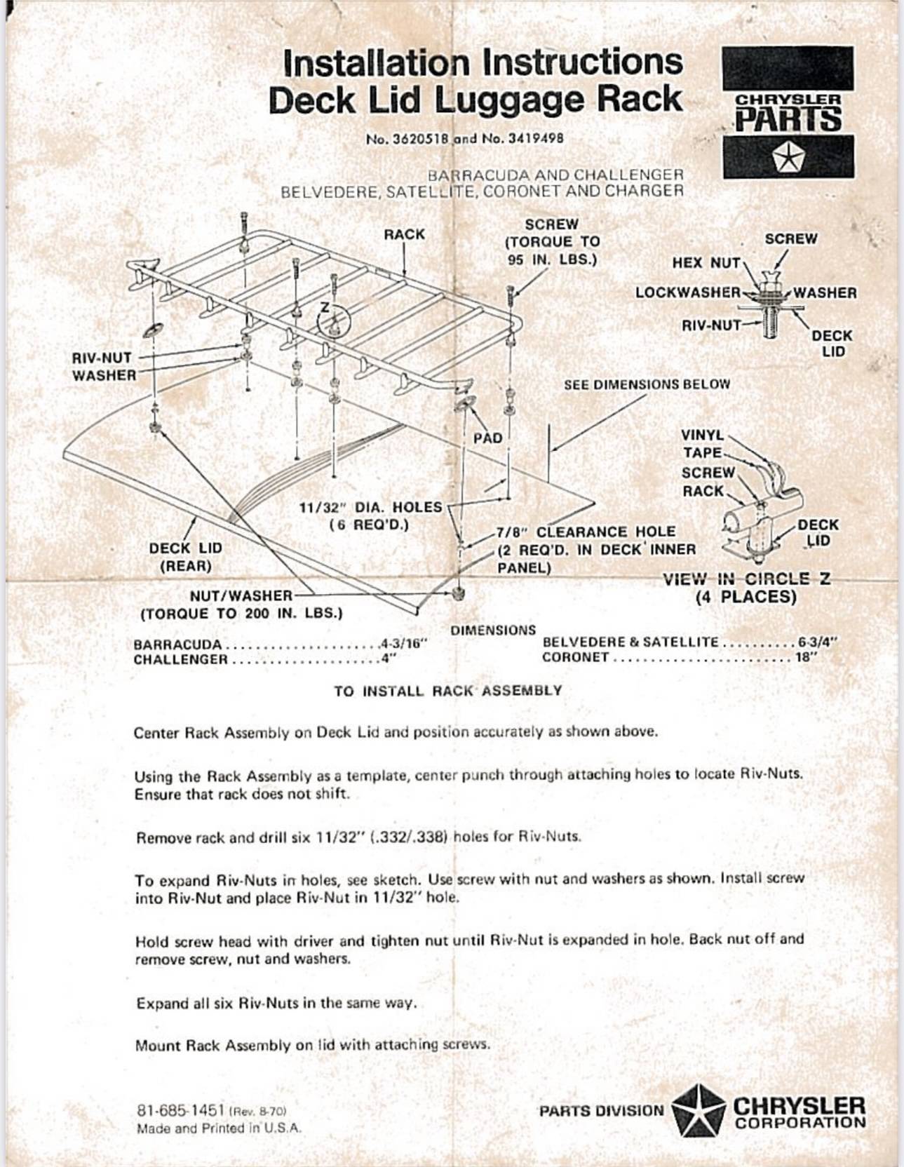

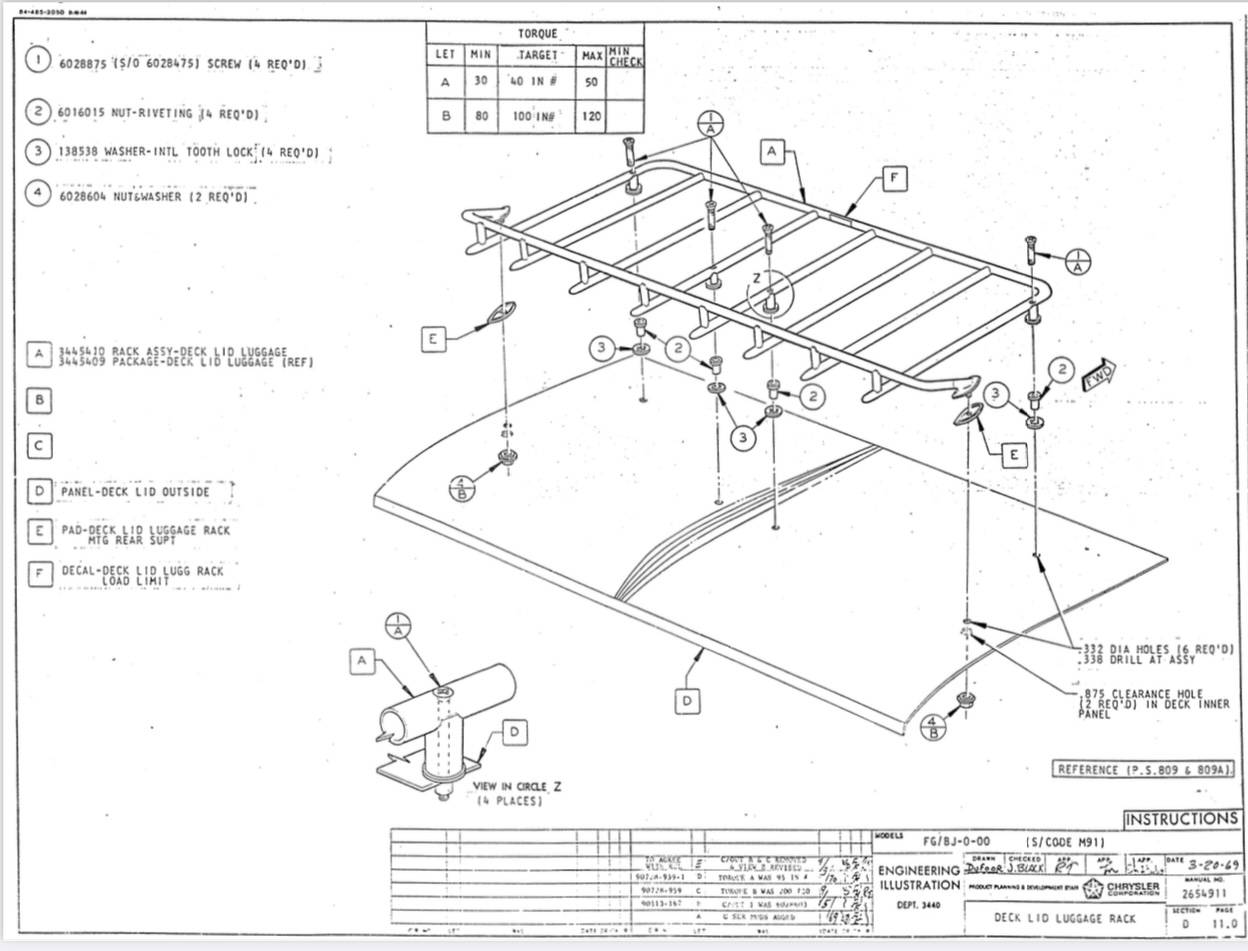

Anyone have know where I can locate the factory specs on the luggage rack install, ie: location of the holes. My 70 Cuda had a rack originally and my plan is to reinstall what it once had. Any thoughts would be appreciated.

As I recall it is pretty obvious , the 4 holes line up with the holes in the frame under the skin , I have looked at & worked on a number of them over the years

Thank you, Mopar Nut. This is exactly what I was looking for!!
