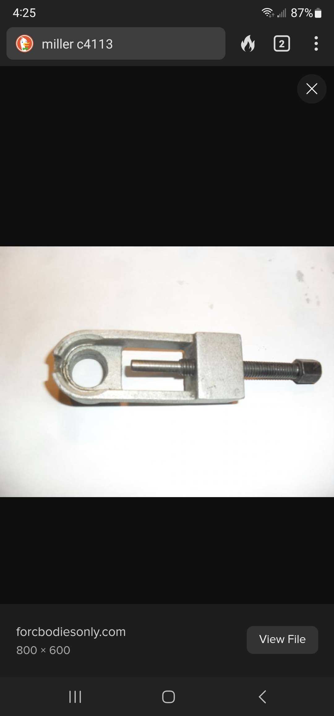

I am wondering if anyone could help me locate a Miller C-4113 tool for removing the retaining pin that holds the steering wheel locking ring in place. All leads and help is appreciated. FYI I tried a punch already and it's a solid pin not a roll pin. Thanks.

I have a solid dowel pin retaining my lock plate. Has anyone been down this road? I am working my way down to the ignition switch. Is is better to try to find / fabricate a miller c4113 tool or try to tap it out with a hammer and punch? Is there something close to the c4113 you can buy? Thanks for your advice / guidance.

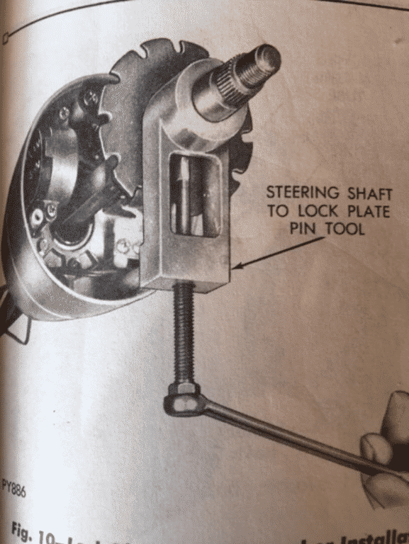

Do you see how the shaft is out in #3. If you take shaft out. It can be knocked through with a drift pin on a solid surface. Don't use a tapped drift pin.

If I wanted to do it “in place” would you go the same way? I had done some tapping prior to my post. It seems like it will take some reefing to get out. Thanks again!!
