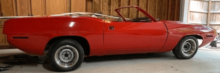

I am restoring a 70 Cuda. I have the correct Vin plate matching my title, but the trim plate was missing when I bought the car, also no broadcast sheets. There was no interior in place it was basically in pieces. I'm trying to figure out what it was originally. VIN plate says it's a FE5 Rallye Red, it's supposed to be a 318 car, but has a 440HP / 6 barrel and 727 Torque-flyte trans. It is a Convertible car so that's a good thing, but not sure what color top it is supposed to have or the color of the interior or carpet. I guess it will have to be a resto -mod. Is there a place that would make me a trim plate to match what I put into the car or should I keep researching to find the original info not sure what to do.

The only thing I have is the title and the VIN plate on dash no other info. I'm not sure what was originally on the car b/c I got the car w/o interior although the seats that came with it are bronze / brown combination. and a brown dash. w/brown carpet. I guess that's what the prior owner was going to put back into it. The car was being restored when I got it Motor, trans, rearend were all attached with new paint and new front fenders and rear quarters. I was just wondering if I could have some fender plates remade to match was it is now to make it look more authentic.

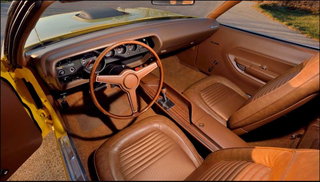

Interior in H6T5 - Tan

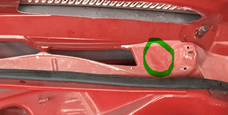

Your cowl partial VIN is found here. Likely starts with B0 _ _ _ _ _ _ and it looks like somebody dusted it off already. :D

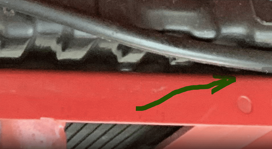

Your radiator partial VIN is here between the radiator and the radiator support on the vertical face.

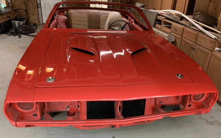

Thanks for the help and extra info mine looks very close to this except I have a Rallye Instrument panel. vin number -is BH27G0B114716. It's in the shop having a new Convertible top installed I will send new pictures when I get it back.

My vin is BH27G0B114716 I have no idea what the original interior color was. The seats I have are Brown and Bronze combination as seen in the pictures I sent when I first joined FEBO.I was never given the original Fender tag with this car.
