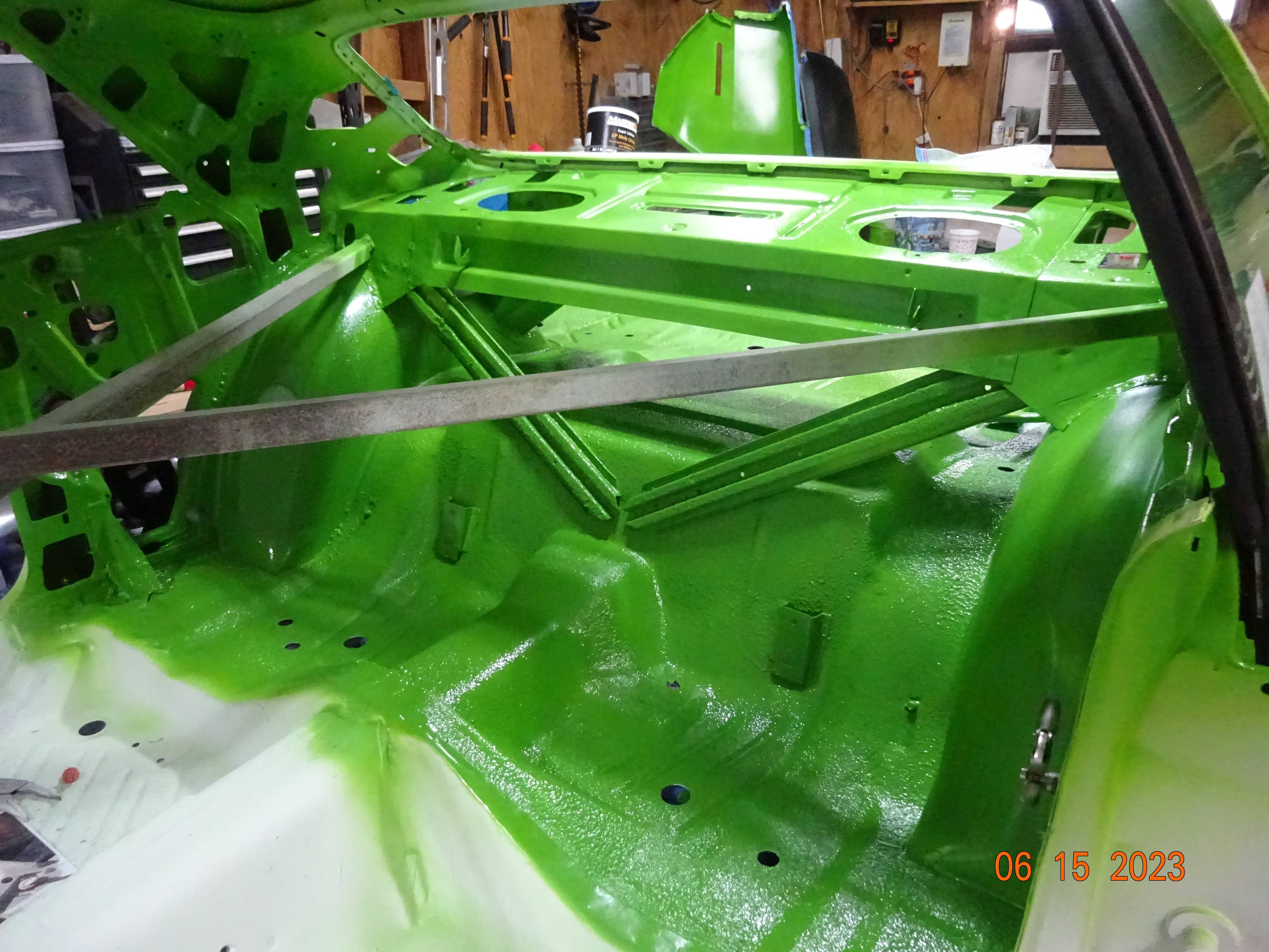

Ambitious project but should be super nice when done.
Looks like you are using a tinted bed liner for a sound deadener on the interior structure? That is something I have considered but haven't looked into how effective it is.
Lizard skin
