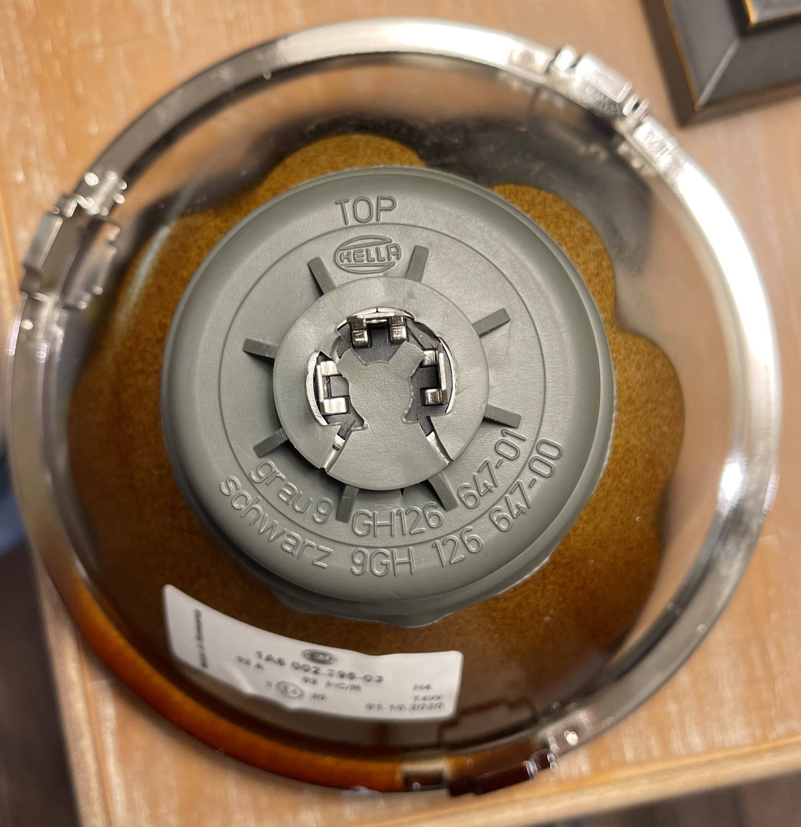

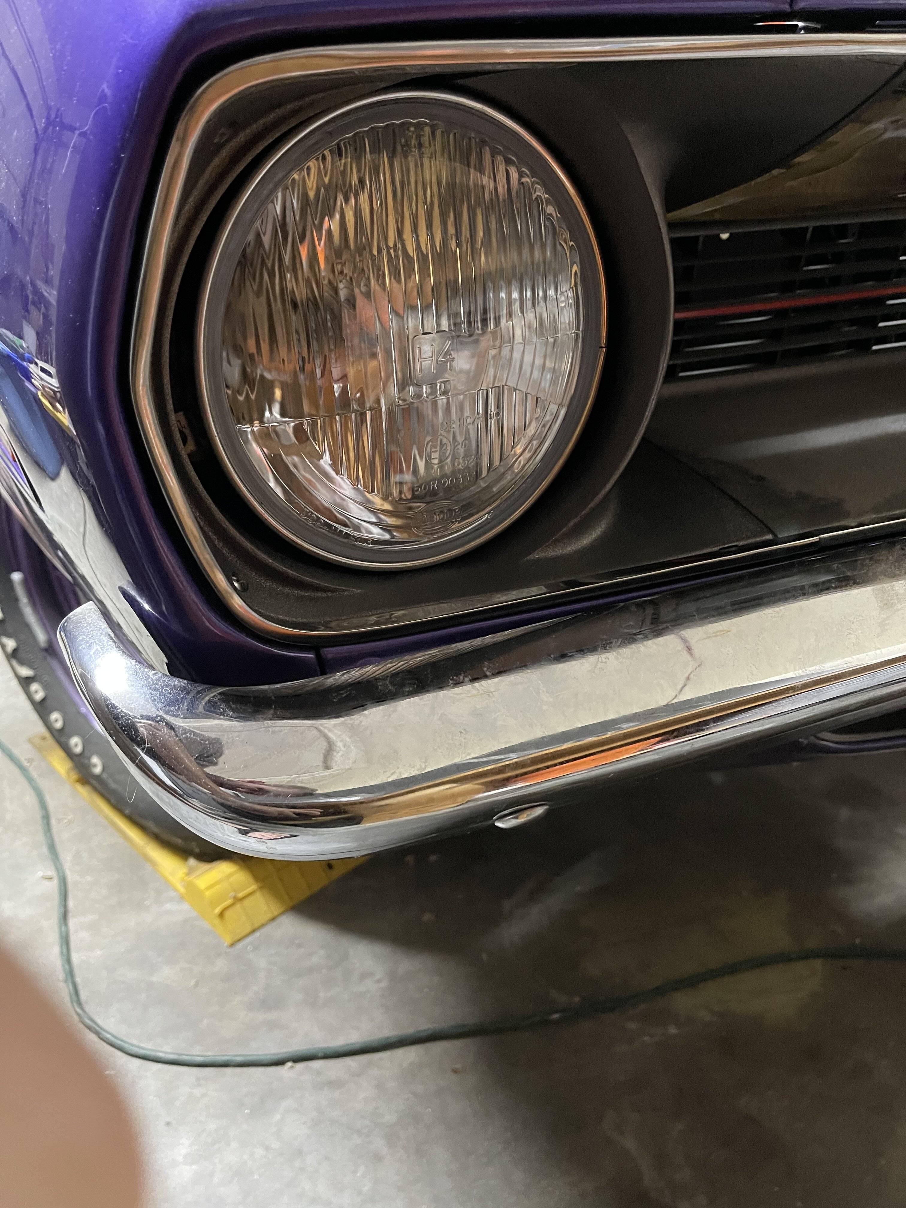

Hella H4 lamp housings fit 70 & 72-74 E-Bodies with two-headlamp systems and use H4 9003 LEDs. I am sure Hella makes housings for four-headlamp systems on the Challengers and 71 Barracudas, too.

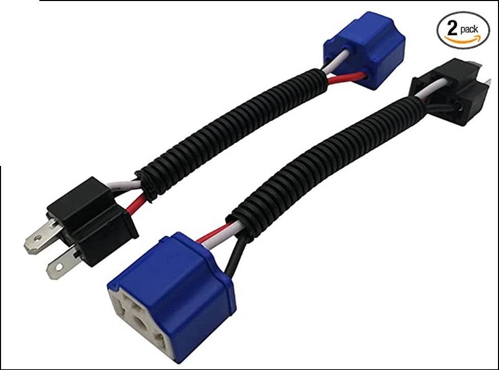

The housing has a rubber boot on the back and it will need to be trimmed for the bulbs to fit properly. Ceramic headlight wiring harness extension sockets are plug-and-play and will handle the heat produced by the LED bulbs. You may want to choose a warmer color temperature to get a more original look but I went with the 6500K bulbs which are bright white.
The other lamps are in the last picture. Consider whether you want to install white LED bulbs in the housing even for the amber/red/green fixtures as some prefer to let the lense determine the color versus blending a color LED with a color lense. The LEDs are inexpensive enough to buy and try to tell what you like and you will have a lot of extras if you have Mopar buddies who want to get what you have leftover.

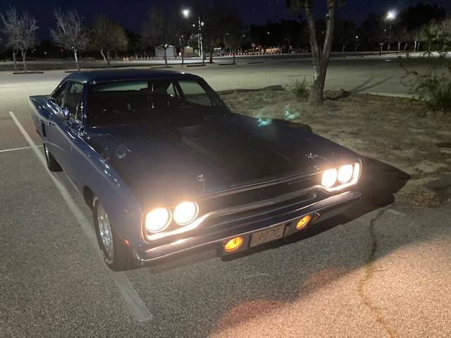

Check out the Holley retro-bright LEDs, pricey but they work very well and no cutting of the mounting buckets.
I installed these in my 70 RR, and fabricated Y connectors so I have (4) low or (4) high.....
