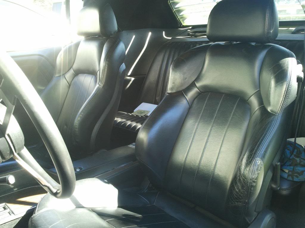

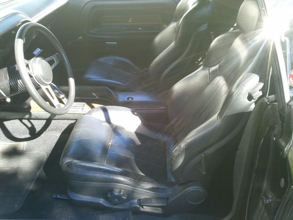

I just finished installing a pair of leather Hyundai Tiburon seats. I REALLY like the extra support.After autocrossing the car a few times different seats were mandatory! I also took this opportunity to also make the adapters so the seat would go back further. I'm 6'1" and was tired of having my legs wrapped around the steering column! Wrecking yard charged me $35 each so I bought 4 thinking I might get a pair reupholstered down the road to match the stock pattern. They are manual adjustable ( No wiring!) recline and have adjustable lumbar. The bottom also is adjustable , it tilts up and down.
