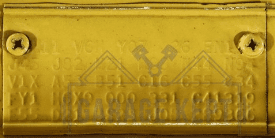

The seller disclosed a lot of information intentionally and unintentionally. I did not see a Broadcast Sheet but the fender tag has all indications of being the original and not a reproduction tag.
