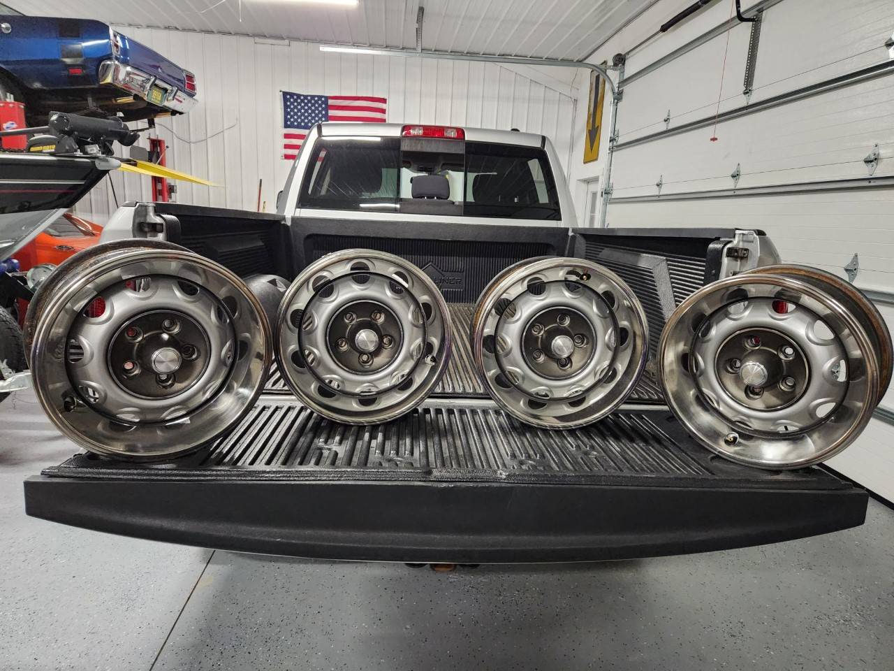

Hello All,
I've got a set of 15x8 Mopar Ralley wheels off my 70 RT Challenger. They have the center caps and rings. I want to sell them, but have no clue what to ask. Before I put them in the "for sale" forum, anybody got a reasonable asking price suggestion?

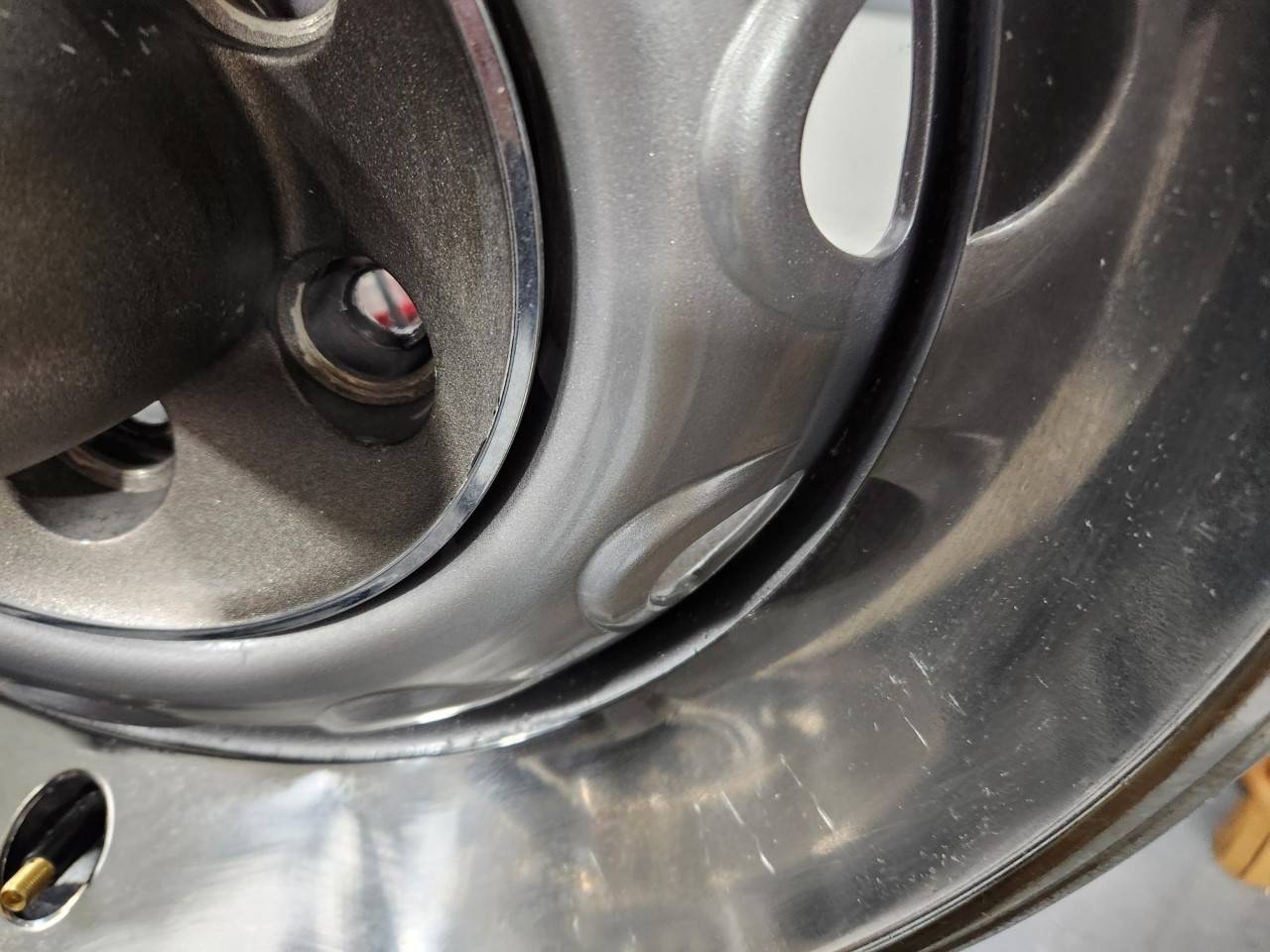

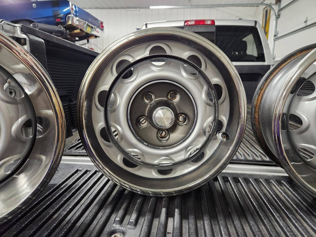

All four appear to be 15x7? I don't see the gap between the trim ring? Are all 4 15x7 or 15x8?

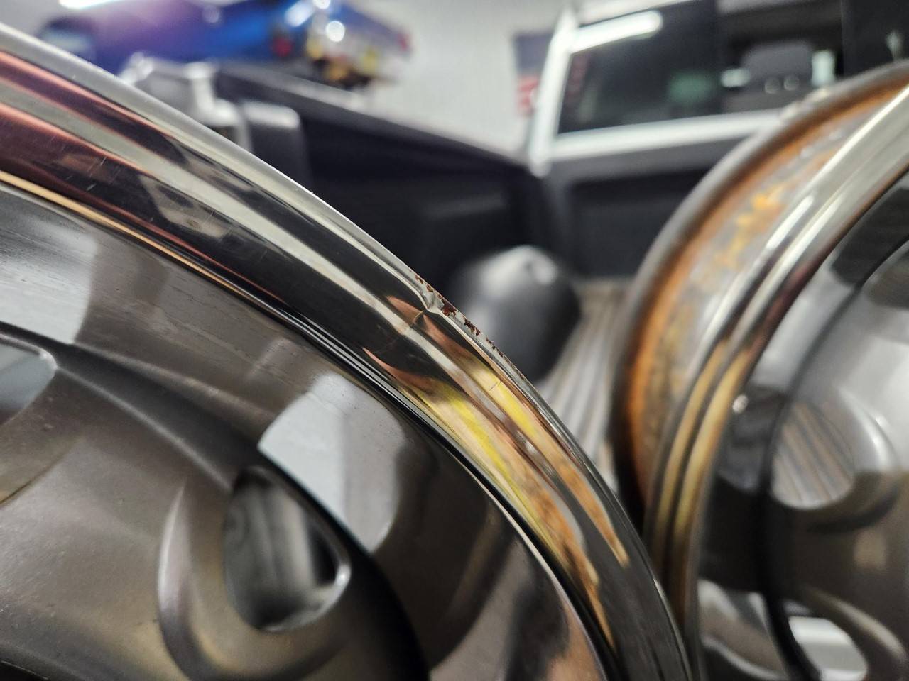

Remember that Chrysler never built 15 X 8" Rally's. After market. Depends on who made them and how much run out they have as well.
Also a big one is the trim rings. Actual Mopar 7" are very valuable, aftermarket not so much. Measure the depth of the rings. Most out there are 6.5" Those have a large gap between the ring and the center of the rim.
A lot of guys use GM trim rings because actual Mopar rings are so rare.

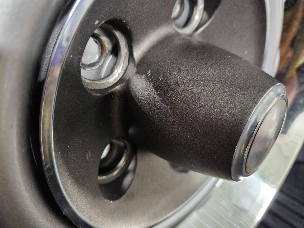

Show pictures of the rear of the caps .New repros or excellent originals ? Repro rings or originals.
We know the rims and lugs are new repros but not the rest. Big difference in values.
I have 15x8's on my Charger. No one has ever commented on the trim ring gap but it is visible.
I think starting around $800 is a good idea. Folks can get all brand new after market good quality parts for just over $1000:
