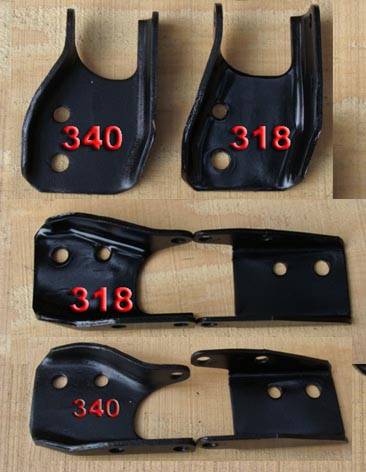

Hello all, I'm looking for close up pictures of both drivers and passenger side motor mounts. The pictures I need must show a small block V-8 mounted to the K-frame I'm working on a 70 Challenger that I bought as a Heinz 57 project car. The car was originally a slant six that had modifications made by the previous owner to mount a 360. I'm trying to make it right by installing a correct V8 K-frame and other crucial steering/suspension components to make the car handle/brake safely. The metal motor/engine mounts on the 360 don't look right. I believe the metal motor/engine mounts I have are incorrect. Can anyone post pictures of both the drivers and passengers side motor mount connections. Any idea where I could buy some?

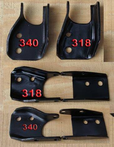

Check these pics to see if you have the correct motor mounts.

Check these pics to see if you have the correct motor mounts.View attachment 26446
Thanks for the picture challenger6pak. Boy, it's kind of difficult for me to see the subtle differences between the 318 and 340 motor mounts. It looks like what I have are the 318 motor mounts. I read some older posts on this forum and a lot of people recommended Schumacher's. They have a rubber and metal mount set that will allow me to connect my 360 to a V-8 K frame. A little pricey, but will same me a lot of headaches! There goes the budget!

You are welcome. It is hard to tell by pics. It is a difference in width.
