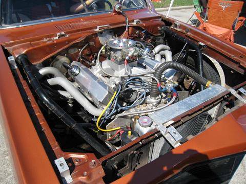

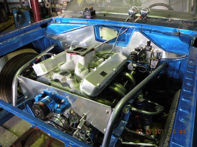

I have seen it done both ways. Either should work just fine. If you have snout bars I would run an upper mount to them. Going to go with a set up kind of like this in my Duster but have not got around to it yet. Here is a few pics.

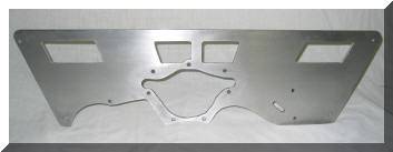

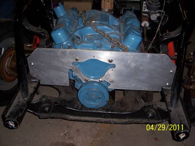

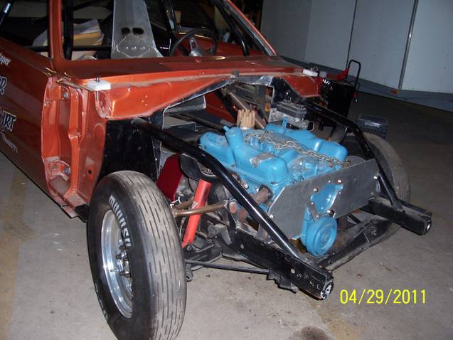

Attached is a pic of the motor plate I have.
It is sandwiched between tabs welded to frame at the bottom holes.

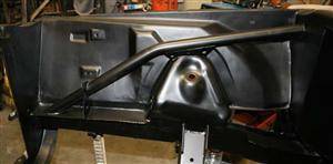

No snubber bars but looking into it. Pic also attached.
