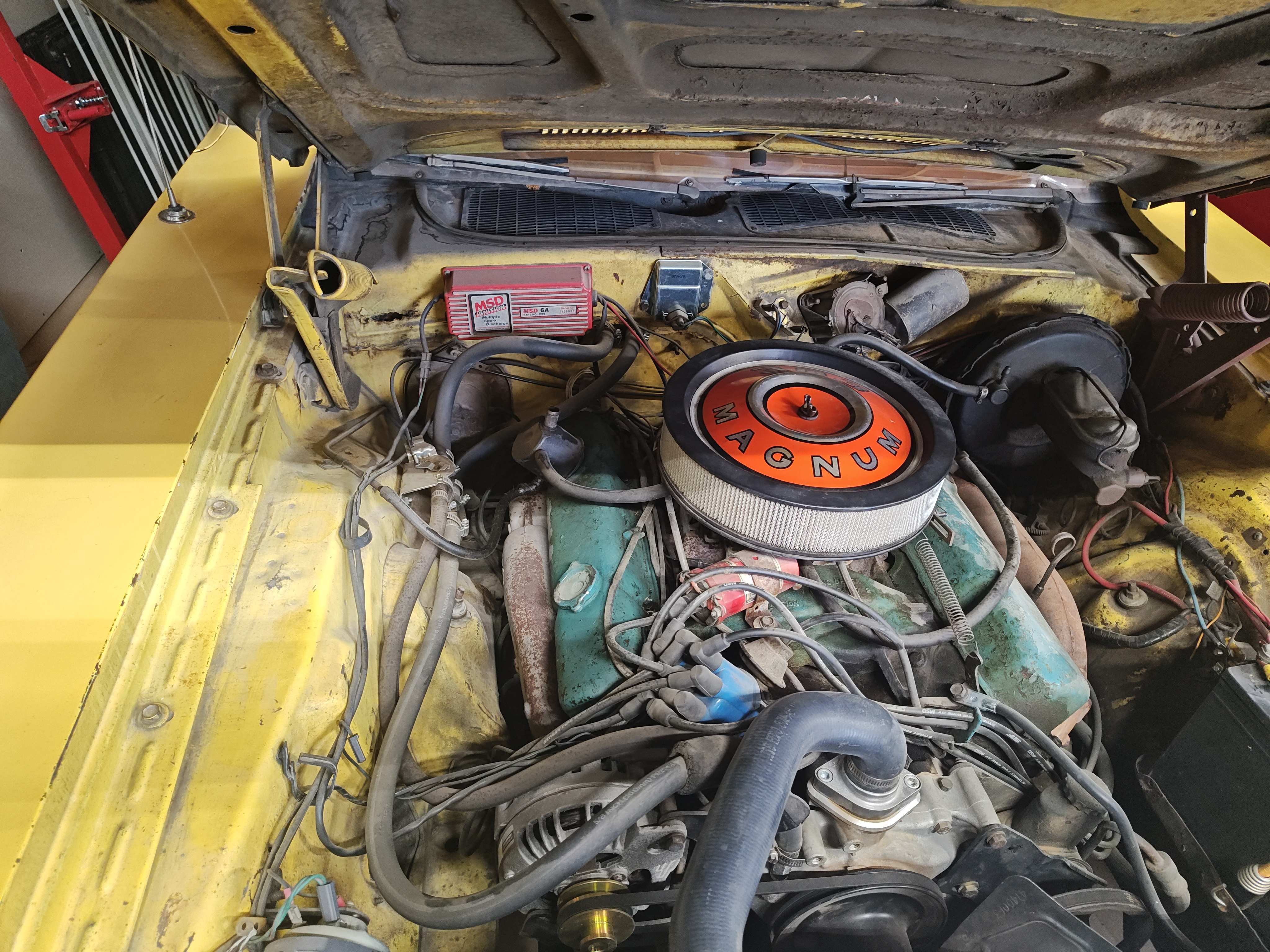

Mine is on the rh fender apron now.
Motor is out for upgrades and will probably mount it behind/beside the glove box area??.
I still haven’t mounted the glove box material.
Just think about routing/routing the hot wire.

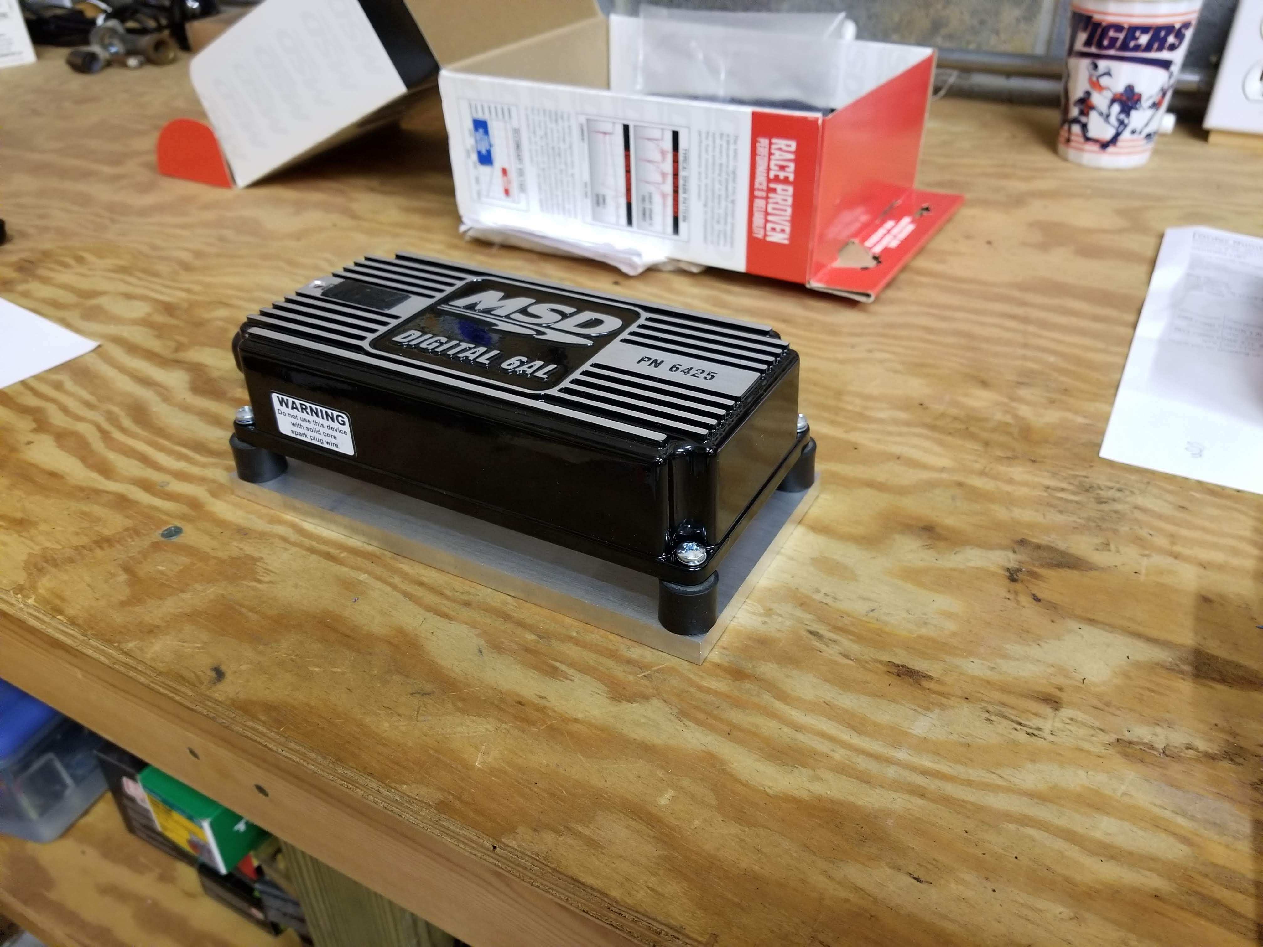

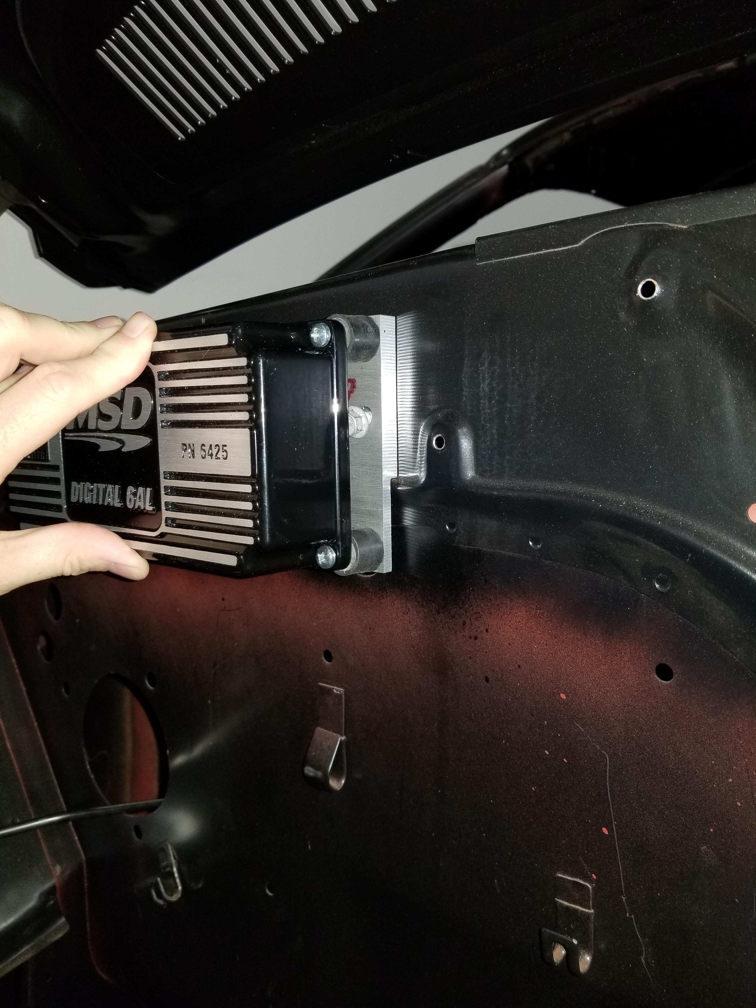

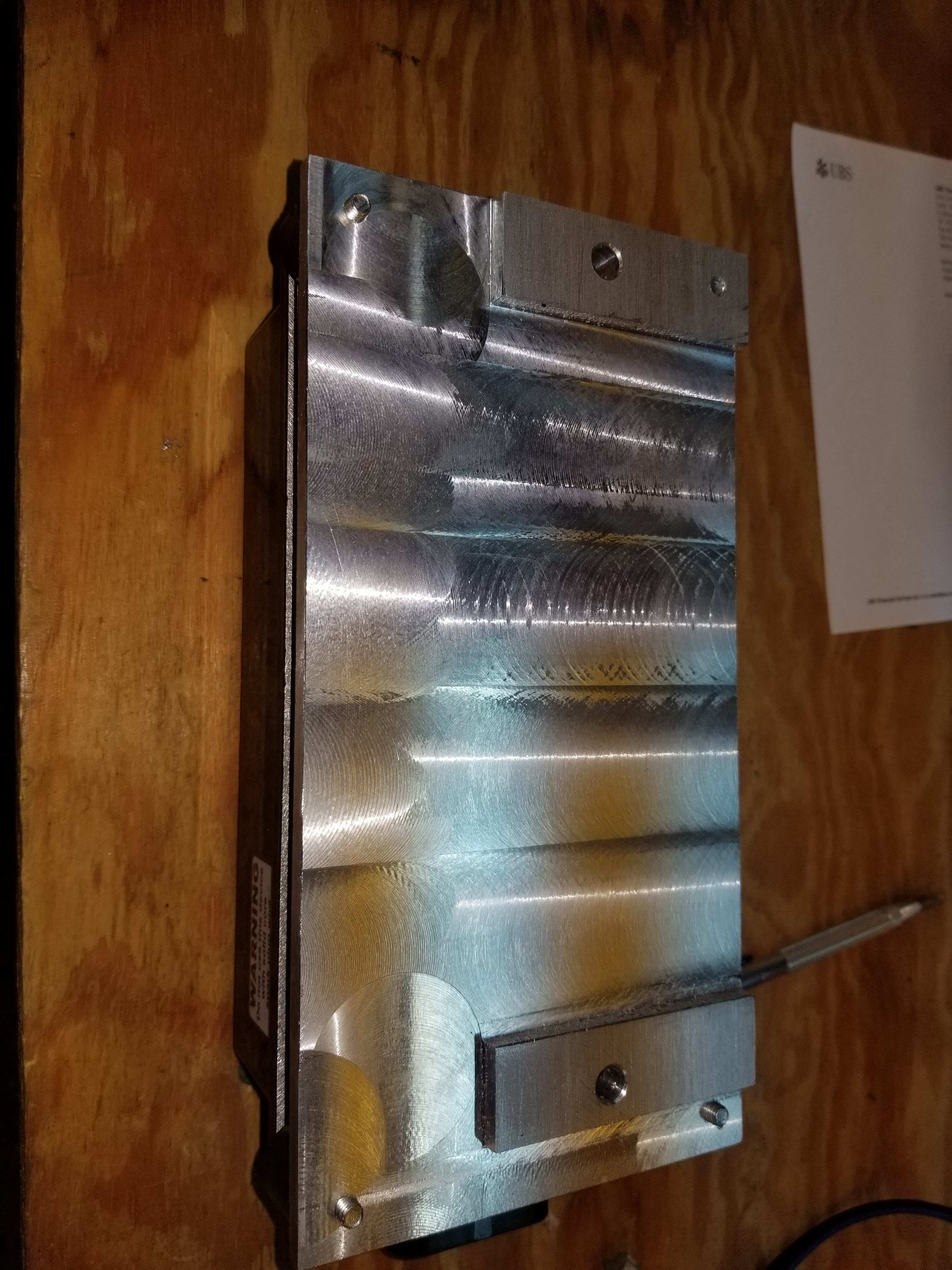

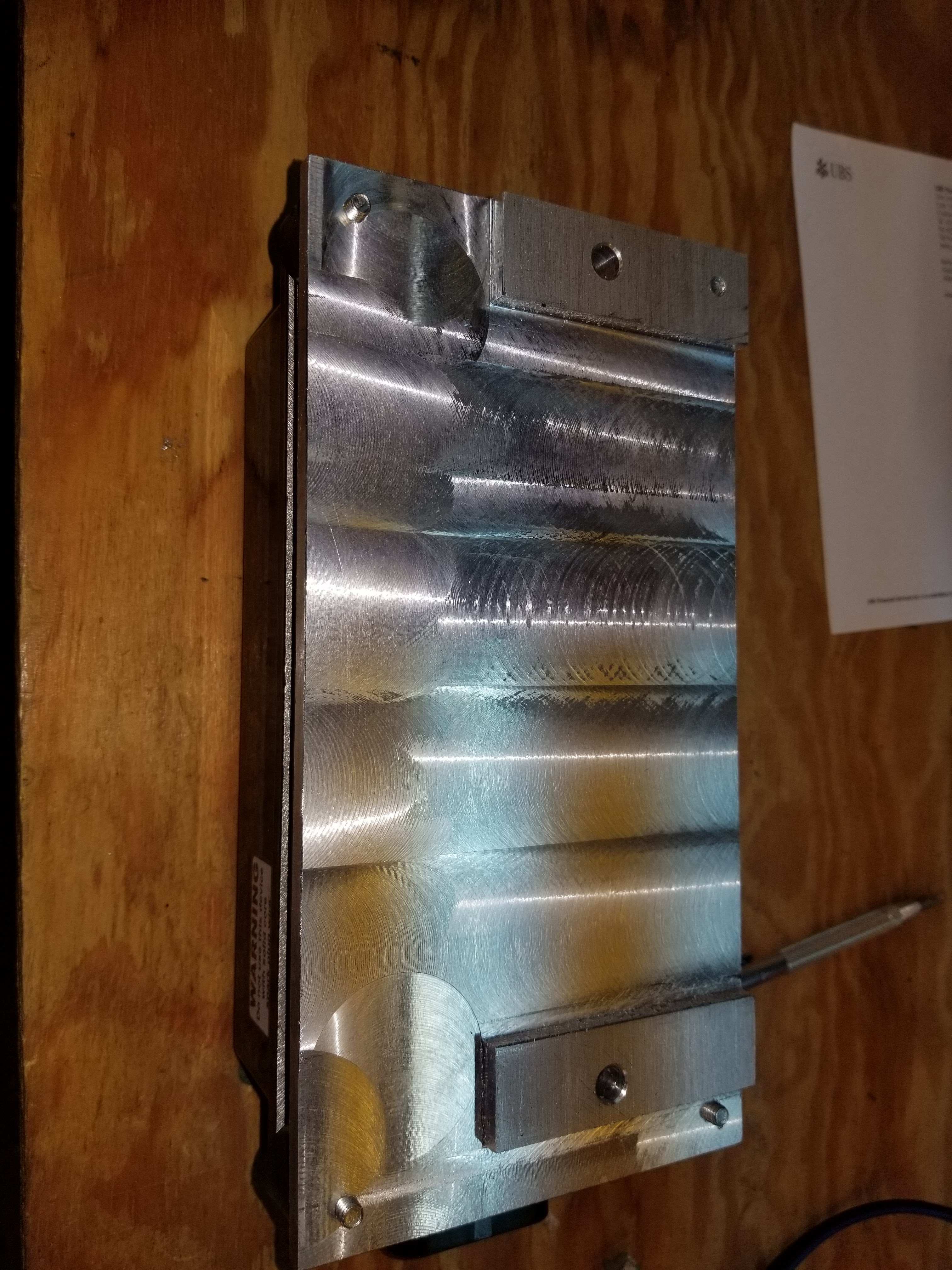

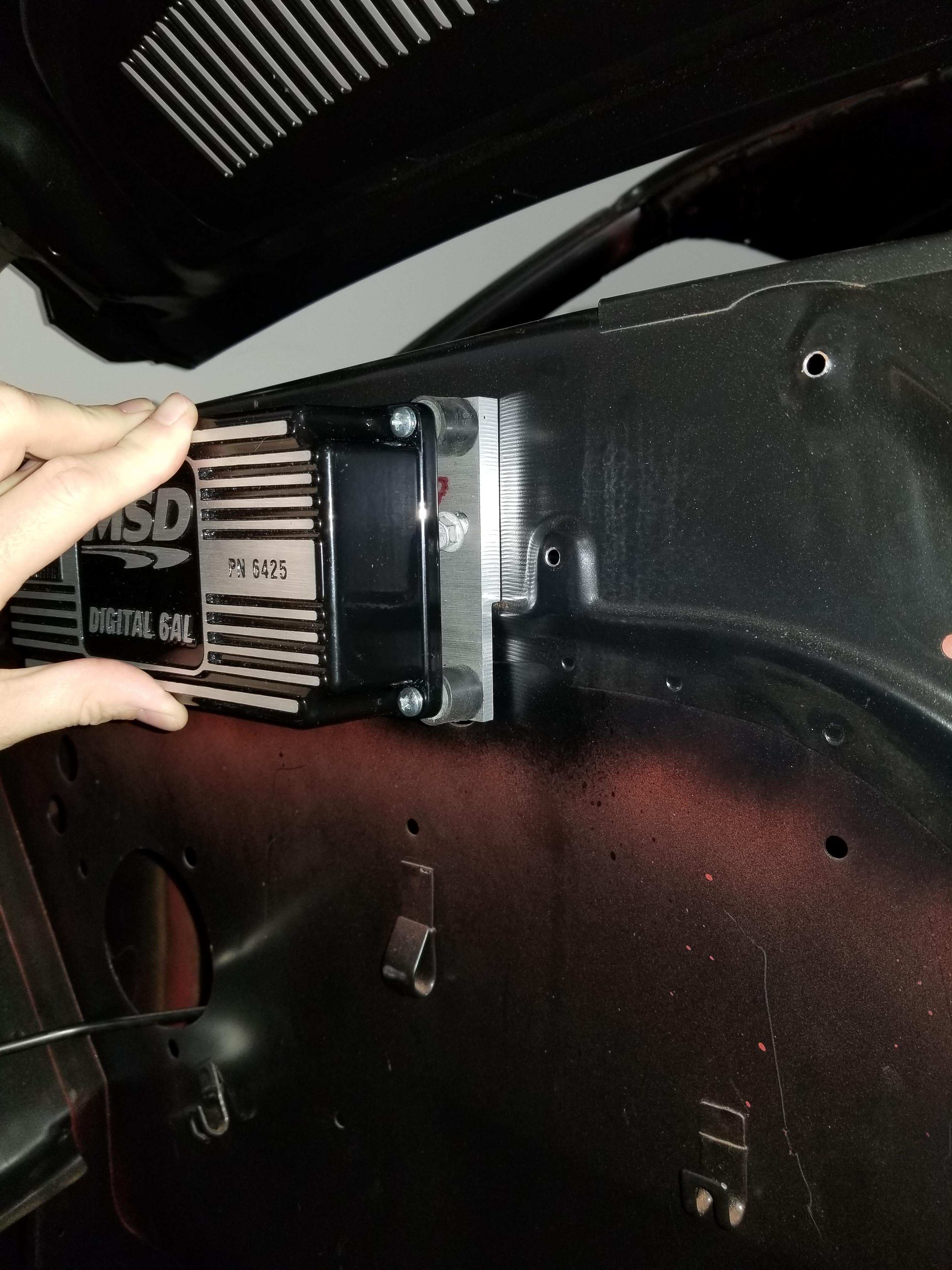

I have built a aluminum plates for a few different e-bodies to mount MSD ignitions in the place of the stock electronic ignition module. This gives a good way to install it with the rubber vibration isolators and not have to drill extra holes in the firewall/cowl for the car.
