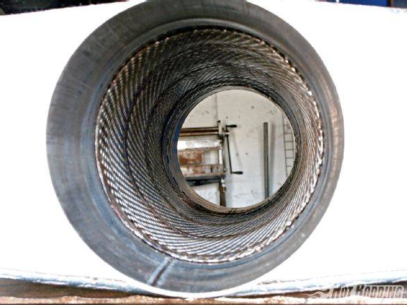

On my 70 Challenger, I added the Hooker Max Flows (2.5") under the rear seat and then used the Classic Chambered Exhaust #25-RES-SPE1 beside the tank with 2.5" RT tips. The idle and cruise sound is mean and the WOT is loud! I can cruise up to 70mph with no drone as a bonus.
