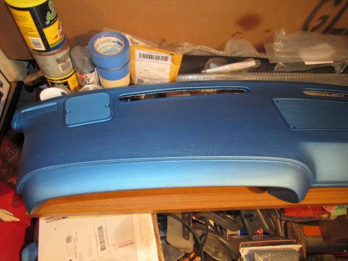

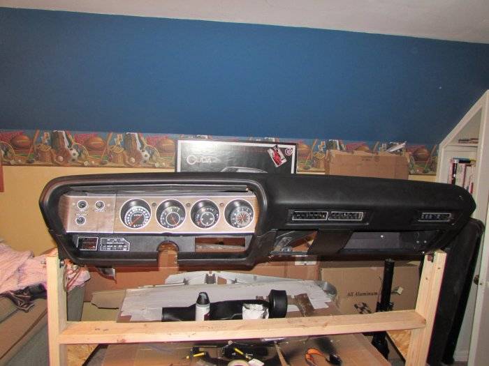

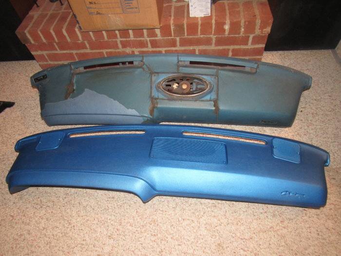

I have a 1970 Challenger convertible with a B5 blue interior. My car has a cracked dash covered by a cheap plastic dash cover.

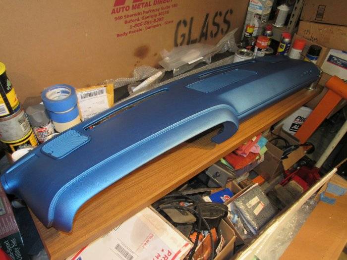

I purchased an original 3 speaker dash in black. It is black no longer...
Really nice! I have a similar car with the same issue. What did you use and what was your process please?
For color, I went to my local automotive paint shop and asked for a vinyl paint in 1970 Mopar B5 Blue. They mixed a quart for me of Dupont Vinyl Color. The color number, I believe is 4982J (but I'm not sure if that is the base or what they mixed). The color name on the label: Chrysler B5 Bright Blue.
I have a friend with a paint gun and air supply setup and he shot the parts.
The paint was rather expensive (>$200 per quart).

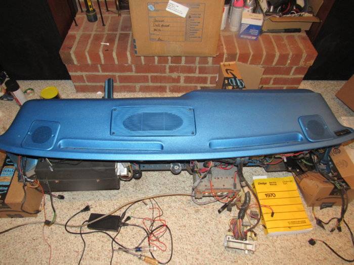

As for installation, I plan to remove the whole dash and install the pad off the car. I'll clean and paint other parts as necessary.

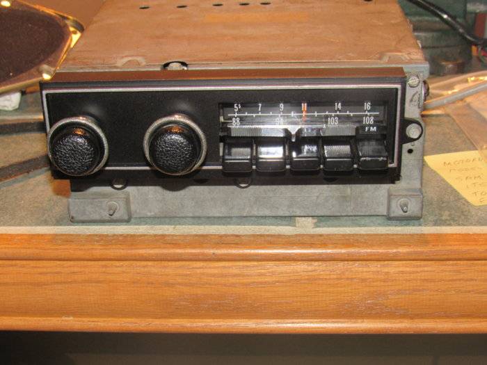

For the radio, I bought a C-body AM/FM stereo from the same era. I plan to use the AM/FM internals in my E-body AM box. The clear plastic dial face (with AM/FM switch and numbering) can be swapped to the AM face plate. My c body radio came with wiring harness, fader switch, and crossover box. It won't be factory (no thumbwheels and the AM/FM switch is a different size, but it will be very close to 1971 AM/FM stereo unit.

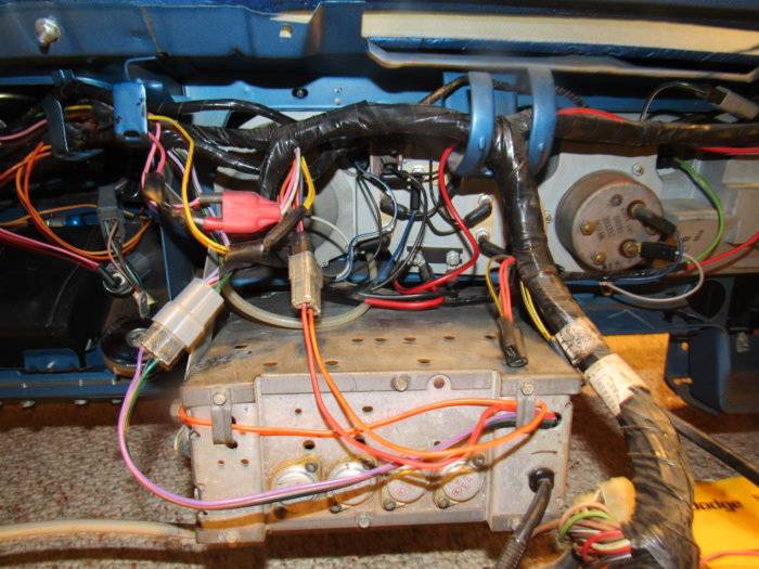

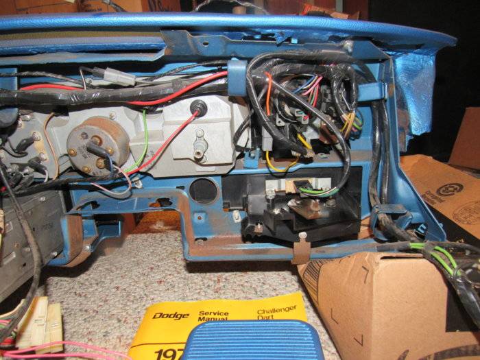

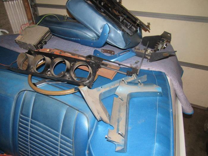

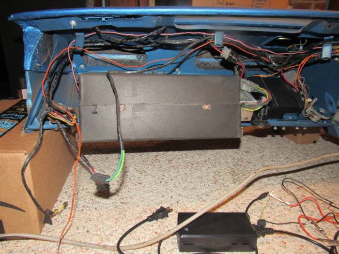

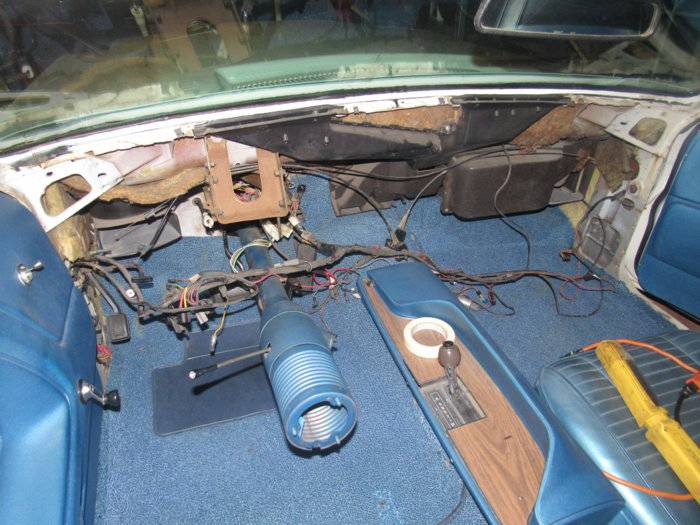

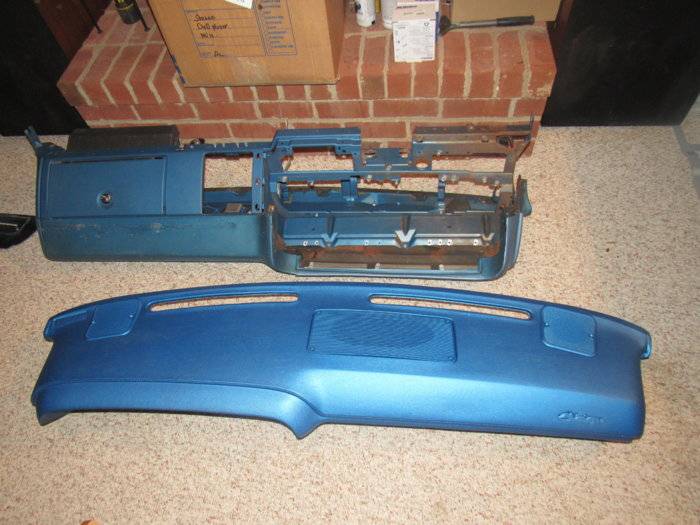

Finally got around to pulling my dash for the replacement. Removal was more of a PITA than I originally thought. I did not remove the harness from the car (see photos), so I had to partially disassemble in place to disconnect various electrical connectors.
Dash less interior:

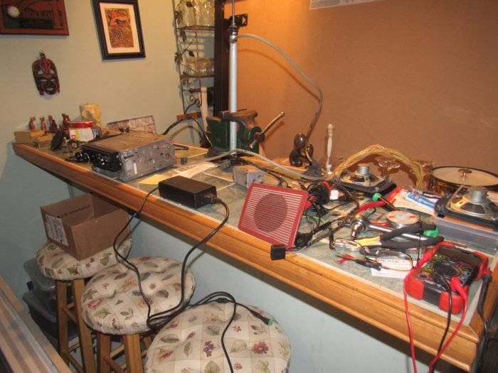

Parts bench:
E body stereo serviced by Wards:
Radio test station:

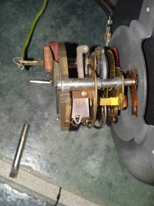

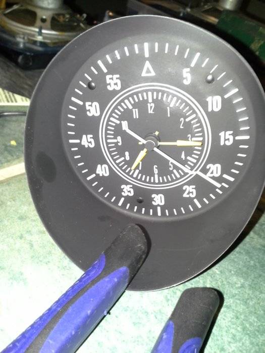

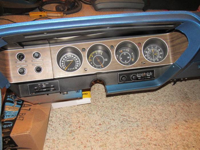

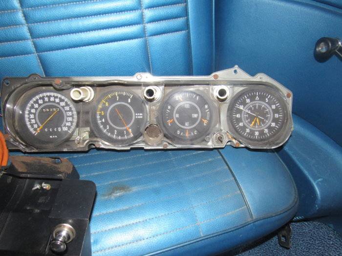

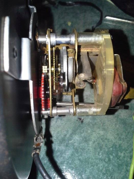

Continuing my dash project, I decided to tackle my non working rally cluster clock. Since I've played with auto clocks before, I did not hesitate doing this repair myself.

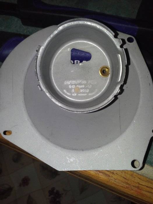

I assumed the clock needed cleaning and lubrication as this is the typical reason they fail to work. After removing the clock from the gauge cluster, I found that the back can be removed by bending 4 tabs and exposing the clock movement (still attached to the face).

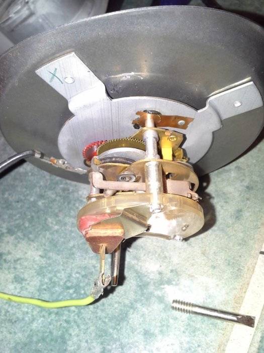

I cleaned the movement by spraying CRC electric circuit cleaner (evaporates fast). Without lubrication, the clock would not run for more than a minute. I tested the rewind solenoid and found that to work fine. I sanded the contacts of the rewind mechanism to ensure a good solenoid circuit.

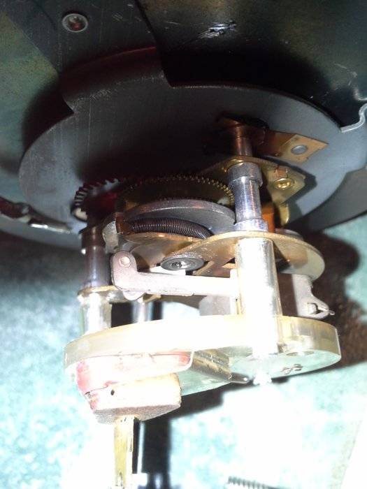

On closer examination, I noticed that the wheel that is pulled by the winding spring did not sit parallel to all other gears. I could straighten it with finger pressure. It turns out that the hole supporting the back (towards back of clock) pivot pin of that wheel had worn and elongated due to the spring tension.
To fix this issue, I needed to further disassemble the movement. I just needed to remove the solenoid portion to expose the plate with the elongated hole. This required carefully pinching the ends of the three posts that support the movement and sliding the solenoid component off. I founded the smallest steel washer I could find, leveled the rewind gear and crazy glued the washer to the plate covering the elongated portion of the pin's hole. You can see the washer in the photos below.
With the bearing plate now exposed, I could lubricate all the gear bearings and I used a toothpick to reach gear pins that were not exposed. I used clock oil for lubrication, but I understand that 0w 40 synthetic motor oil is a good substitute.
I reassembled the solenoid portion of the clock and connected it to a 12V DC supply. It's been working (and keeping good time) for three days.
