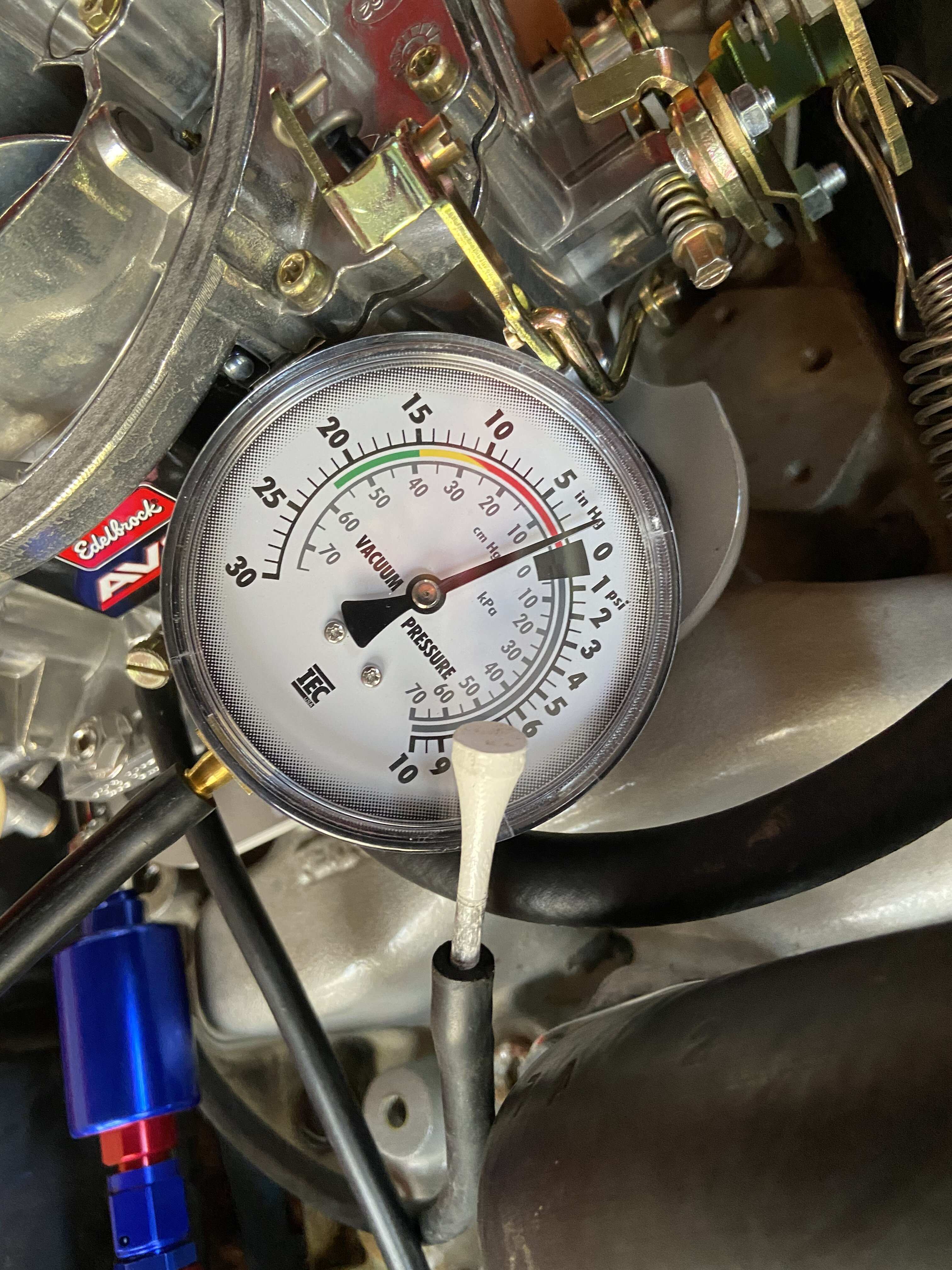

The engine shook the car like a funny car dragster and it constantly stalled. Then once it stalled it was all you could do to get it to start. It would barely turn over. It ran fabulously if You gave it any throttle and had no vibration and good power. As long as you didn’t have to stop for a red light it was good. But it required two feet to and constantly shifting into neutral to keep it running at a light (automatic). The engine had almost no vacuum.
Every mechanic I took it to told me it was fine. It had a race cam. What did I expect? Only I had told the “builder” I wanted a cam exactly to the original 340 spec. So I argued it it didn’t have a race cam and had to be something else. I just started changing parts: put on an electronic ignition, three carburetors…….
Compression was good, timing was super advanced, it had almost no vacuum.

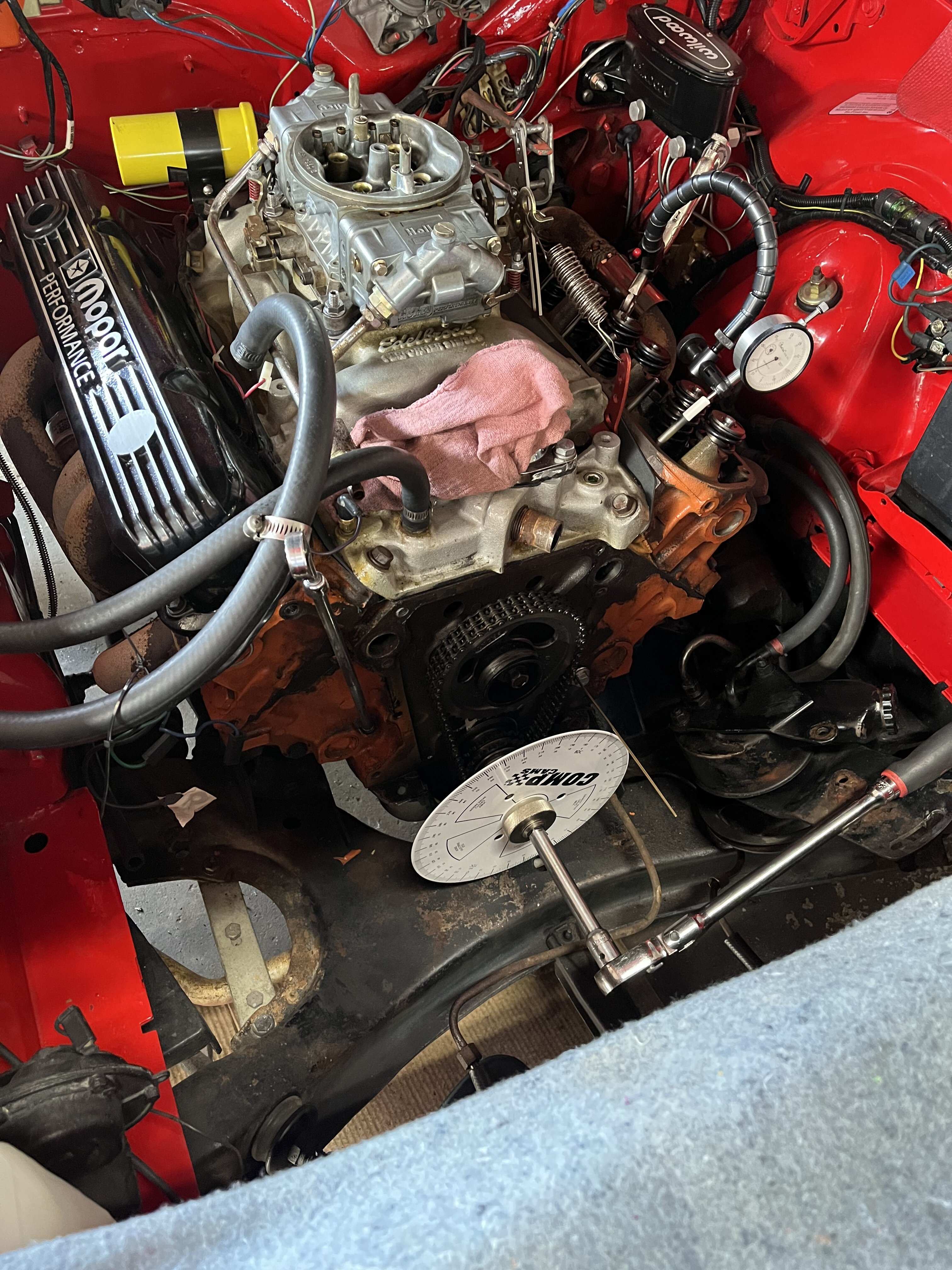

After all these years finally found a mechanic that knows what he is doing. The gaskets were way too big on the china wall and it was leaking vacuum. That was easy to fix. He measured the cam and it was some sort of insane race cam that the intake and exhaust valves overlapped and were open at the same time. That explains why the intake got so hot.
Then he found the heads had been ported. I had told the “builder” not to port the heads. He had cut into the bolt holes for the valve covers and they were leaking vacuum also.
Changed the cam, sealed the vacuum leaks, set the timing, carburetor, etc. and the car now runs amazingly - most of the time.
