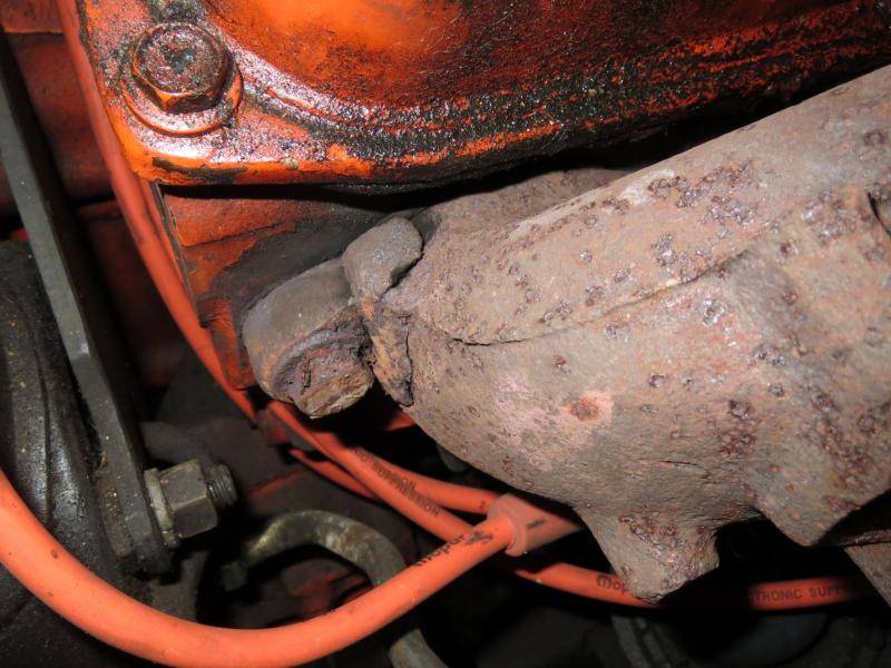

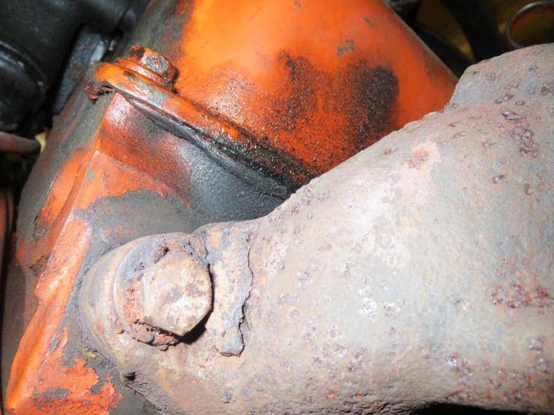

Thanks Ray, that's a hell of an offer! I am currently dealing with my Imperial, let me get that back on the road and I may just take you up on that. Here's the culprit, look like it'd be a problem? How badly will the repair stand out? It's an original to the car but I'd just as soon replace it if it'll be something that'll jump out at me when I open the hood.

I've fixed worse. Getting it clean first is the key. Grease and welds don't mix. A die grinder and a little massage work, will clean it up.
