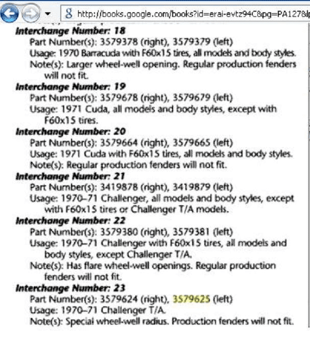

Later in the 70 model year, the factory made modified TA fenders for the trans am Challenger and later sold a modified fender used on 1971 models (3579380-81)
The change was basically bending up the lip at the center of the wheel well to increase space from the fender to the tire.
The 440 was not available on 1971 Challenger convertibles.
You may need to modify your fender in using 15" wheels on your Challenger.
There were three different fenders that went on to 70-71 Challengers.

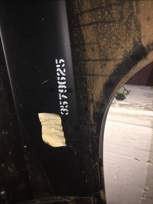

I am fortunate to have put away a pair of NOS fenders I bought around 1980.(624 & 625)
The right side fender had a little handling damage on the top/ front but who would argue on grabbing them at the time they went NS1
If I get a chance, I will take a photo of the wheel well lip at the apex of the NOS fender and the original that is on the car.
Here's a pic of the stenciled part number and the part number sticker.

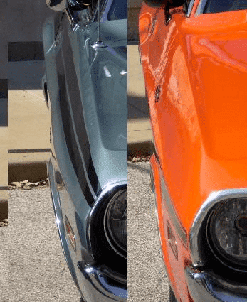

Interesting pictures of the 625 fender compared to a regular 71 Challenger fender.
Shows an external bulge over the wheel well on the "TA" 625 fender vs a regular RT fender.
Interesting visual comparison.
Notes from the original author:
Left pic fender w bulge above wheel
Rt pic no bulge above wheel
My friend already had his T/A in 1980 when I bought my R/T. Parked side by side, looking down the line from the rear bumper, I could see the bulge on the front fenders on both driver and passenger side. You have to have a regular fendered car next to a T/A to see it. On my replacement fender, I see the same bulge that I saw 28 years ago. My original passenger fender doesn't have it. If you have original fenders on your T/A, you should see the difference when parked next to a standard one. My part number is 3579625
This picture shows the bulge on the gunmetal challenger's side by side next to my original R/T non-bulge fender. His fender was a replacement T/A fender, with the cutout. His driver's side is original and doesn't have the bulge or the cutout.

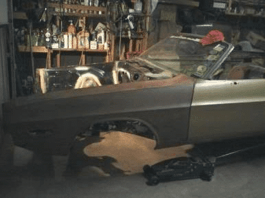

My 71 challenger convertible was wrecked on the driver's side left front, a long time ago, before I got it. Someone replaced the driver's fender, then is sat never to be finished, changing hands several times. The fender still has the part number on the inside. 3579625
It was put on the car and sprayed behind the headlight buckets. It was never painted besides a light coat of primer, so it has very light surface rust and a little rust on the inside by the buckets. It is a T-A replacement fender that has the special outward curve on the body line for the bigger tires. You can only see it if you eyeball down a T-A fender and eyeball a regular fender. T/A owners know of this bulge. I'm not talking about a rolled fender lip. It has the cutout in front, shown in the picture below.
