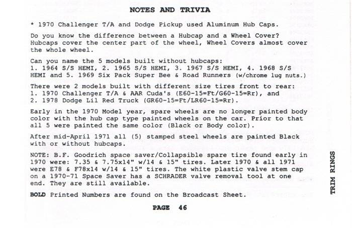

From Govier's booklet....

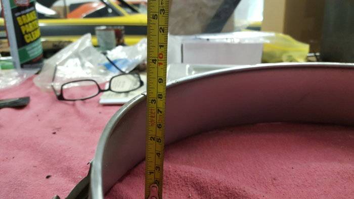

Not trying to hi-jack this thread but I have a question for all you T/A owners since we're on the subject of steel wheels and trim rings, etc... Do all of you still have your original 3 1/8" deep trim rings?

I can't comment on any of the reproduction trim rings as I have never purchased any. I do know that the correct 3 1/8" deep rings for the steel wheel T/A's are NOT reproduced by anyone to my knowledge. The trim rings for rallye wheels are not as deep and are reproduced by many vendors. I had my original rings restored by Rick Miller and they came out beyond perfect.

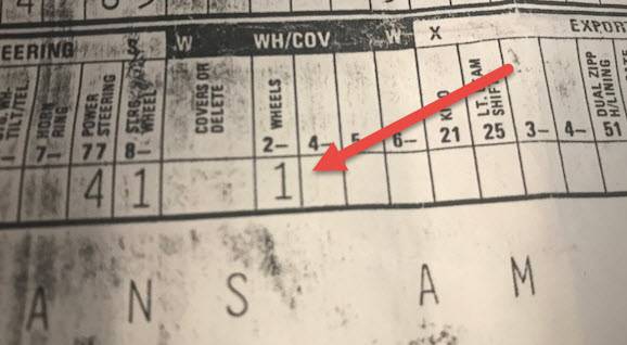

All good stuff but the easiest way to determine which wheel came on your T/A is to check line 11 of the broadcast sheet, section W. If you have a "1" denoting W21 Rally wheels then that is what your T/A had. If the box is empty then your T/A is a steel wheel car.
