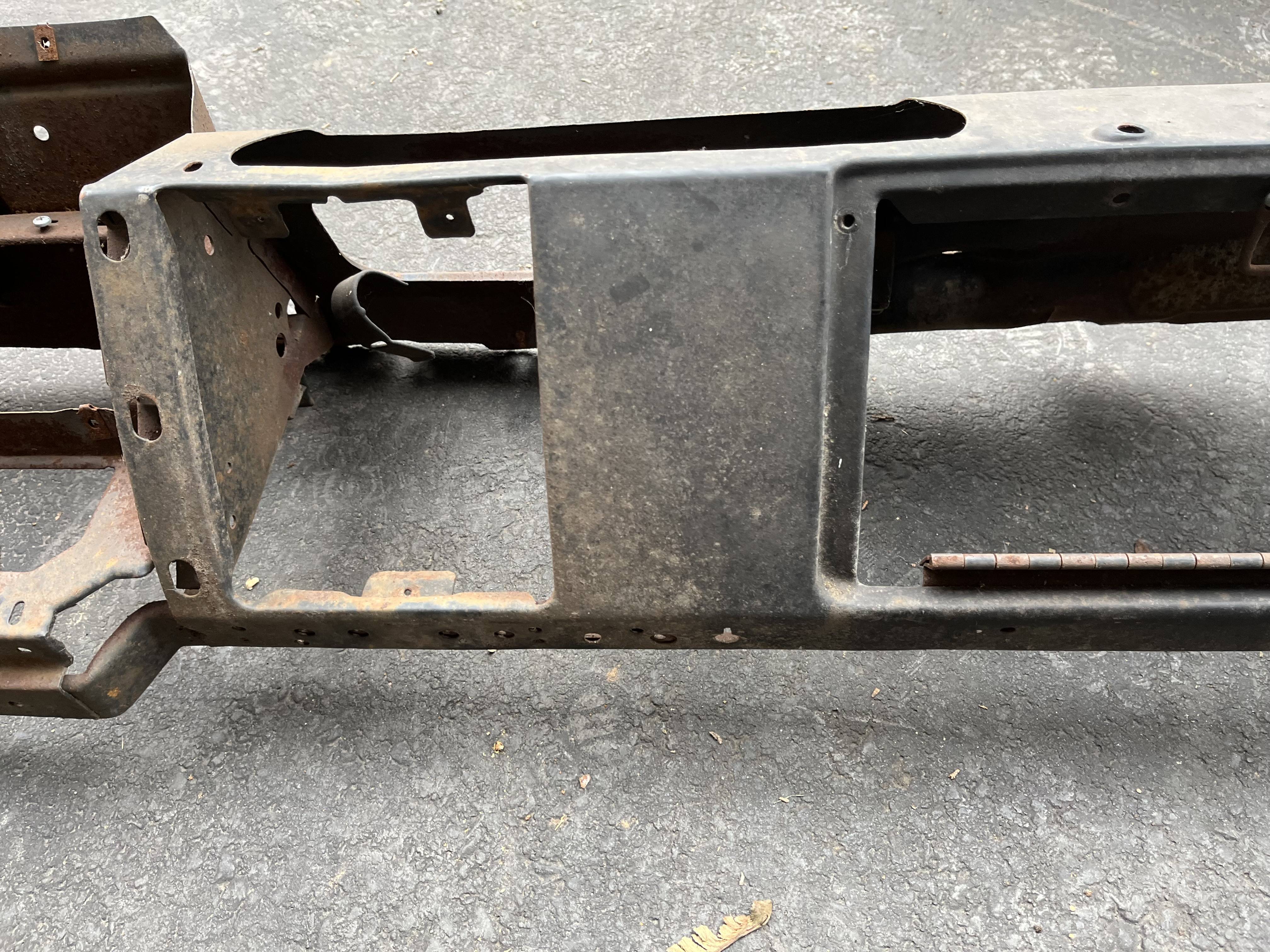

I have searched but I could not find out what color of black the metal dash support structure, ash try and glove box should be on my 73 Dodge Challenger. Does anybody have an idea or source for the color?

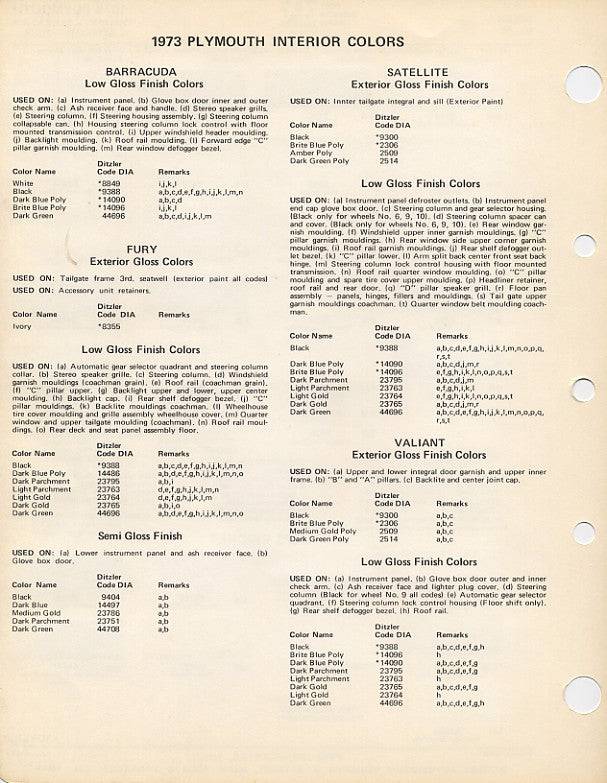

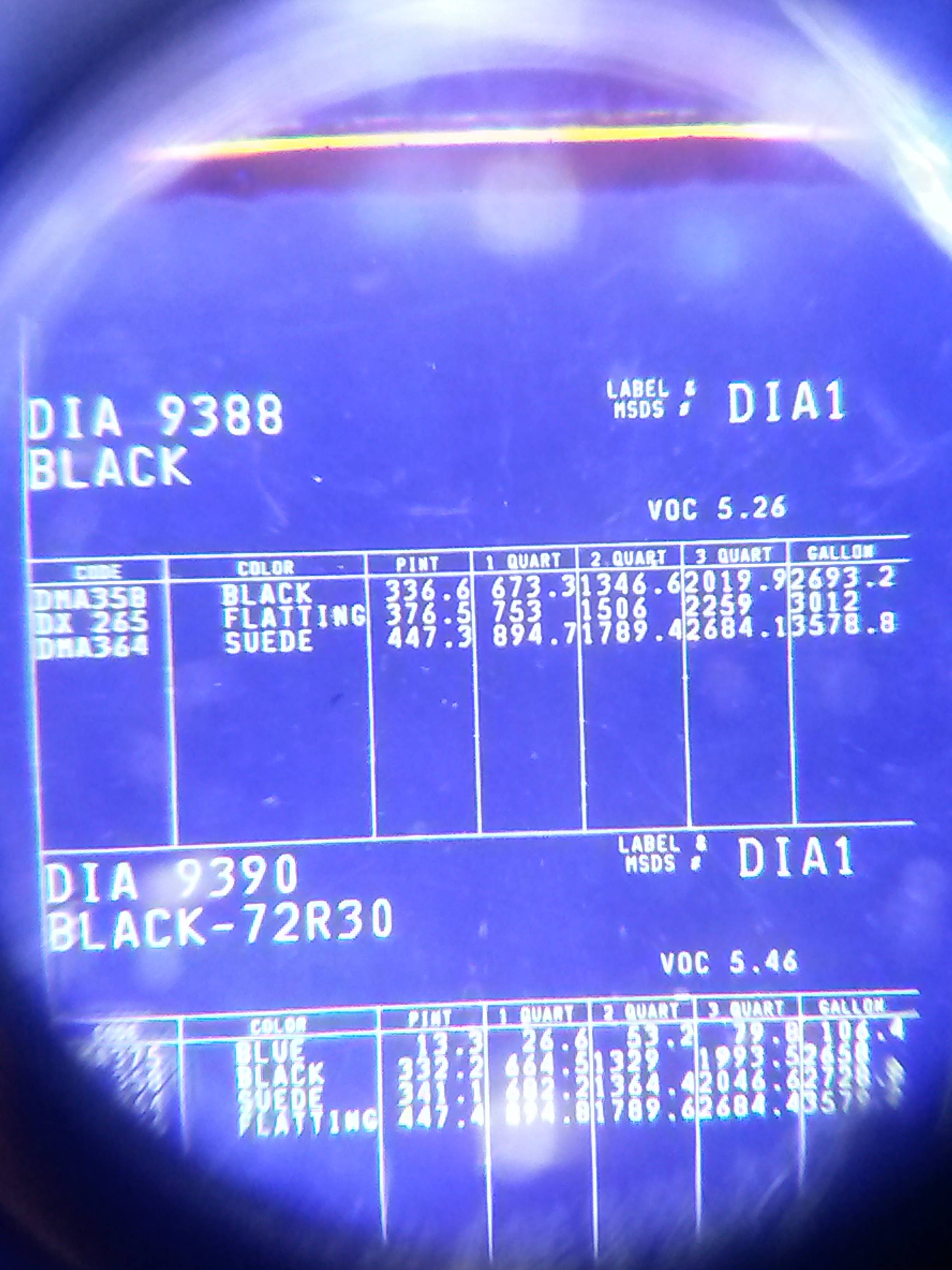

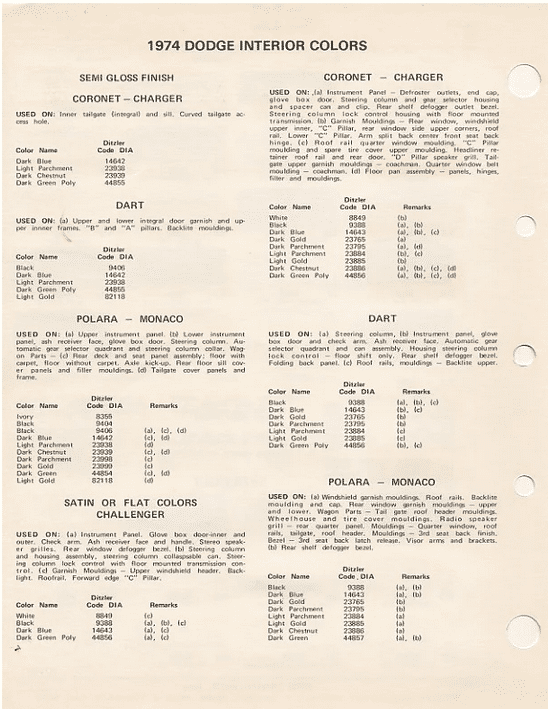

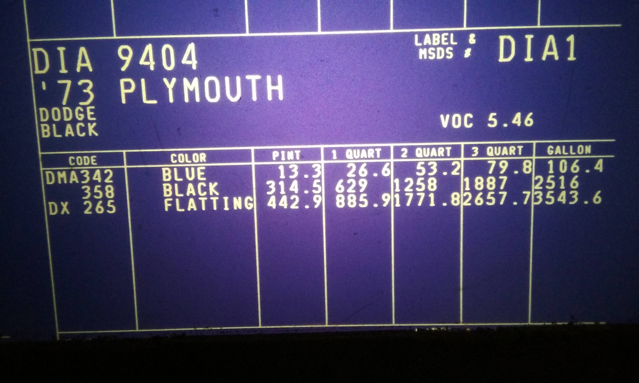

Well, the suede (textured finish) wasn't used in 1973. So stay with the 1974 page. Here's 1973 Plymouth which should also be the same.
