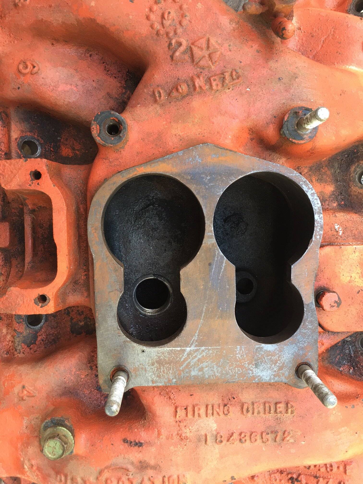

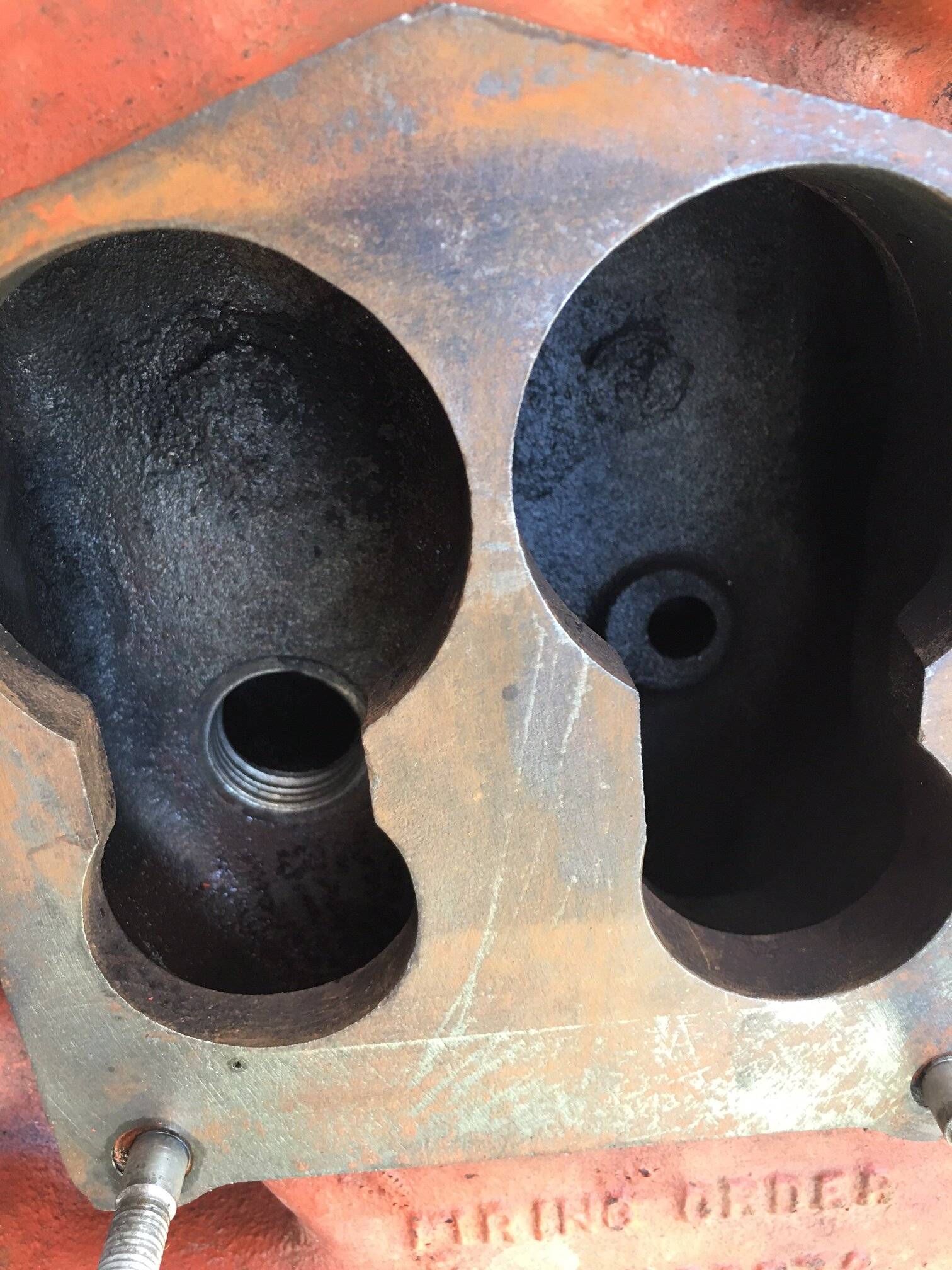

Hi all, I'm working on a 400 engine and discovered that the intake manifold appears to be missing some sort of fitting in one of the chambers. There is an open threaded hole. I'm not sure what to make of this as this is my first mopar. I'm guessing a previous owner wanted it this way? Can someone let me know what the fitting is for and should I try to replace it? Or plug the hole? Is this some sort of system to allow exhaust gasses into the intake like an EGR? Thanks for any input.

That would go into the heat crossover port mixing raw fuel into the exhaust or exhaust into the intake , you want that closed off

Welcome to the site from Arkansas! I would definitely plug it as Chryco mentioned.
