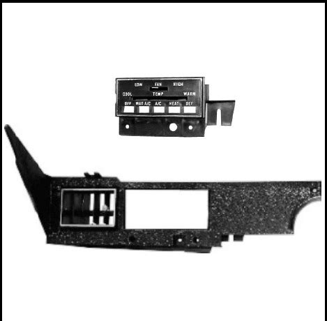

What bewilders me. How you also make it from September to April whit out A/C? A hot chick with a cuda sweating all the time and you didn't get an answer. I think every one just wanted to see you sweet. The trim panel as you might know is different from the standard to rally cluster. I just want to respond to bring it to the top. others can give there opinion based on there different experiences.

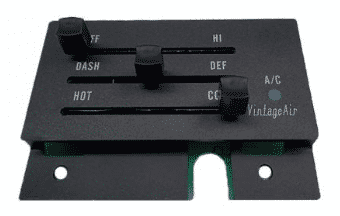

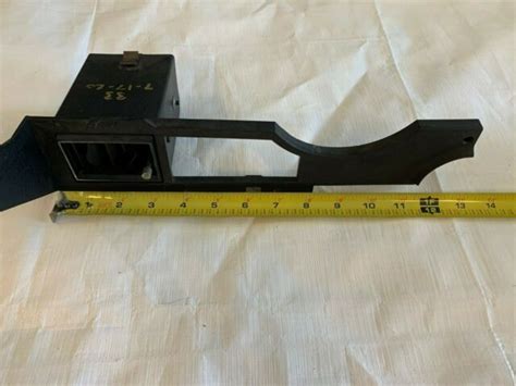

The difference is the housing the switches go in. With the standard gauges it has that corner clipped off. I believe the actual switches themselves are the same though. Not 100% sure, but you could probably order for the rally dash, that way you would have the proper housing for once you do switch, but put those guts into your original housing for the time being.

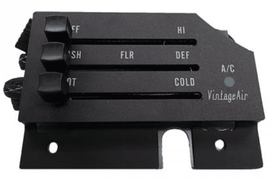

Yes, the Vintage Air Control Panel for the Rallye gauges will not work with the Standard instrument cluster as noted by others.
That upper right corner will hit your Standard speedometer for sure.
Here are both Vintage Air control panels.
You can install the A/C kit for Standard Gauges but it will cost you another $219.00 later to swap out the Standard Gauges control panel to the Rallye Gauges control panel.
I hope @ItsJustMe can set you up with that VA standard control panel. That would solve your dilemma.
