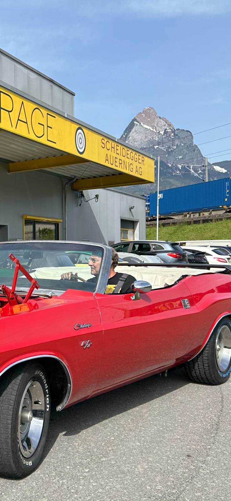

Thank you for your welcome!
I am new on this forum and wanted to introduce myself, I am from Zürich, Switzerland.

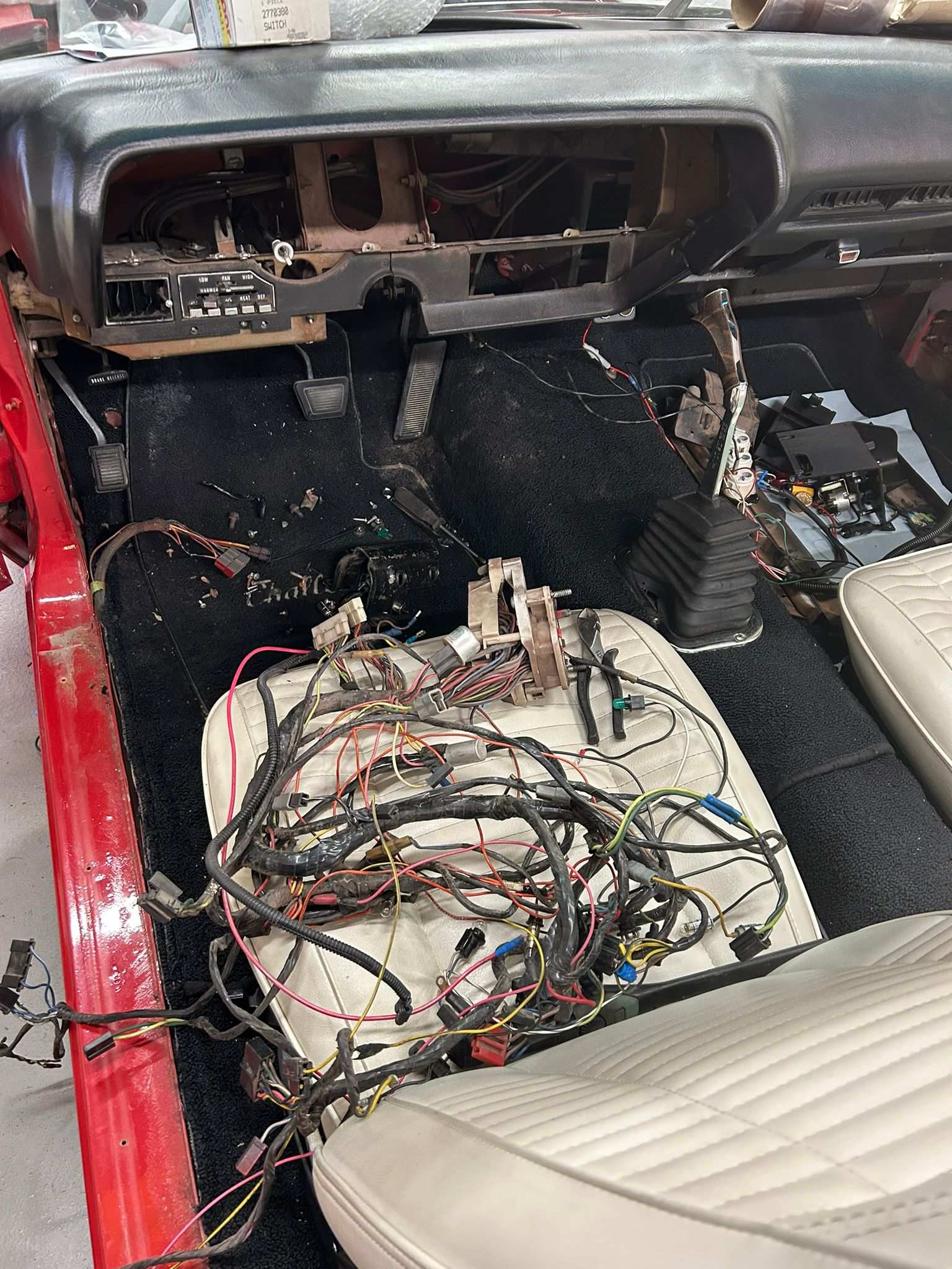

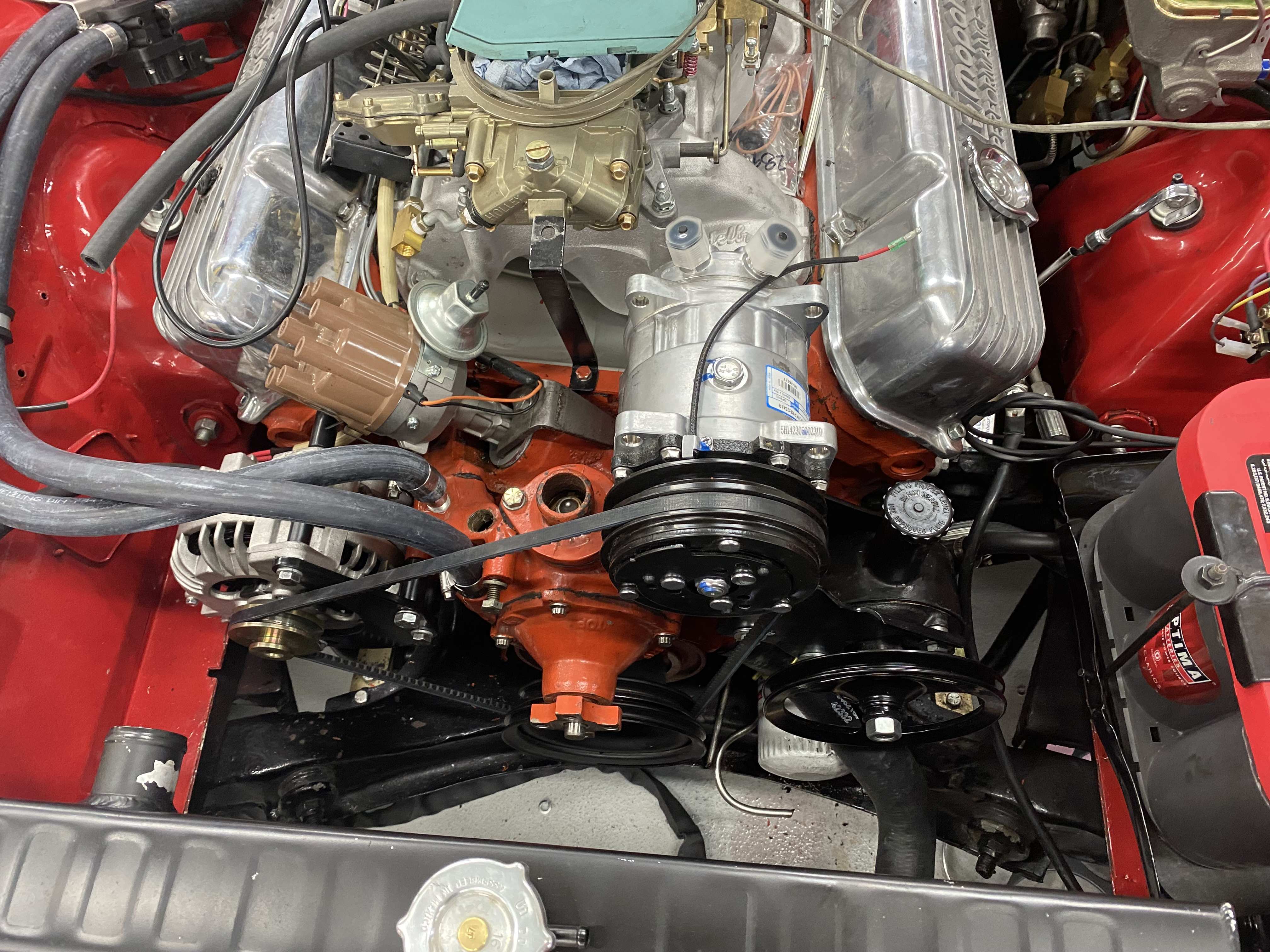

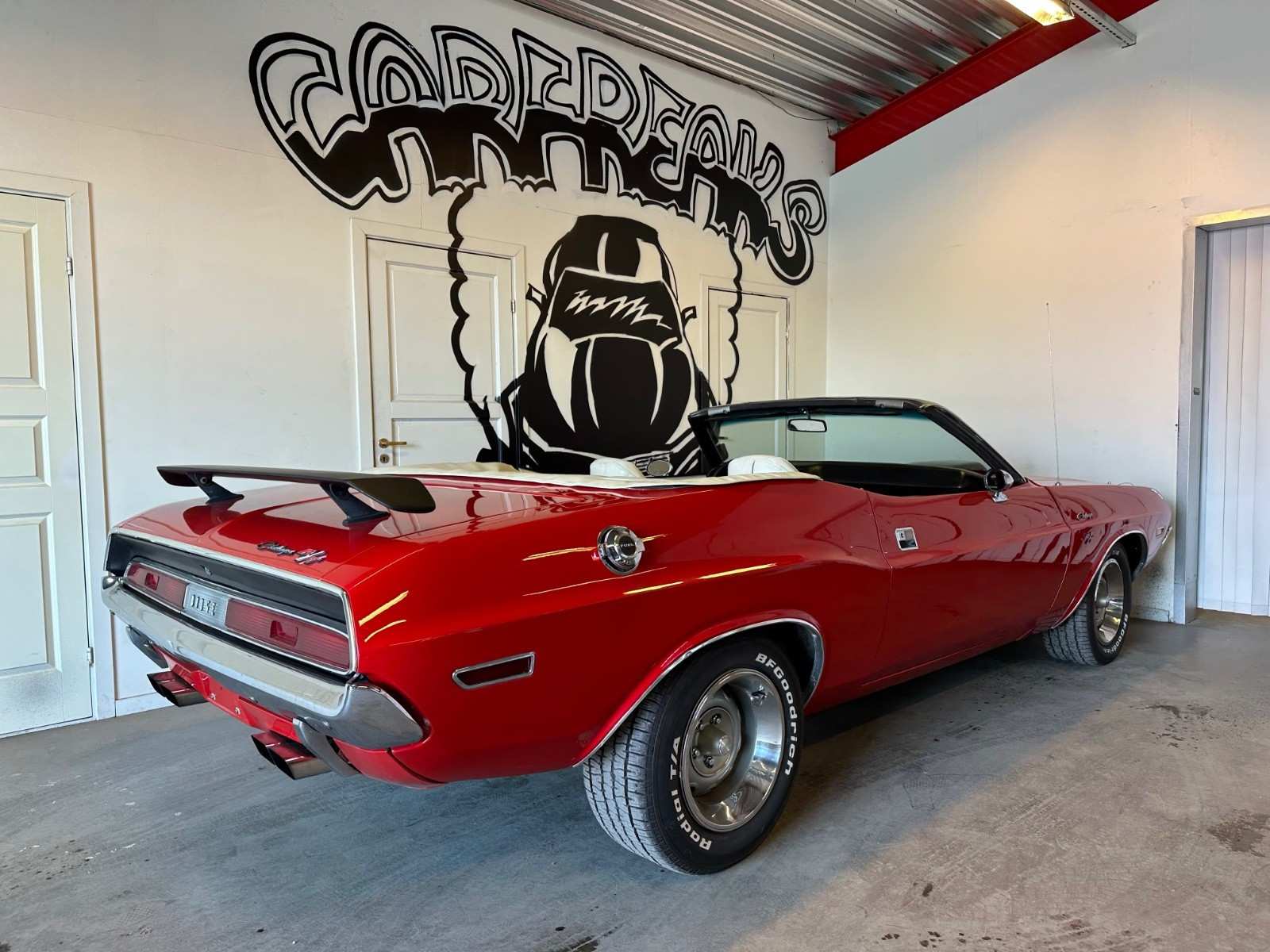

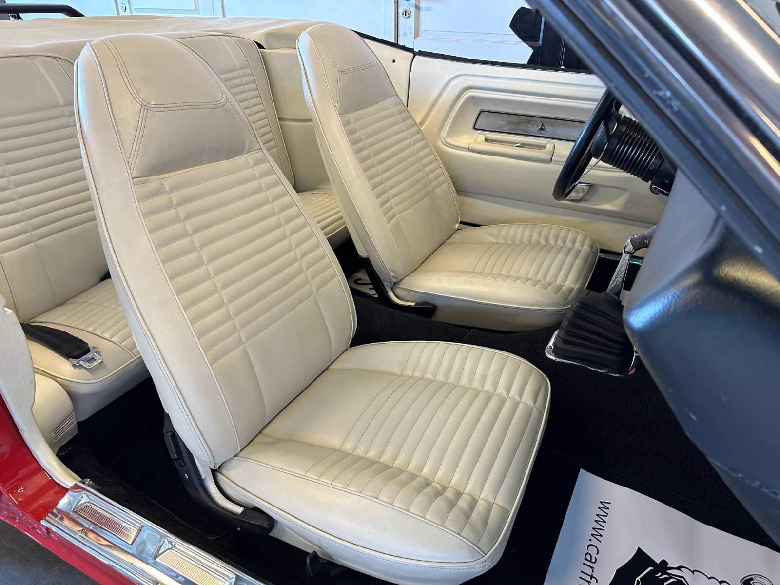

I am working on a 1970 Dodge Challenger convertible with a 440-6 setup. Bought the car in Norway. Changed all wires, all electric parts, 6-pack setup, changed valve covers to originals, installed Vintage Air conditioning, the body and undercarriage is in an excellent condition, in 2 weeks ready for inspection.

Welcome to the site from Arkansas!
I like that a LOT!👍🏻

Welcome to FEBO from the desert! That's a beautiful looking 70 Challenger R/T convertible!

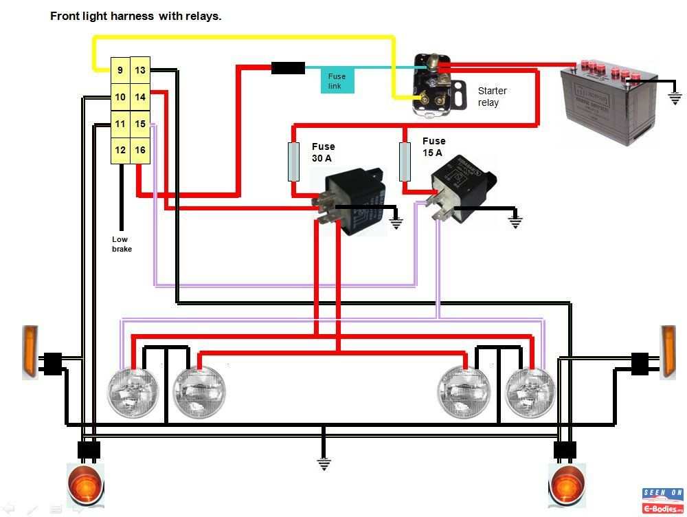

While you are at it I would consider doing a alternator bypass. It should be ok for now. Later forgotten about. Would of should of could of. To late!
leave the original wiring in place.
There will be two feeds to feed load inside. bypass will help distribute the load. Alternator gauge will not work as intended. use a voltage gauge to monitor system.
A headlight relay circuit would remove a load from the wiring harness.

Welcome to the site from Michigan! Great looking Challenger and let us know how the inspection goes.

Really great looking Challenger convertible!:thumbsup:
I sold my Challenger RT SE w a 440 automatic in the early 1980's which was exported to Sweden! Was Rallye Red like your car!
Challengers are very popular in Europe and yours is a beautiful example!
