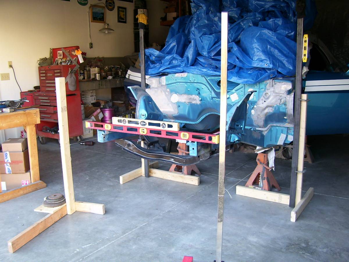

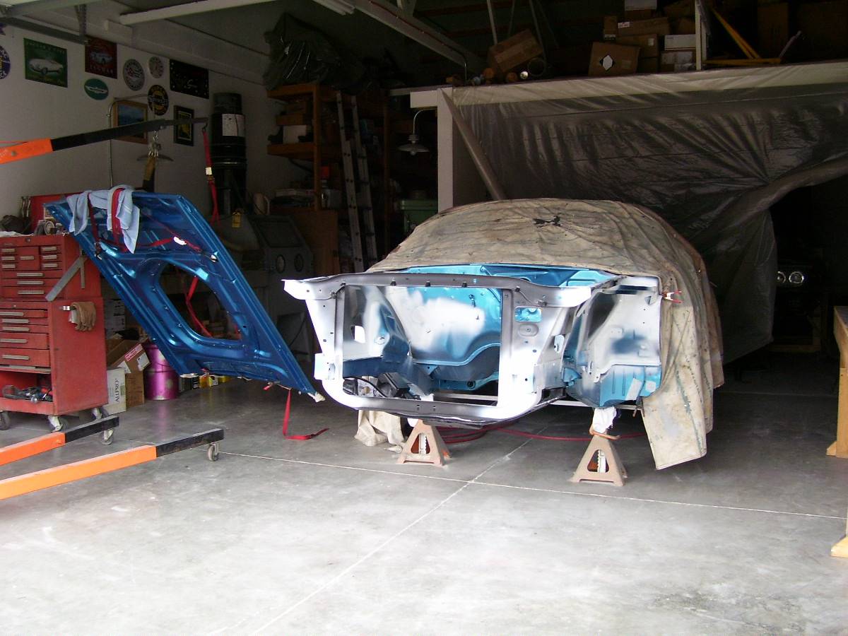

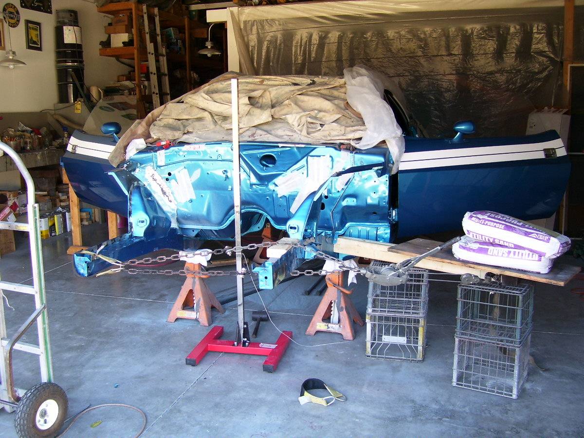

This shows pretty much where I'm at with this car. This is me fixing what a self proclaimed expert did for a good chunk of change. The expert replaced a badly damaged right frame rail and matched the bent left one, no frame jigs there. The entire front end was pointing about 7/8" total to the right. Left door and hood fit were super wacky trying to make that work. This pretty much sums up all of my experiences with outside help on old cars, only huge regrets.

Compared to what I see other guys doing with badly rusted cars, mine is a cake walk. Once I figured out the problem with the rails it actually went quite fast on the repairs. The reproduction AMD inner panels fit great. The thing is the car sat for several years before I got back to it, I put it aside because I knew something serious was behind the fitment trouble so the project was halted. Probably like many of you I'm juggling several big projects at once. This is what you would call a hemi tribute project, a 318 3spd conversion to a traditional hemi 4spd to be specific.
