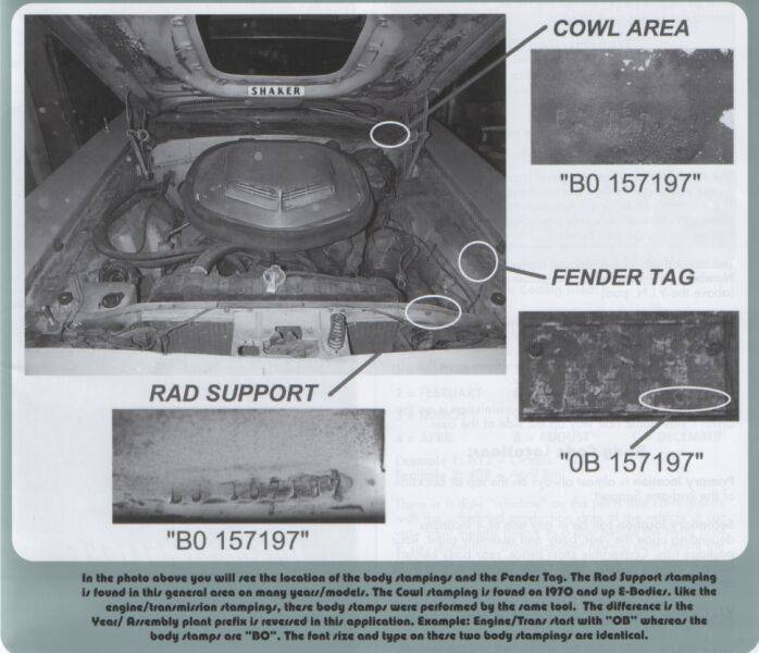

Since you are checking out the car, make sure the numbers match. Here is a pic to help. Number location.jpg

Well all the codes matched, the vin matched in all the spots and it looks really sweet. I got a 24hr look see from my bud, but I think I am keeping it.
