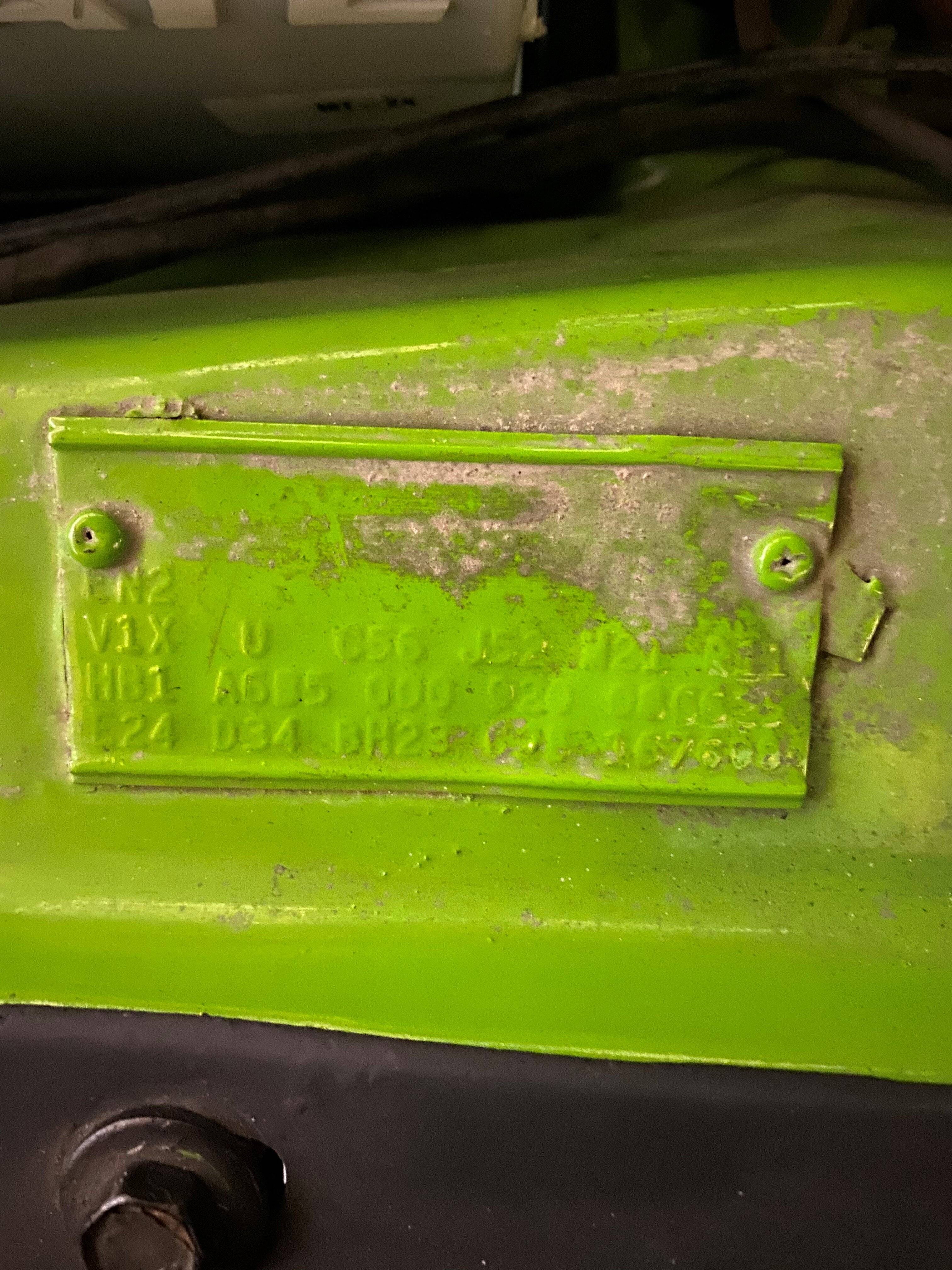

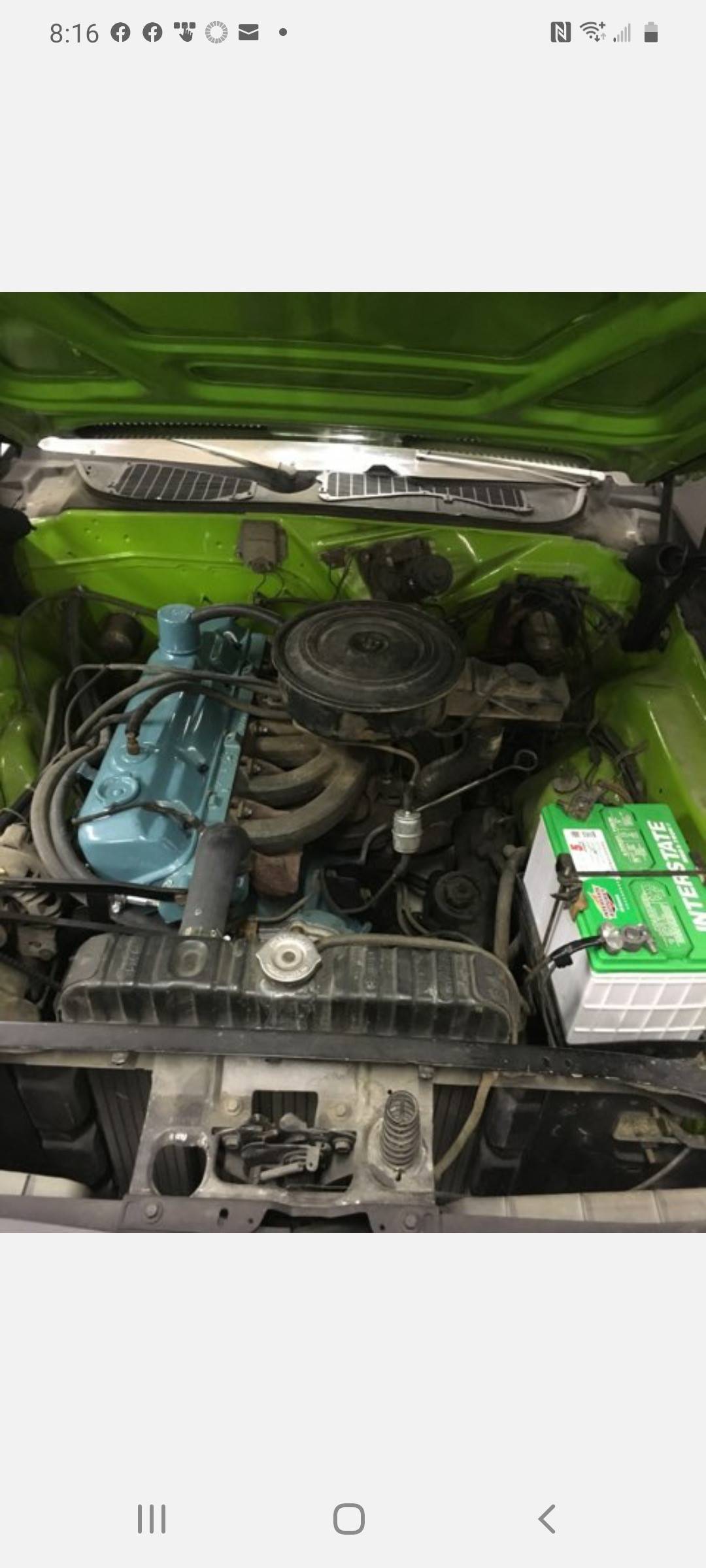

Thanks for the input. Yes, is a BH coded car. Here is a pic of the engine and the fender tag. Unfortunately, the fender tag was painted and hard to read some codes. If you can decider, please let me know. The car was originally blue and I think had a vinyl top, so not fully original anymore.
car also has a 489 rear. Would that have been standard on a slant 6?
also, heard that Schumacher makes adapter plates so you don’t need to change the k member, but can’t see that they go from slant 6 to big block, only short block to big block. Anyone know any different?

Looking at the tag; interesting Barracuda. Early build car September 20th.? (hard to read) The HB1 code is a very light blue that you do not see too often, along with a blue interior. Car did have a vinyl roof in black. Interesting that the car was coded for an inside hood release.
Picture I think I found for the HB1 code. There appears to still be one of the assembly line inspection tags still on the car (right side top screw) under the tag.
