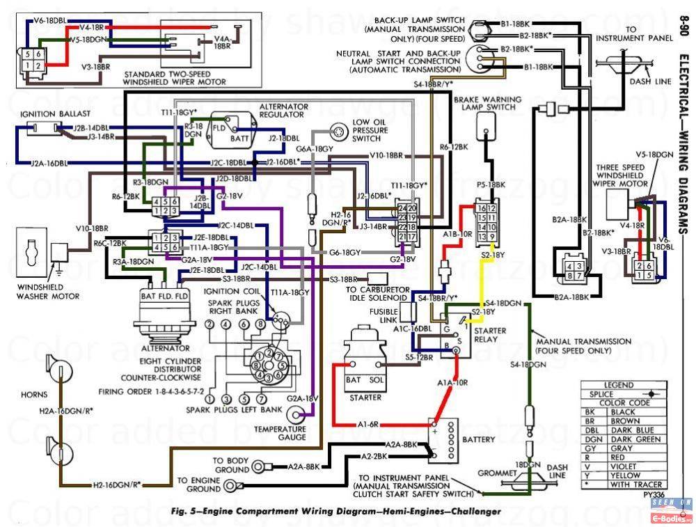

I sold my 2018 Demon and last week bought a 1970 Challenger R/T 440 Six Pack, 4 speed, Super Track Pack car. Car has all original body panels and is painted Hemi Orange with the Broadcast Sheet. Only issue is that the starter clicks and it wont crank. But it looks good sitting in the garage! This is my first Mopar so I'm sure ill have a bunch of questions to get the forums help with.

Here is a wiring diagram to become familiar with,it's easiest to understand to start. It's for hemi same for the most part.
